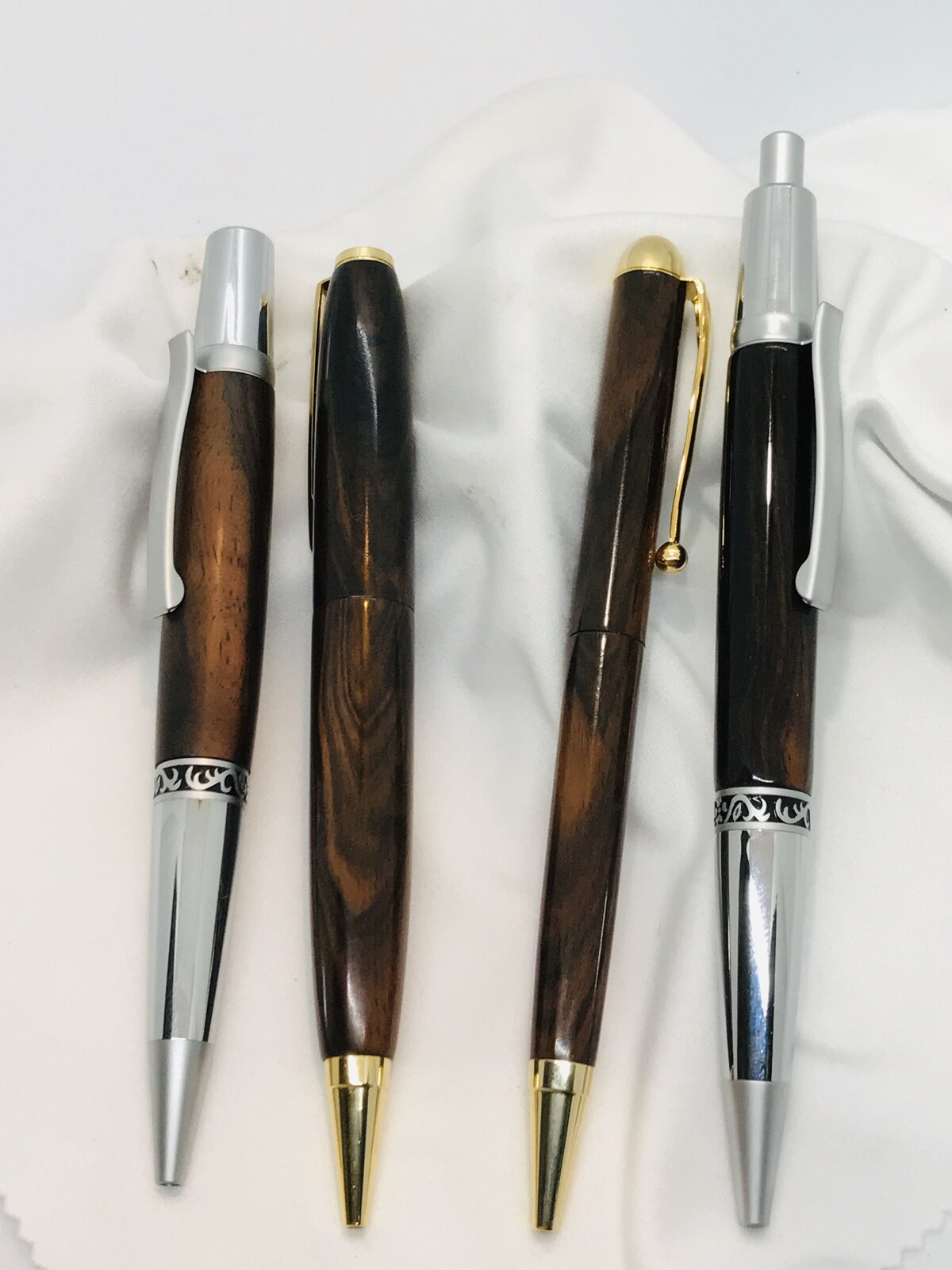

As I stated in an earlier thread, Requesting Assistance 8/31/2020, I have a rather large chunk of Macassar Ebony, also known as Striped Ebony and Amara Ebony. The heartwood generally has a very dramatic and appealing striped appearance. It is oily AND dulls cutter blades faster than you can say "Bubba loves trucks."
I have included some photos of 4 pens I just completed using this Macassar Ebony. Please note, being a dark wood - it is ebony - it is rather difficult for me to photograph in such a way as to capture the figure and color of the wood.
Photo 1 shows all 4 pens. The first - on the far left - is an Elegant Sierra - chrome and satin chrome - and there is only a wax finish on the wood. The wood on all 4 pens was sanded thru 1000 mesh paper, followed by sanding with the grain, off the lathe from 3600 thru 12000 MM. The first pen then received 2 coats of Ren Wax, on the lathe at ~1700rpm, buffed following each coat.

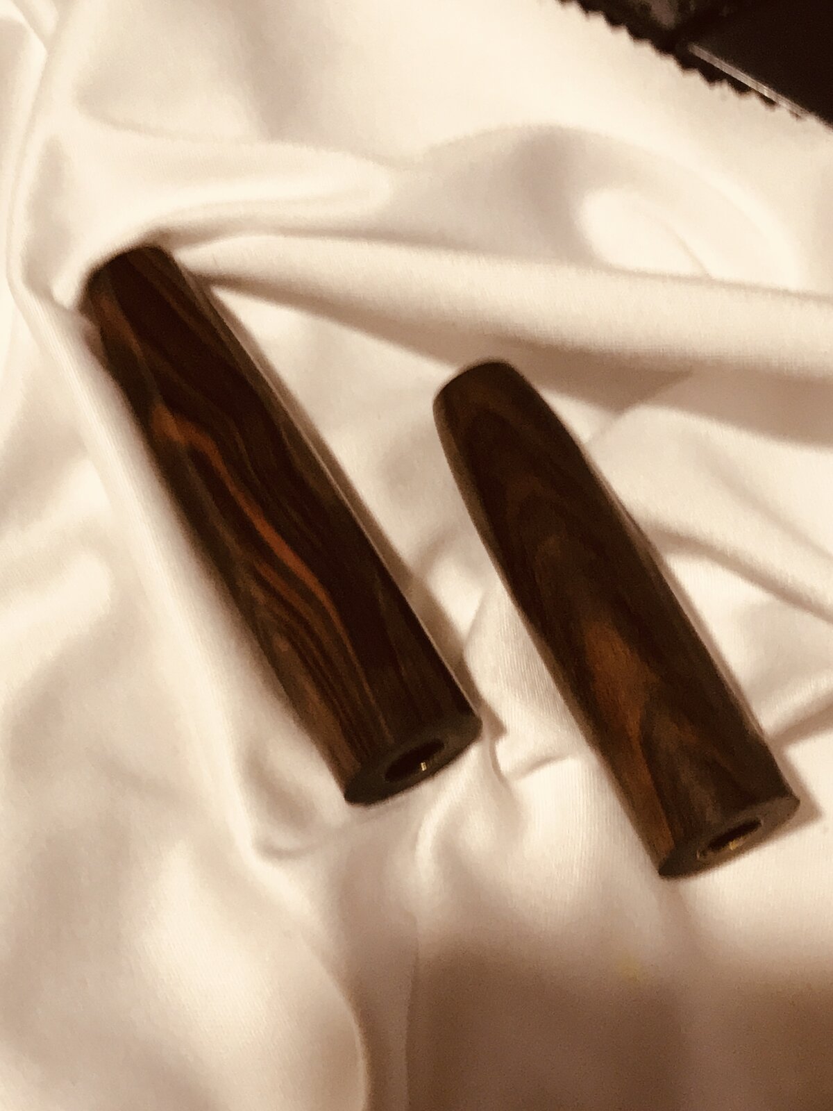

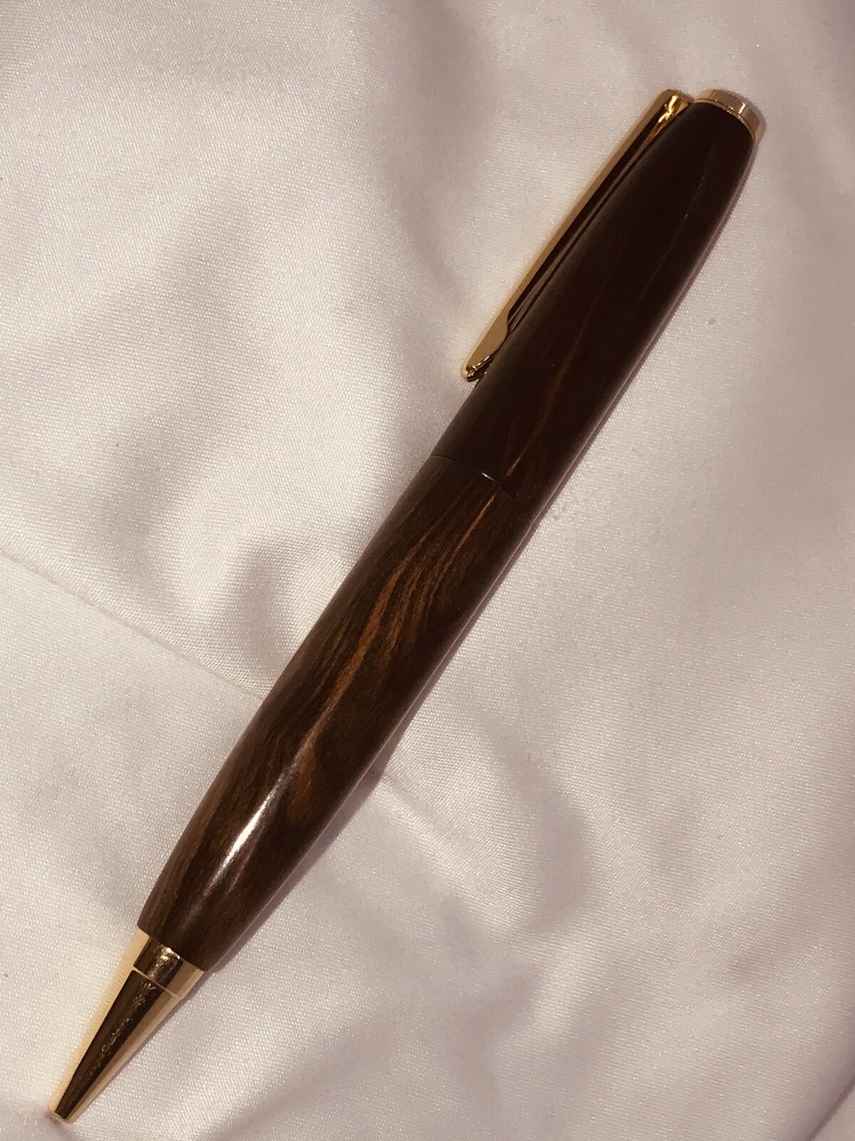

The second from the left in photo 1 is a free-style (what I call my DefensiveLine, as opposed to a Streamline) and is made from the wood shown in photo 4. Follow sanding, this pen received 3 coats of PensPlus, on the lathe, followed by 2 coats of Ren Wax. Photo 3 is another view of the DL pen, attempting to capture more the figure and color of the wood. Photo 4 shows the sanded blanks for the DL pen prior to finishing.

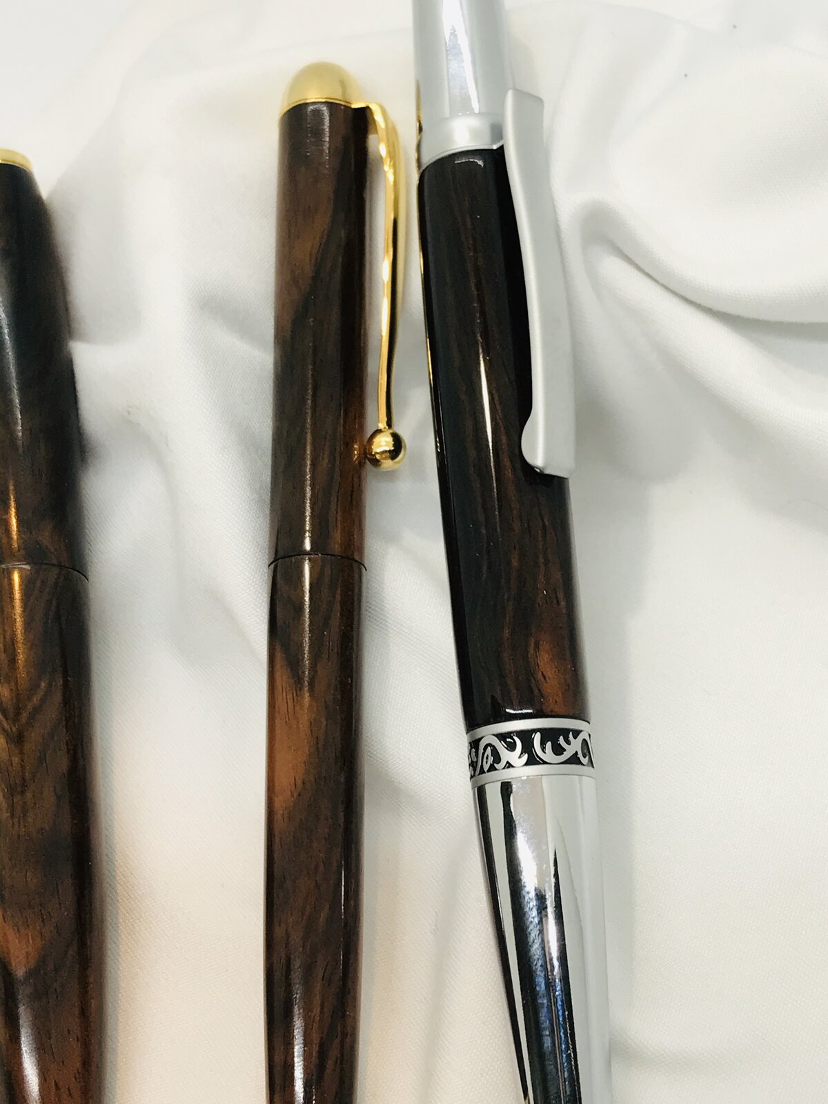

The second photo attempts to show some more of the grain in pens 1 and 2.

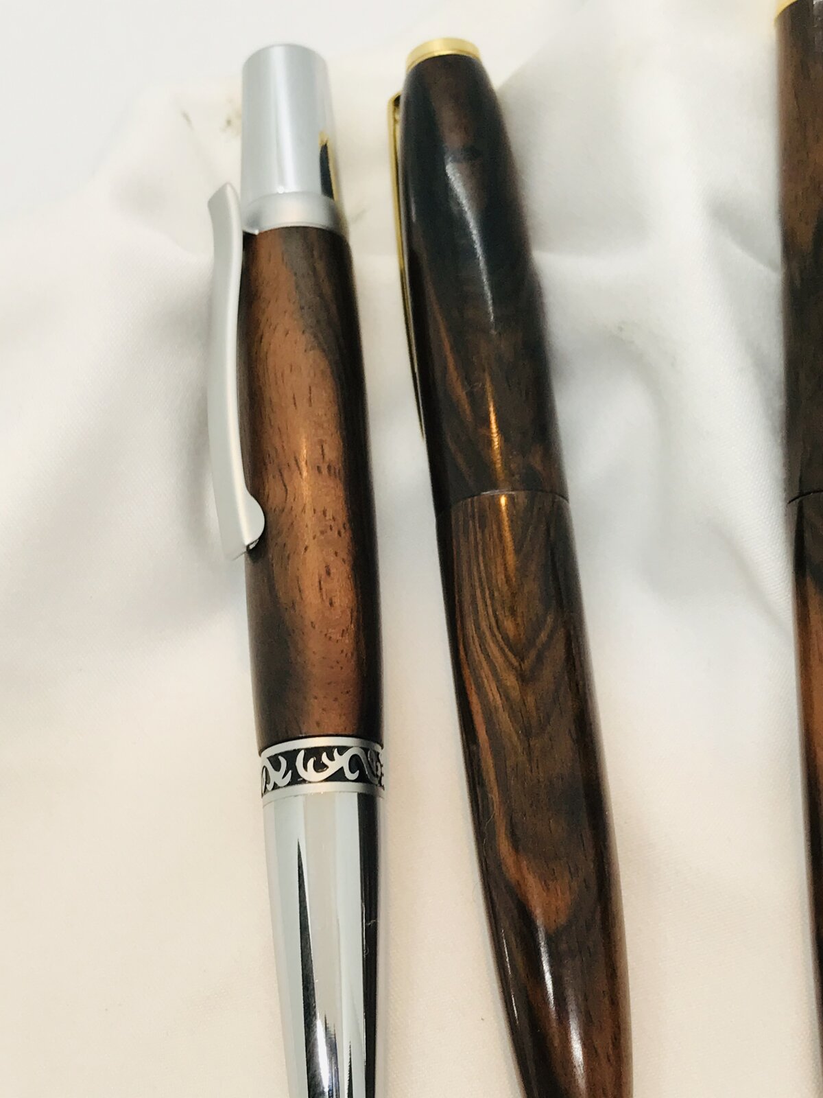

Photo 5 is a closer shot of a StreamLind RoundTop 7mm, without the center band and an Elegant Sierra Button Click. The Round Top was finished just like it's bigger brother, the DL, with 3 coats of PensPlus. The Button Click was finished with CA. Since Macassar Ebony is oily, after sanding off the lathe, with the grain, with the last MM, I mounted the blank on the lathe, spun it up to ~1700 rpm and wiped the blank thoroughly with denatured alcohol until there was no color being left on the rag, After the pen dried I applied a very thin coat of thin CA and let the blank sit overnight. The next day I applied CA, 2 coats of thin, followed by 10 coats of medium. After drying, I removed the blank from the lathe and hand dry sanded again, with the grain, using all 9 of the MM pads. Finally the blank was remounted on the lathe and 2 coats of Ren Wax was applied.

Yes. My original thread voiced my concern about using CA on such an oily wood. In that thread(?) several folks allowed that surface cleaning with a polar solvent like acetone allowed them to go ahead with CA. I don' keep acetone in the shop, but do keep a slightly less polar solvent, denatured alcohol. So did applied denatured alcohol until there was no more sign of oil coming off then applied a light coat of thin, porous CA. Checked it the next day and everything looked fine. Then proceeded to finish with normal CA process.
