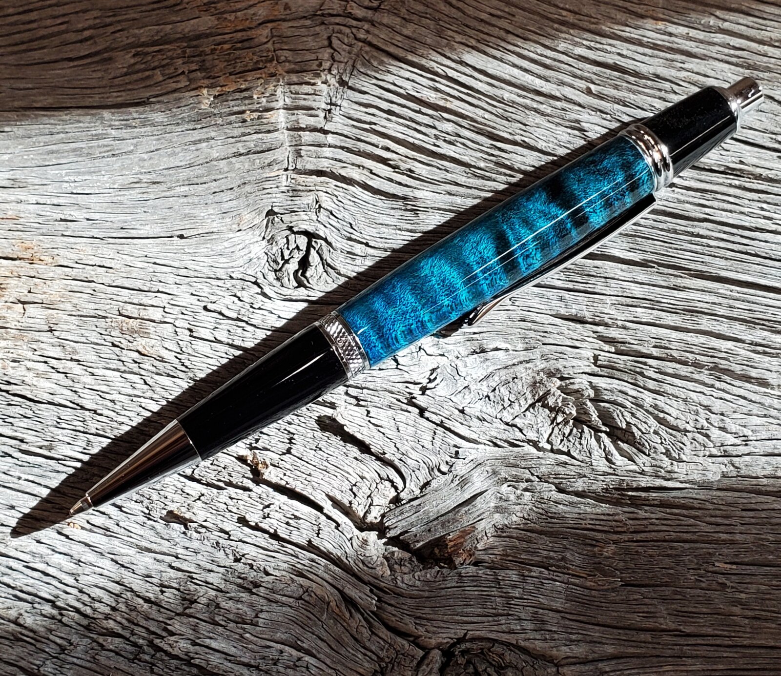

A while back I got a lathe, but never got it out of the box for a variety of reasons (I have two kids under 4...) I always had it in mind to start turning pens as it always seemed like a really interesting/satisfying way to kill time, and a pause in busy work-life and the kids finally getting back to daycare left me with a bit of free time and a renewed optimism for a new hobby. So I got a starter kit from a local supplier for myself for christmas, built a stand for the lathe and finally got it out of the box, and in january turned my first items ever, a set of five slimlines! Pretty fun!

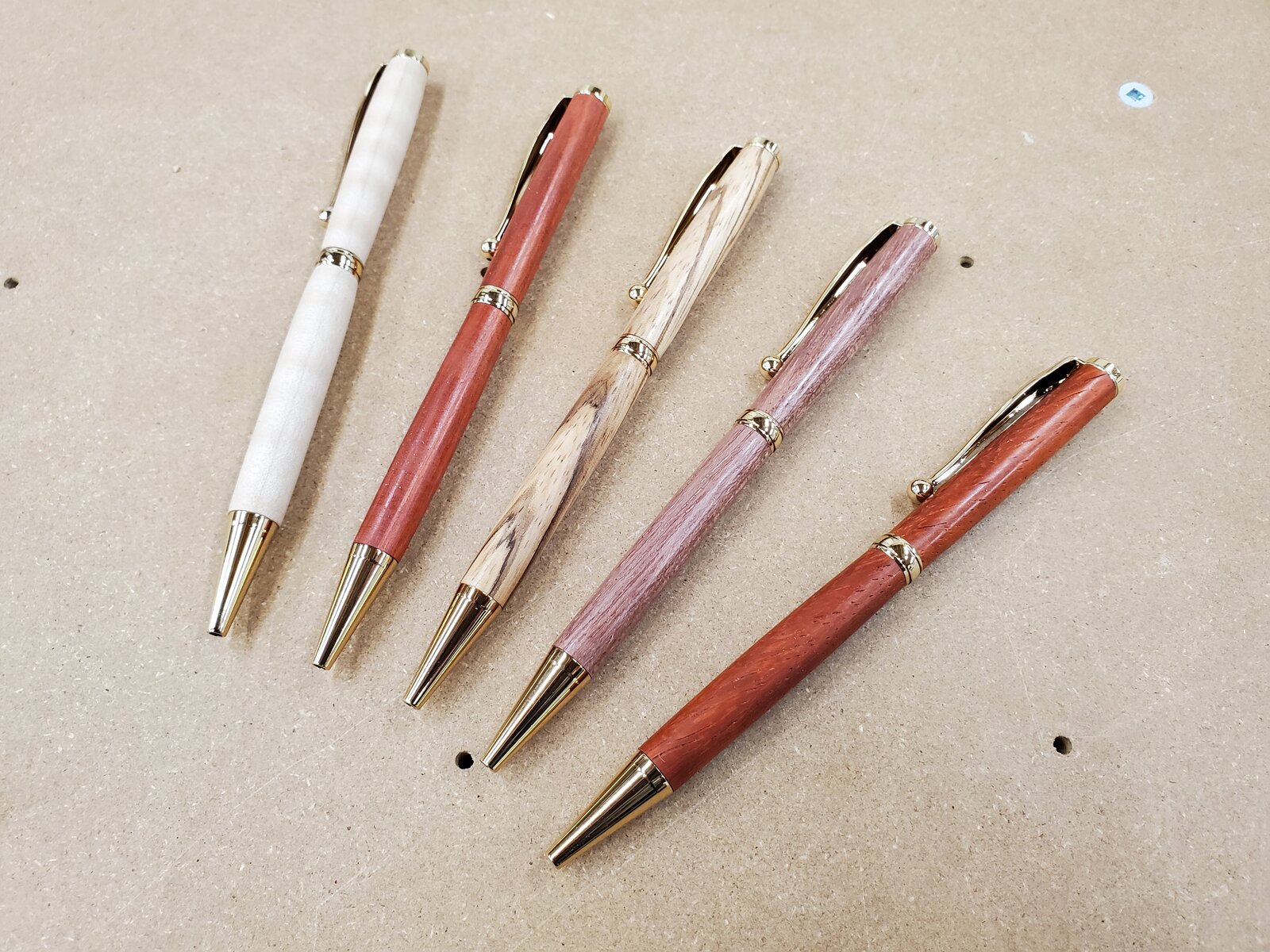

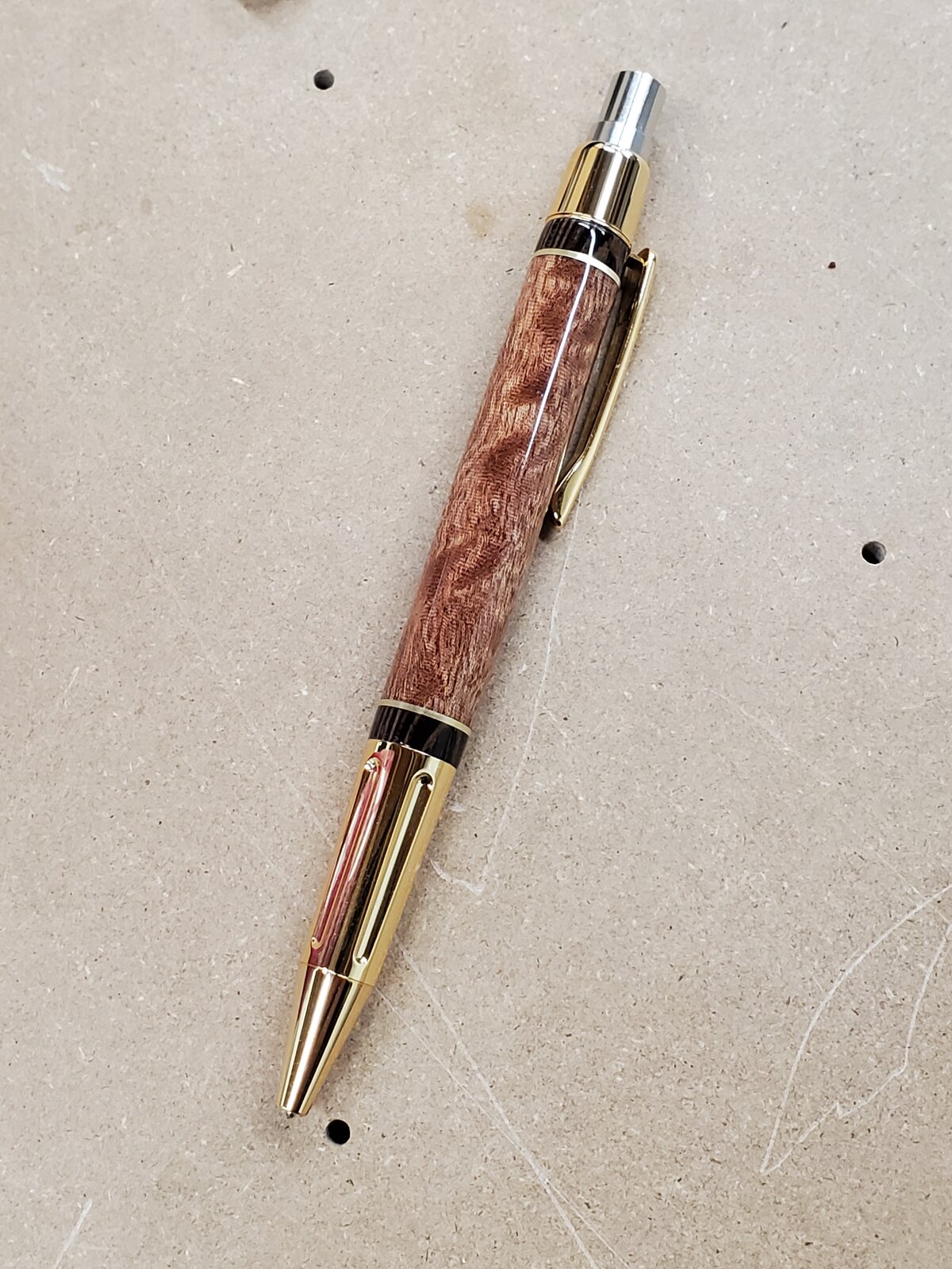

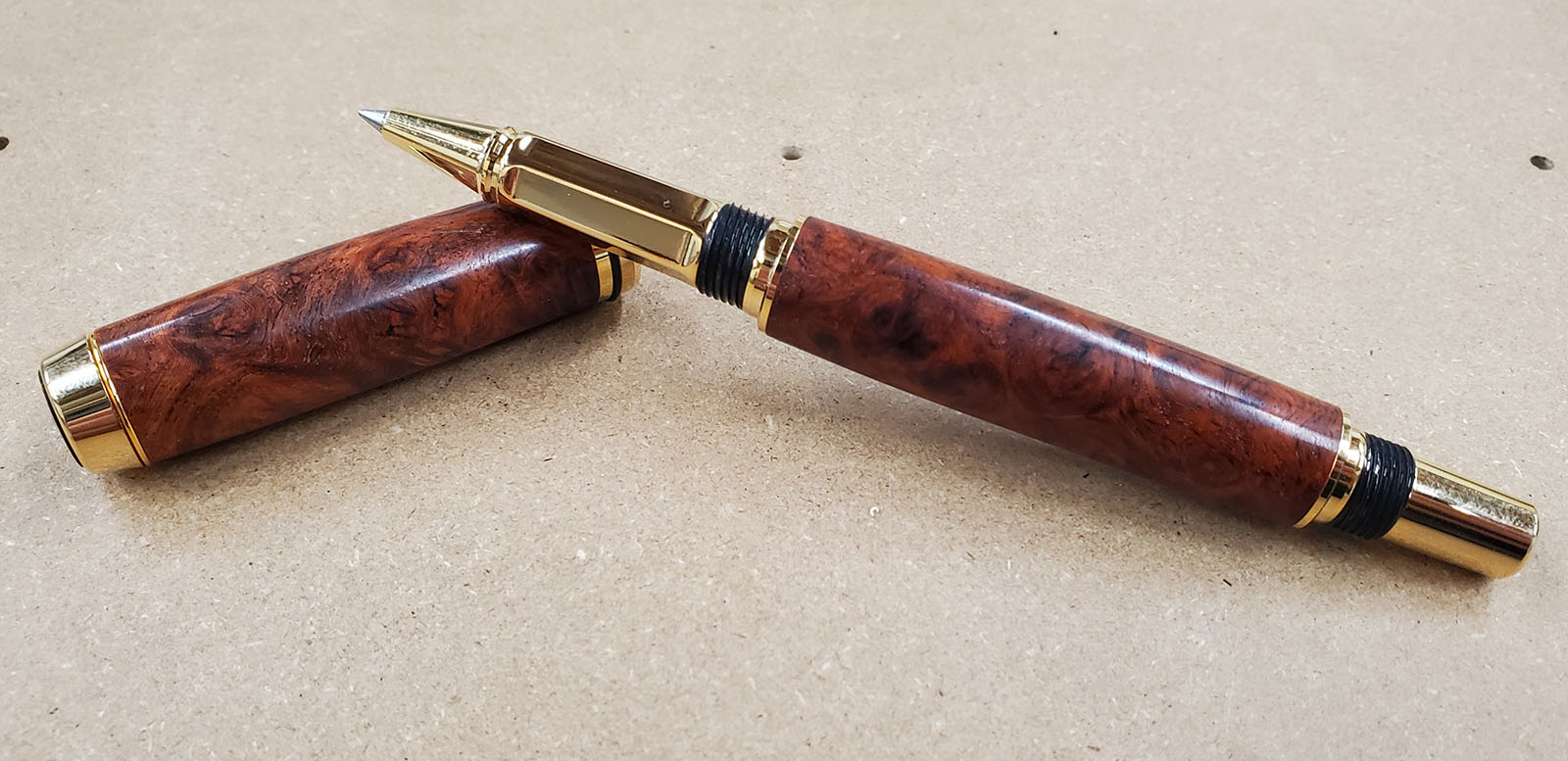

I then got 5-Burl combo pack and started turning Baron kits, and made a couple bland beginner ones and a nice stabilized amboyna burl one at the end of january that I gave to a family friend. Looking at it now I wish I could swap it for a better one but oh well!

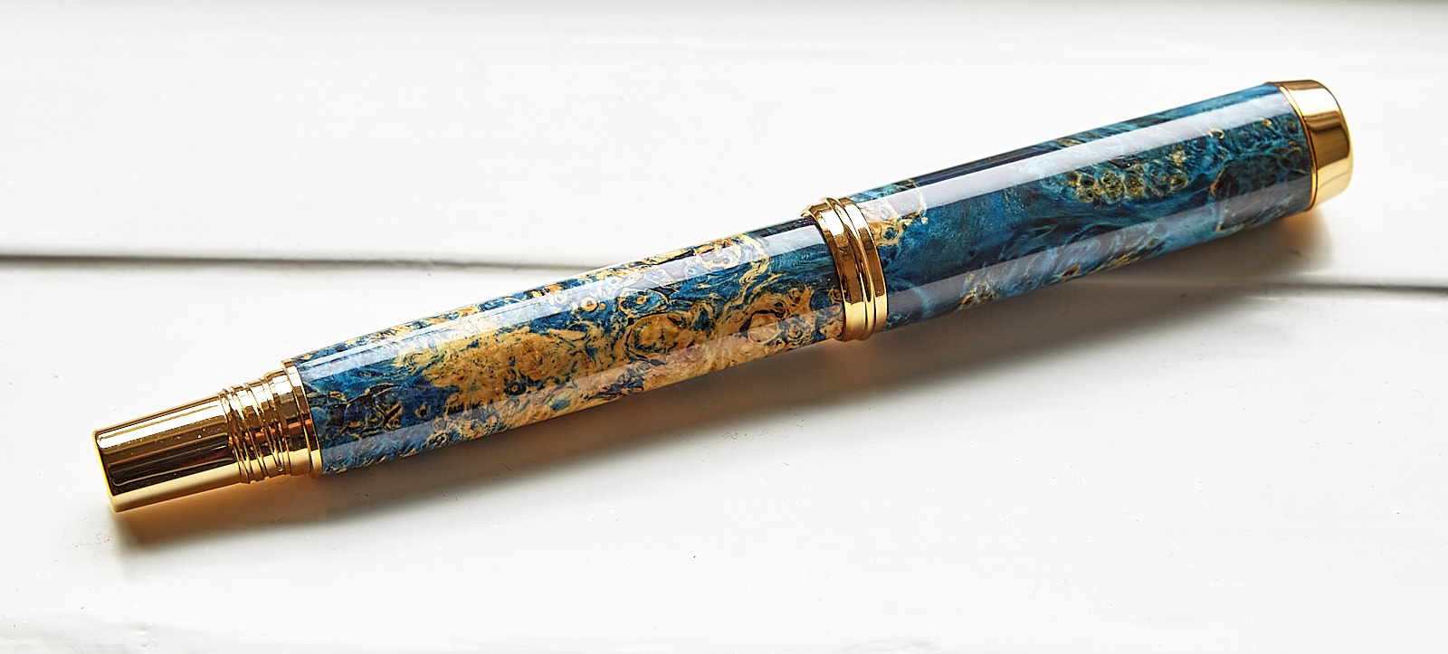

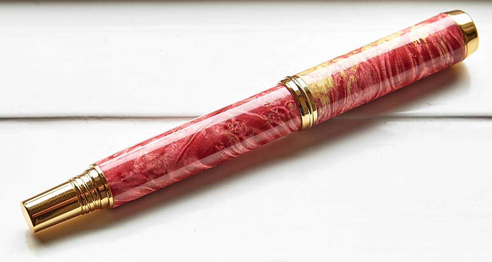

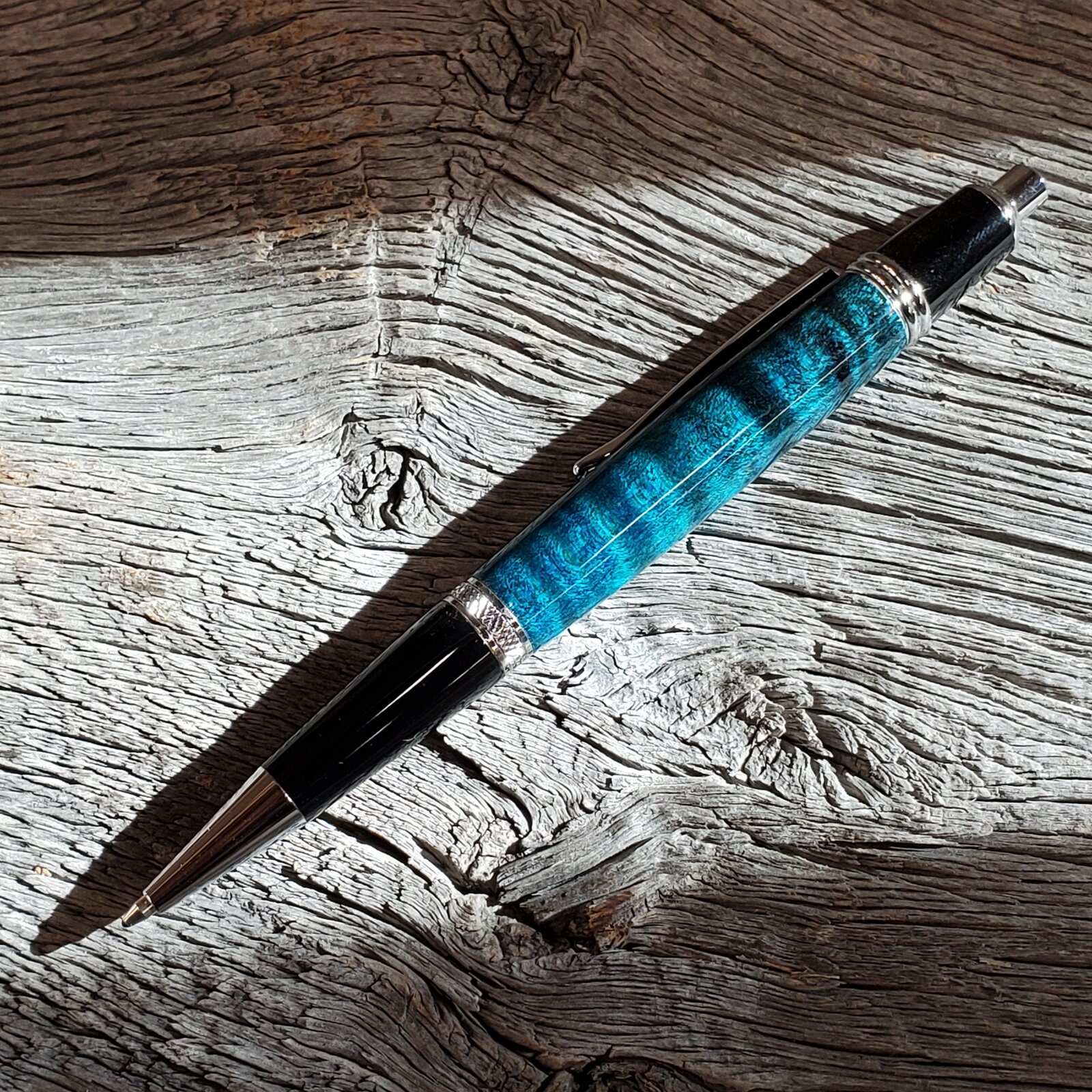

Then I thought it might be fun to try some dye stabilized box elder burl, and got a starter Starbond CA finish kit and some algonquin pens...

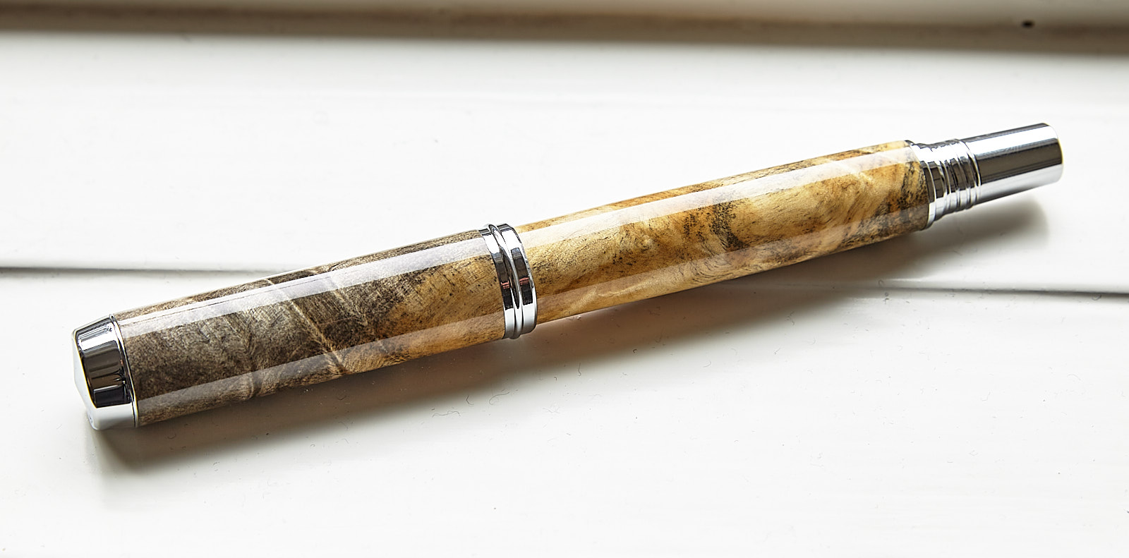

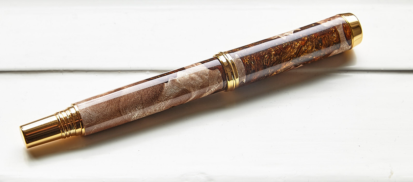

Then I thought it might be fun to try Buckeye Burl... it's really simple but I love the dimensionality and natural color in the wood!

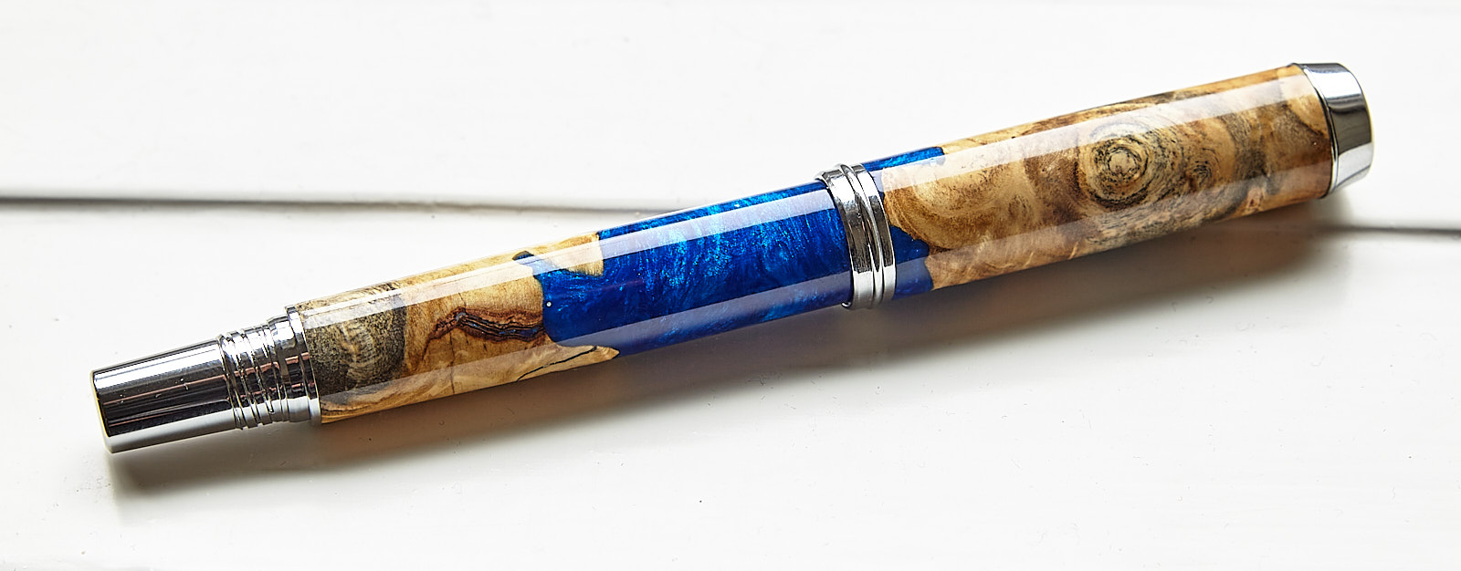

Then I thought I would try some hybrid/fusion blanks, which was REALLY neat!

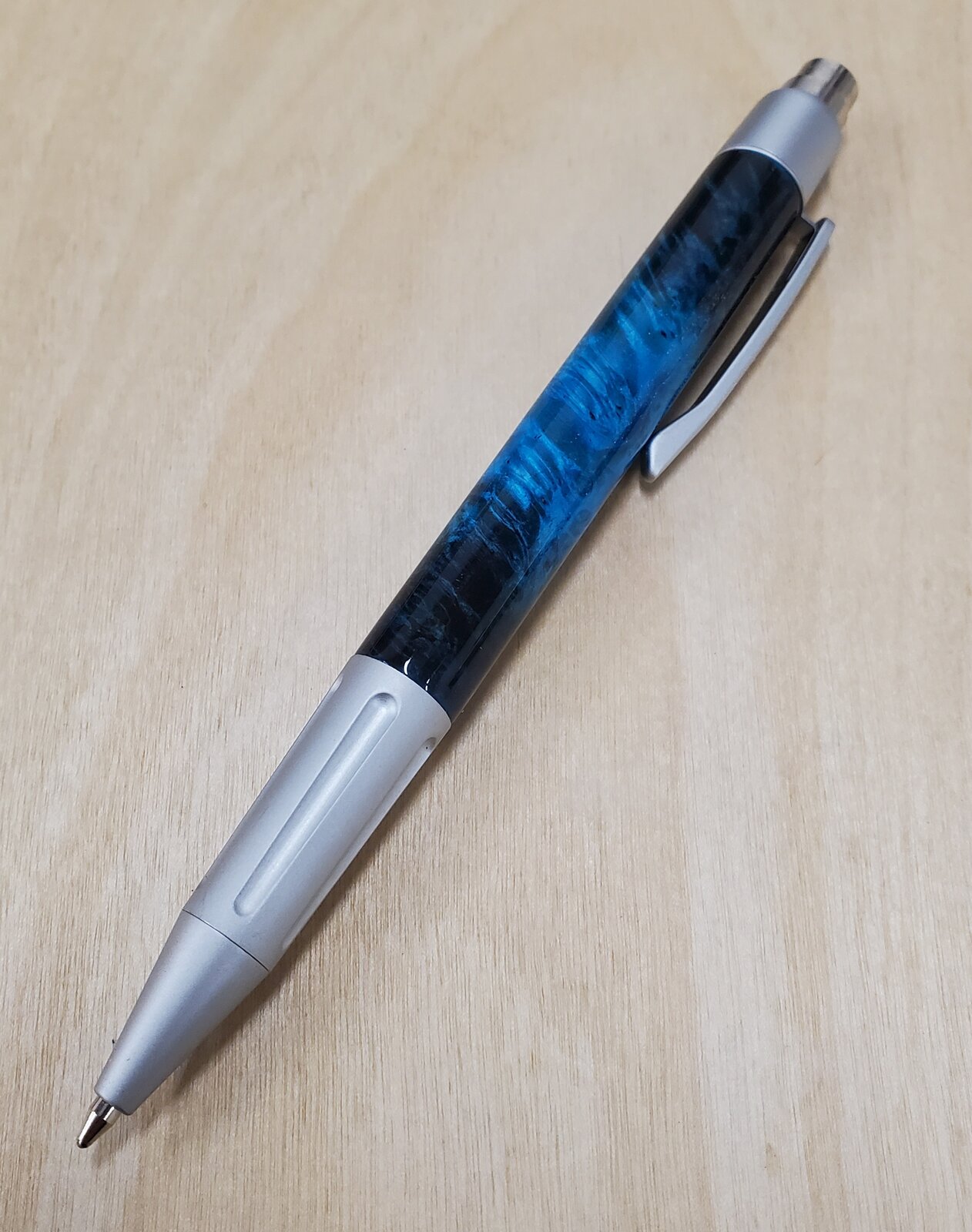

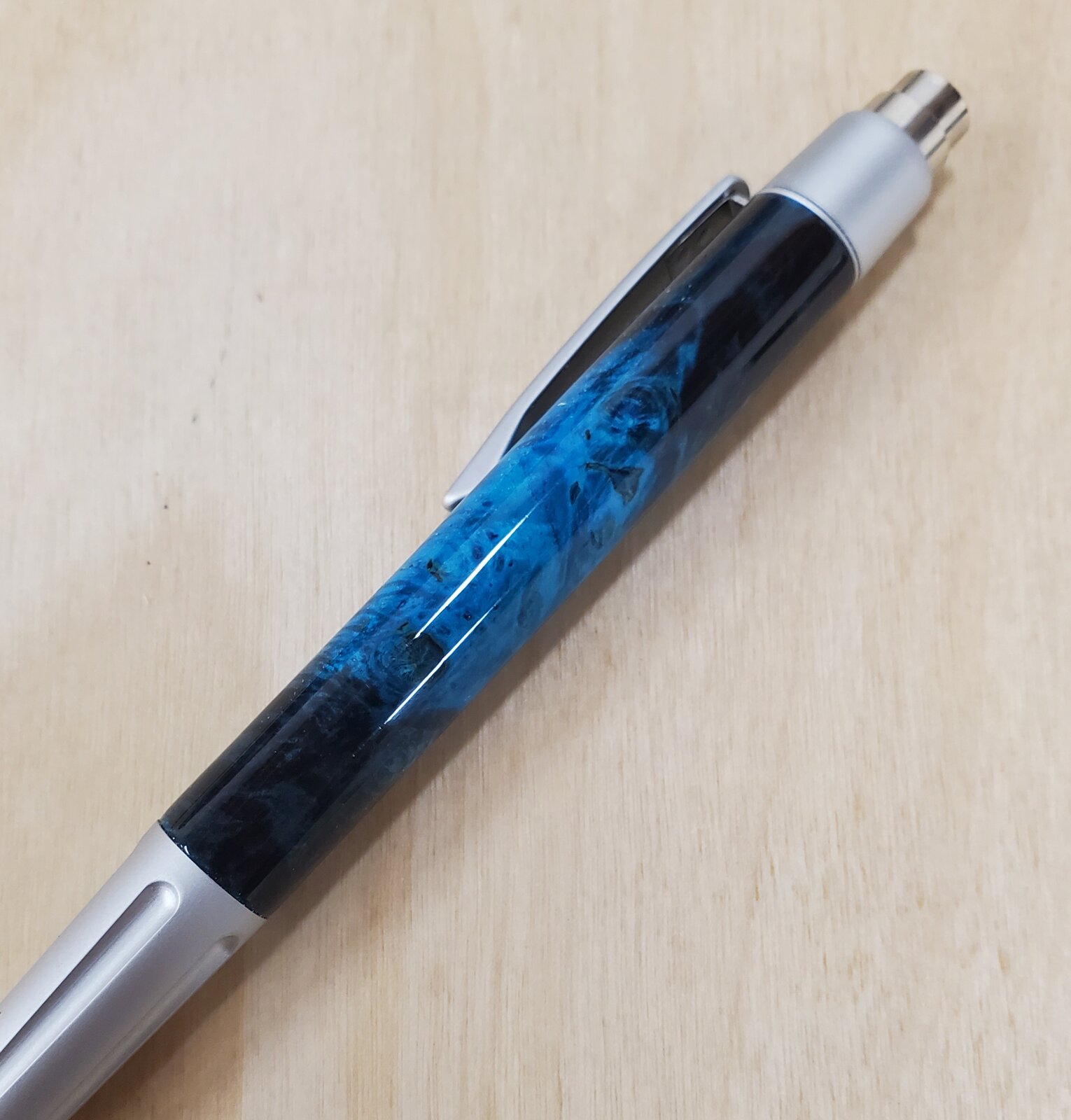

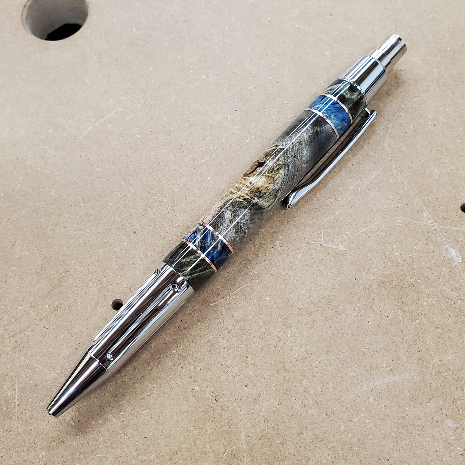

Then I got some Luxor kits (my wife really wants a click pen), and after turning a companion buckeye pen to the one above I had ALMOST enough blank for a second pen, but not quite enough. I had already started squirreling away a bunch of offcuts from other pens I had turned, so it seemed simple enough to glue some together. I wanted to break it up a bit and didn't have any ebony, but i did have a copper sheet that has been sitting in my architecture school supplies for ~15 years that I never found a use for. So I used it as a spacer for the colored burl bits, and cranked out the following... I also upgraded my CA finish setup to gluboost and I'm pretty floored with the results it gives!
That's black-dyed box elder burl, electric blue double-dyed box elder burl (leftover from the algonquin above). I'll be giving that one to my dad as a belated birthday gift!
So that's it - a fairly busy and productive first 8 weeks! It's definitely a lot of fun, and contrary to the time it takes to do larger woodworking projects I really love how quickly I can have an idea and see the results - so far I do glue-up on day one, and turn them on day two, and it's only an hour or two total. Pretty great! I've ordered some resin blanks as I really like the accent band look, and would love to hear if anyone has any recommendations about what I should try next!

The copper spacers and the added blue color make that an exceptionally attractive pen!
thanks! I definitely lucked out on that... it was actually inspired, in a roundabout way, by a duck called the blue-wing teal. long story short: I'm the same age my dad was when he won his first major wildlife sculpture award (he does duck/bird/fish/wildlife carving). he won with a blue-winged teal, which is a grey/black/yellow-ish bird with a little teal bit poking out under its wing. i was trying to come up with something to give him belatedly for his birthday, and had settled on a buckeye Algonquin but realized I could probably do a bit better. the stars seemed to align just right, as the color scheme/theme is a really good match. He doesn't even know I'm turning pens so I'm hoping it'll be a neat surprise!

I was unhappy with how plain this natural stabilized maple burl was so I got out my aniline dyes, attempting to mimic a sunburst-style finish that is used on electric guitar bodies. I did some additional experiments with curly maple but it didn't have enough figure, so I'll be playing around again tonight with some fiddleback blanks! I think there's too much black - essentially i used ebony black on the ends, electric blue in the middle and overlaid a couple layers of black CA on the ends. In daylight it's actually pretty incredible, if feels like you're peering into a little underwater world!
For those curious these are the Luxor pen kit from William Wood-Write in Canada. I realized that one of the things that makes me lukewarm about it is the lack of bands like the sierra has, so I busted out some brass stock and made some out of wenge for this sapele pen. I really screwed up the finish on this one (the brass was shiny like the copper one above, but due to me experimenting with how to use CA to fill the open grain of the wenge, i was kind of all over the place with sandpaper grits and layers of CA)... but I think to approach worked and is a nice variant on my first banding experiment. I'll probably disassemble this one and either redo the finish or put it into the experiments drawer!
