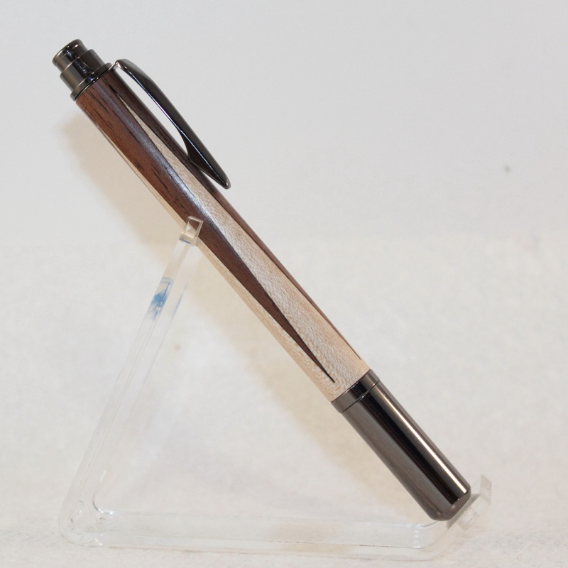

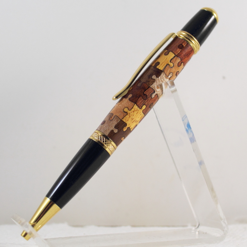

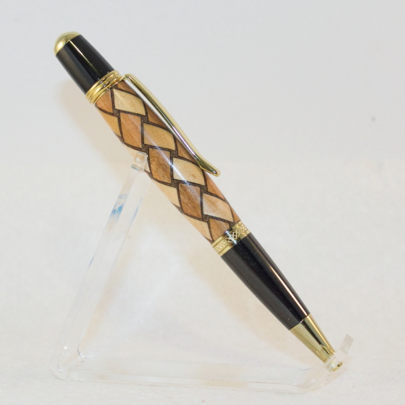

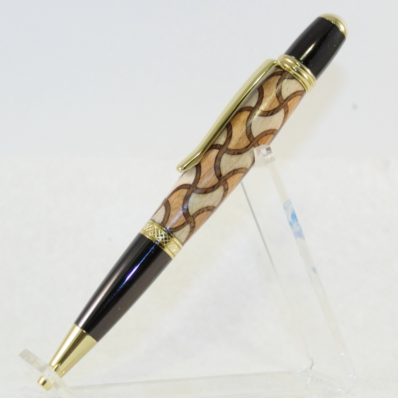

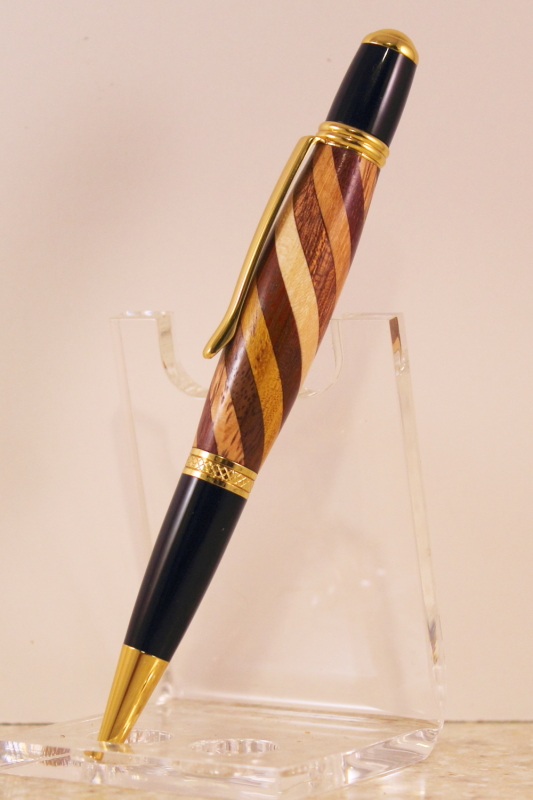

I'm basically a pen blank maker these days. I utilize a 60 watt Epilog Helix Laser with a custom built mandrel style rotary in the making of my pen blanks. Here is a small sample of some of my work.

Ken , I didn't Expect to see them so Soon, But I am Delighted.
Your Blanks are Outstanding, Especially the Woven, or Plaited One, They are All Something Else.

These are all great! Seriously shows off your blank making skills!
What kit is the last one, I don't recognize it, but I like it.

It is a Rollester kit from PSI.
