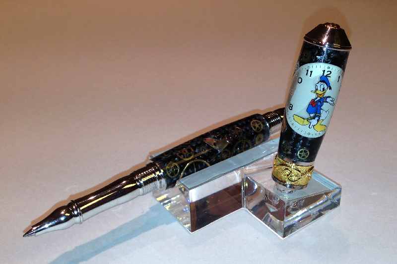

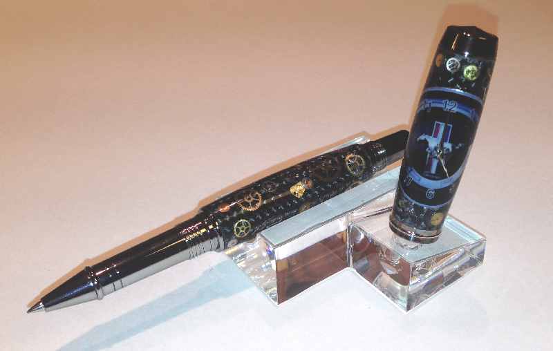

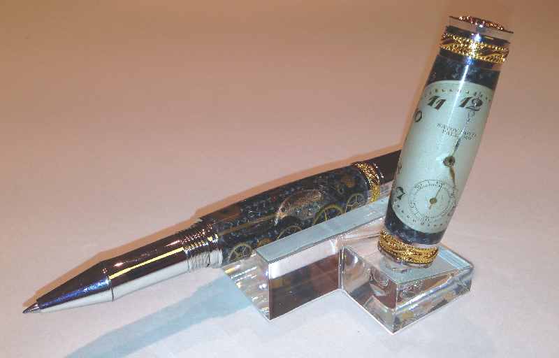

Here are some of my latest watch parts pens. These are some of the first ones that I used carbon fiber on and this is also my first pour using Alumilite. I know the pictures are bad, but I didn't feel like getting out all the photo equipment tonight and just used my cell phone and a piece of cardboard.
I know the pictures don't show it very well but around some of the pieces the CA that I used to glue the parts on show up a lot. I did a pen a week ago with carbon fiber and the CA did not show at all, but I used epoxy. I still have some Alumilite to use up but I may only use it on colored blanks and not watch pen parts.
Let me know what you think of the pens, but not my photo skills on this one.
Mike

So I would love to hear how your casting went, using the alumilite and the "tube-on" style casting. Those pens look great too by the way

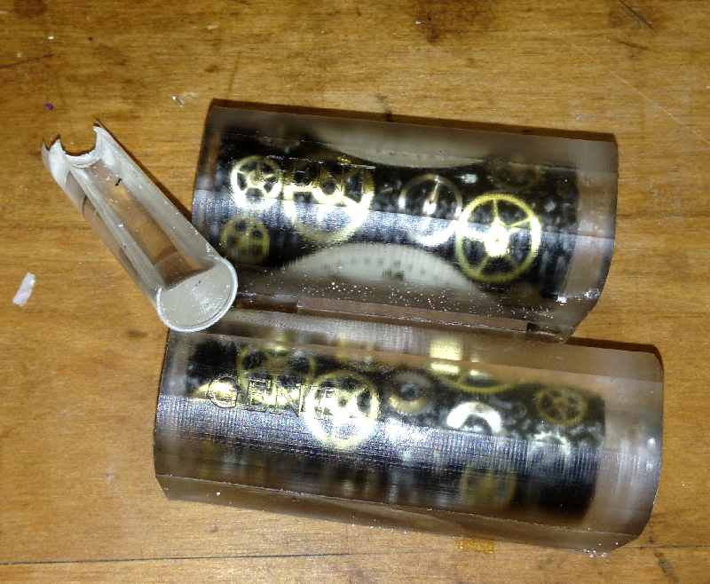

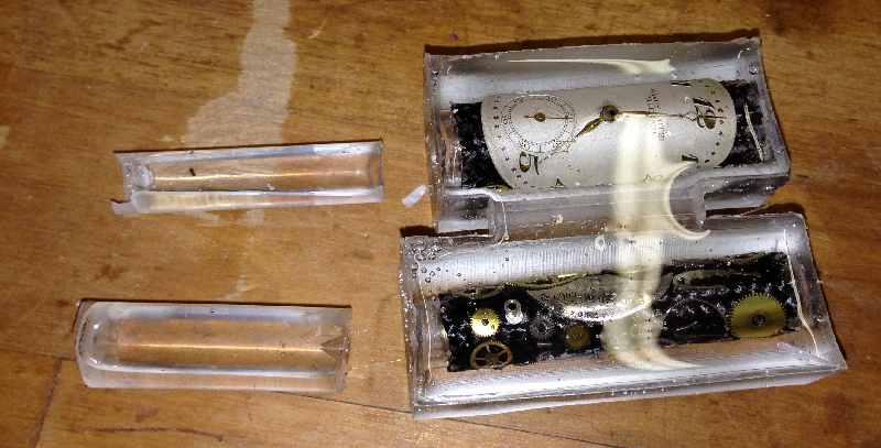

The pour went pretty good, un-eventfull until I de-molded them. 5 out of the 6 tubes had leaked. I thought that I had lost them all, and decided to try and drill the tubes out. As soon as I put some pressure on the plug it popped out, it did that on all 5. The one think that I notice was around some of the parts the CA that I use to glue them on looks like it "cracked". I have not seen that when I used epoxy. But I did use a different CA this time and I am pretty sure it was old. I will try my regular CA (Satellite City) again before I give up on using Alumilite for this application. I liked the way the Alumilite turned pretty easy to cut and polish.

Great pens Mike
Terrific Fit and Finish.
Would love to see them with the caps on.
Brian. "
I'll see if I can get some better pictures tonight.
