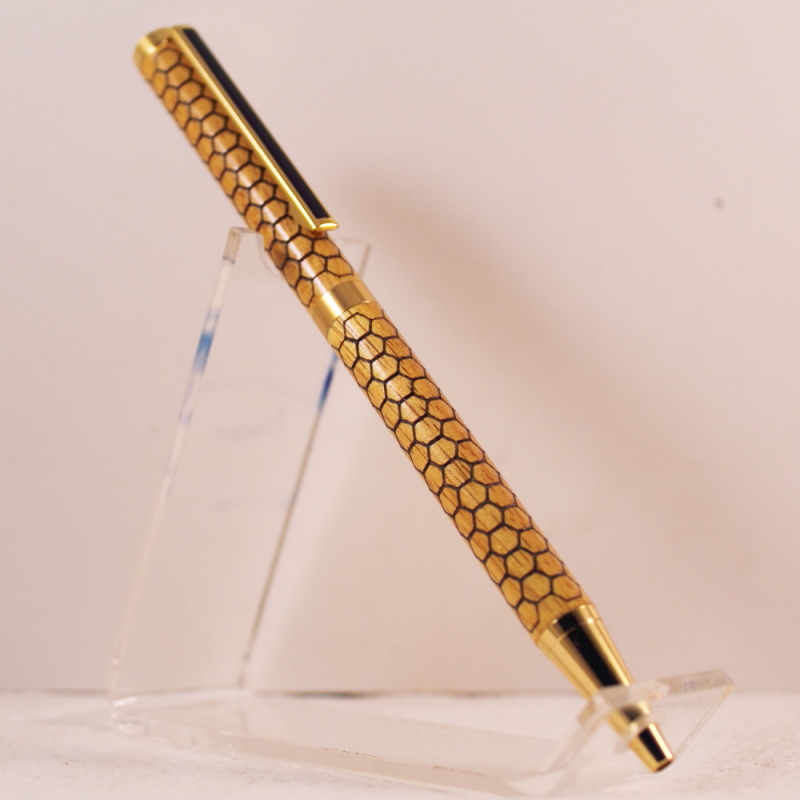

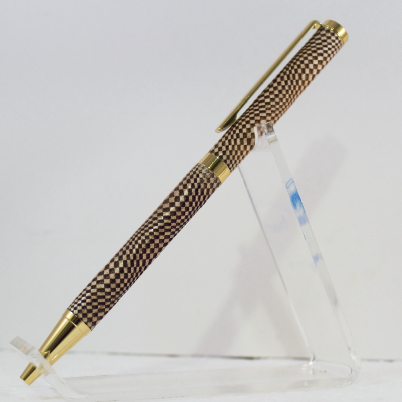

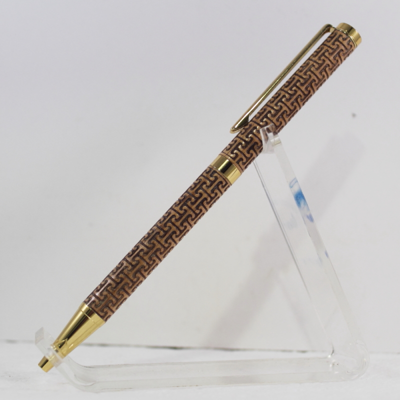

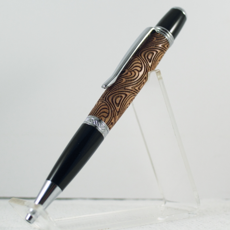

I use an Epilog Helix laser engraver. Those of you that are familiar with that series of engrave know that the stock rotary from Epilog has much to be desired. That being said... I built a mandrel based rotary for my Helix. Not only is a very precise at cutting inlays it excels also at doing full 360 degree seamless tube wrap engravings. Here are a few examples of some that I made for door prizes for my woodworkers club's Christmas party this past year. The first picture (the Sierra) I must attribute the design to Craftsmanspace.com. The 3rd picture is a paver design I found on the net and redrew to fit the slimline tube. It has over 1600 individual drawing elements on each tube. The fourth picture was inspired by a cutting board pattern that I adapted to fit the slimline tube.

I like that one a lot, also. Unfortunately, the design drawing is licensed CC3.0 Non-Commercial and I therefore can't make pens from it to sell. Check out the Free Patterns page on CraftsmanSpace.com, they have a lot of designs there that can be used commercially .... Free patterns

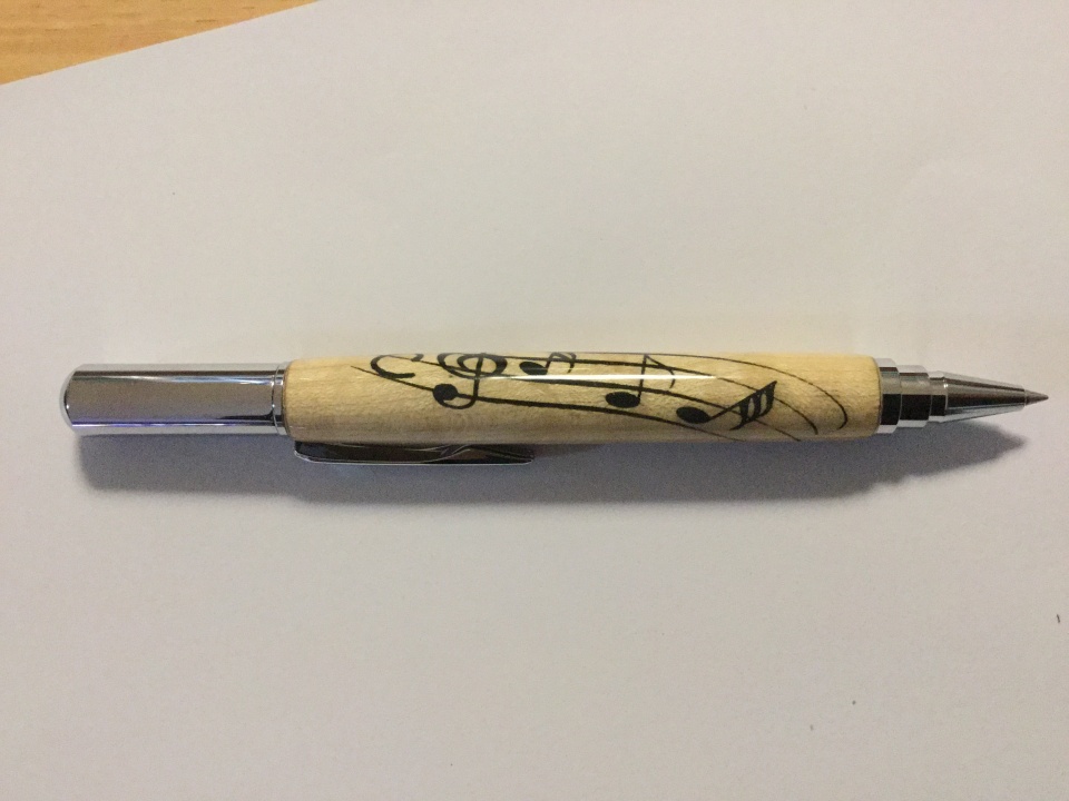

How amazing!!! Nice work. This was my first attempt...that I did for the pen swap. Do a lot of names ect...but not really thought to take it to the next level. Any advice, tips or tricks welcome :) :angel::highfive:

Beautiful work on the music pen. If you want to take it up to the next level the rotary device that you are using is the most important piece of the puzzle, IMO. I use an Epilog Helix laser and the only rotary option that Epilog supplies for that laser is an atrocious surface driving rotary. You've probably seen the ones I'm talking about. They have 2 drive wheels on the headstock end and 2 idler wheels on the tailstock end. The engraved option rests in the gap between the driving wheels. Although these might work for glasses, mugs and such, if you want to do a full 360 degree seamless engrave on something like a pen it's not going to happen. With all that being said, I custom built a mandrel based rotary fixture for the Epilog. With it I know exactly how much Y sizing is required for it to do exactly 1 revolution. I can get a seamless wrap every time when doing raster engraving or vector cutting.
