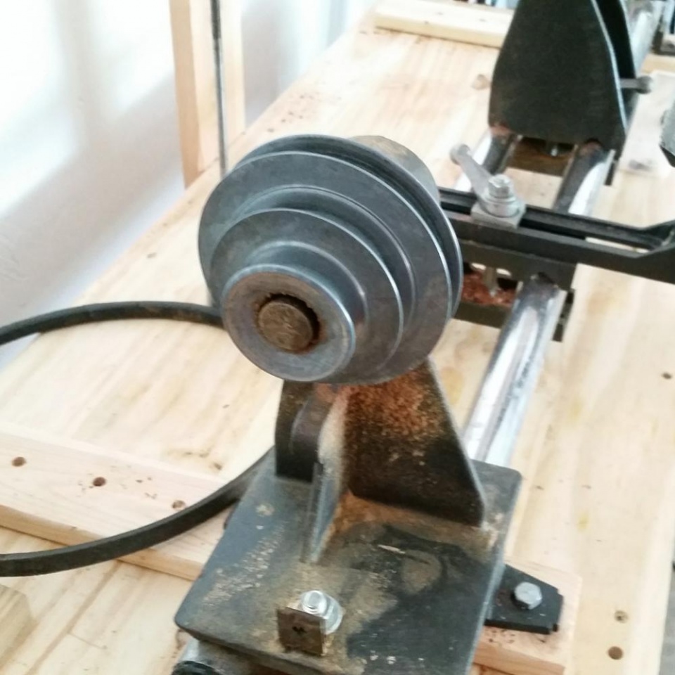

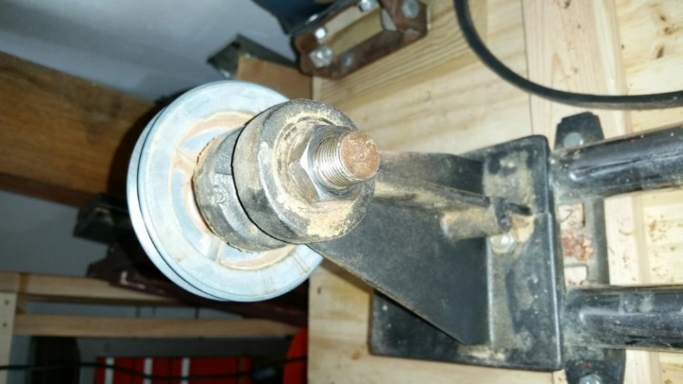

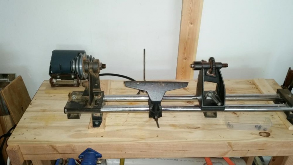

Here is my lathe. The headstock and pulley spin together and appear to be attached as pulleys normally are (the set screw). My assumption has been that's just the way it's suppose to be and the headstock can't be changed. Please correct me if I'm wrong because that will save me all sorts of headaches :)

It looks like it's made up of parts. You will have to make adapters for what you need, or replace the lathe. It's so cool looking I think I would make adapters!
