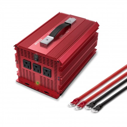

Why would you want solar for an emergency, no sun during a storm. If you want something small get a portable inverter, you can hook it up to your car battery and run a few things in an emergency.
I have a whole house generator that runs on propane but I also have this inverter as a backup to my backup...
Hi Rick. Is it really just a matter of hooking the invereter to the car battery and then plug stuff into it? Does that car have to run so as not to darin the battery. Thx!
