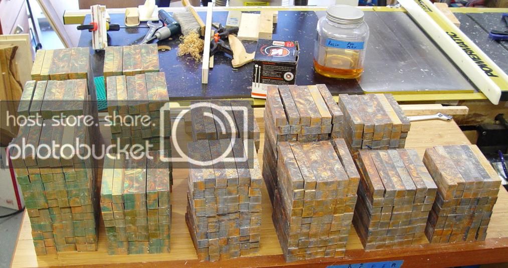

Twenty-five 60 oz pours for a total of 600 blanks cast, cut and packed in 14 hours. If I am only casting and not cutting I can cast close to 1000 blanks in 12 hours, but it takes a good chunk of the next day to cut and pack.
I use alumilite, which cures faster than poly so it speeds up the process.

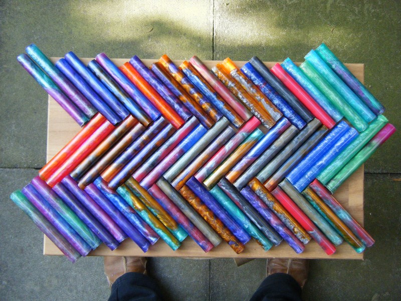

My record is 64 in the day, about 64oz's don't know what it is in gallons though.
Eric...

Found a Picture:

Found a Picture:
