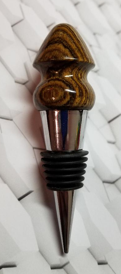

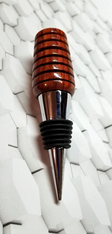

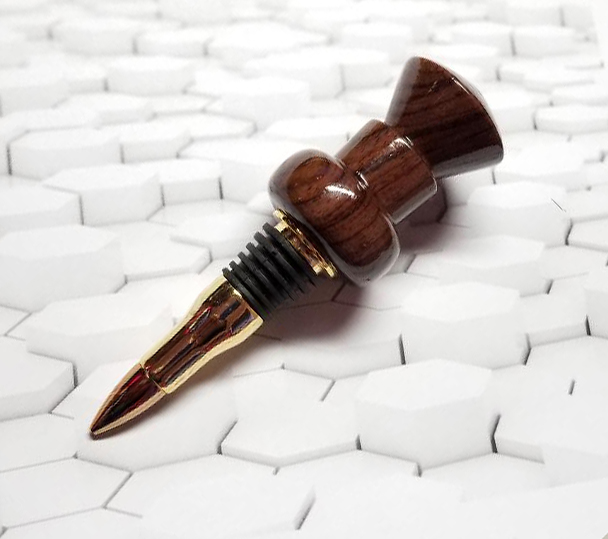

These are actually pretty fun. Trying to figure out how I want to shape them is even more fun. So here are the only 3 I've done so far. From 1st to 3rd. Lol

Those look real nice, Bobby. Bottle stoppers are lots of fun - they show off a lot of the blank & shapes are limitless.
One thing I like to do is to drill a recess hole about 1/8" deep with a 7/8" forstner bit (or whatever size matches the stopper) before drilling & tapping for the stopper. I find this gives a nice transition between blank & stopper & avoids having to perfectly square the bottom of the blank.
Yea Edgar, I plan on trying out recessing them. I have one kit which is a combo stopper and corkscrew, so I'm trying to figure out how to recess that one for sure. But you are right, I think the recess will look much better!
Like Edgar,I also prefer to have a recess in the bottom of my stoppers. There are two ways to achieve that. One is to use a forstner bit to drill a shallow mortise in the blank, before drilling the hole that is threaded for mounting on the mandrel. But I prefer another approach - I mount the blank in a chuck to drill that hole on the lathe, but first I use a gouge to carve out the mortise. Unlike the forstner bit approach, a mortise created this way has curved sides. I think it looks better.
