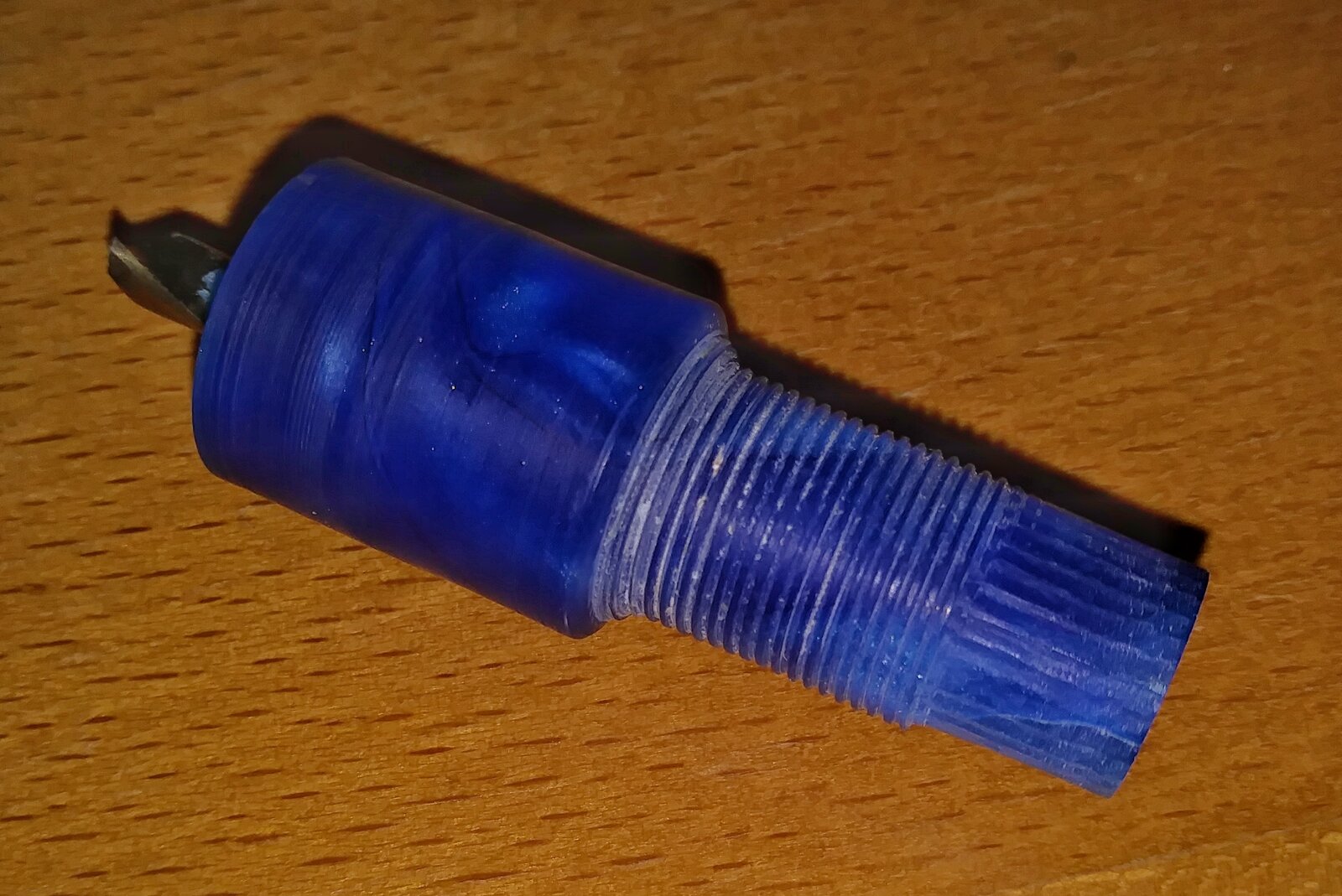

I've found pink/red transmission fluid works well (also works as a lubricant when tapping threads).
And this is something I keep close to my lathe as a reminder to keep the bit cool ... yes, the bit fused itself into the acrylic acetate, and then sheared.
