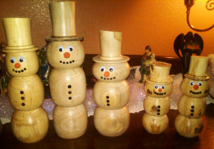

Got busy last weekend in the shop and turned 13 Snowmen for gifts and to Friends and Neighbors. Gave 4 away already and they didn't make the photos :rolleyes: Three of them were in White Elephnat Gift Exchanges and each was stolen 3 times and locked down, so they pretty much a hit. Gonna do more for next year.
Cedar, Ash and Bradford Pear were the logs I made them from.
I have a rubber mat in front of my lathe so my feet don't hurt at the end of the day. But the dogs still bark after a few hours of turning. :eek:
But with the mat and 3" of saw dust, it was like walking on air!! No barking dogs that night!! :biggrin:
Cell phone pics

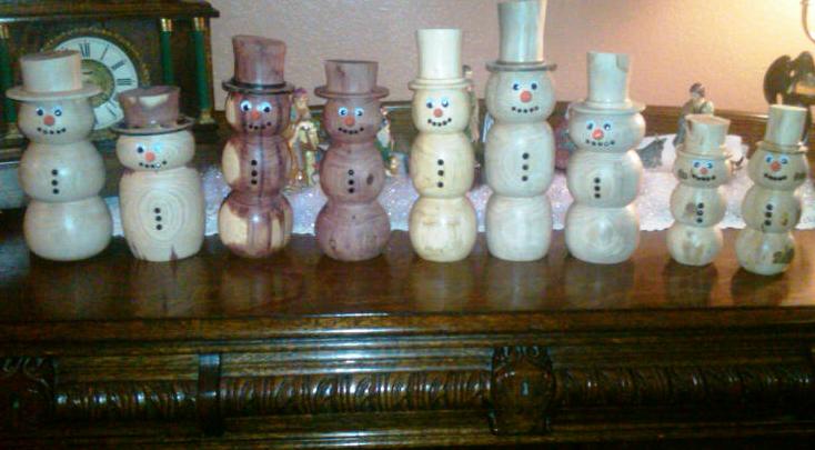

9 left:
attachment.php

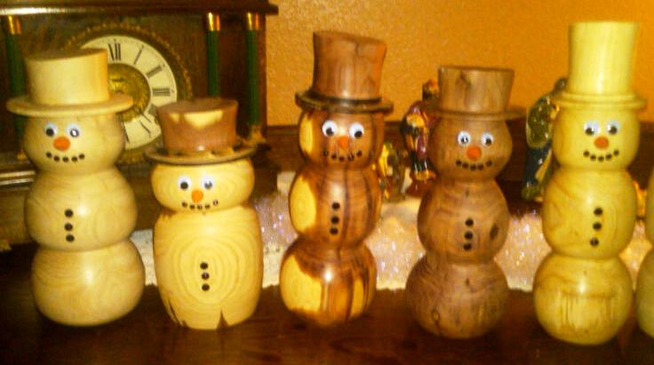

Closer looks:
attachment.php
attachment.php

I got them at Hobby Lobby in the beading section. They are Acrylic Gems - Made by Sparkle Style. I used these for the mouth and these for the buttons.
Awesome! I like the googly eyes. What did you use for the buttons/mouths?
Art
They are really easy to turn. Just turn a log between centers and make three large beads for the body, then the hat brim and then the hat. I cut the top of the hat on the band saw and then sand the base. I lacquered them on the lathe and burnished it in with a cotton rag. Med CA was used to attach the eyes, and other features. I turned the nose from scrap woods with a skew and turned a 1/4" tenon on it. My wife painted the noses with glow in the dark orange acrylic paint. I drilled a 5/15" hole for the nose and glued it in.
