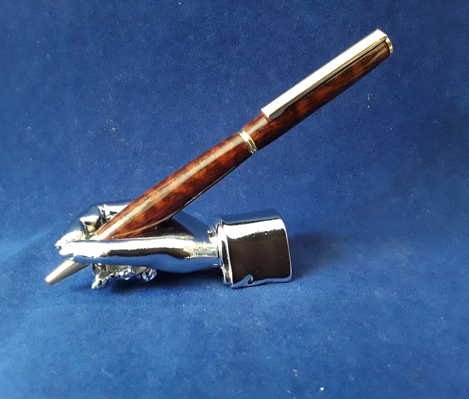

Just reading this thread was surprised to read about the problems with snakewood. I got hold of ten 20mm blanks a few weeks ago from a guy who was selling all his kit and blanks . Looking at the packets they were in I know these blanks are over 20 year old.
I just grabbed on turned it as I do the others no problem. 9 blanks left was I lucky or is this down to the age of the blanks?
It could be the aging of the wood, and it could be your great fortune and it could be your skill - or a combination of all three. The real answer will be one year, two years or three from now.
Your not out of the woods yet. When I used to turn snake wood (now I avoid it) you never knew when the crack would show up. One day your using a perfectly good pen and the next day it has a crack down the side. It's that temperamental. Good luck!
On a slimline that is the worst kit to put it on. Too thin. It will crack and no you were not lucky It will crack 😭

Oh 😱 this is not good reading at all. Do I sell the the other 9 blanks or us them on thicker pens. I bow to you guys with the experience, I dont want to sell these to unsuspecting customers. I am still learning in this game and wood knowledge is one of them. I just love the look of this wood as well. πŸ˜₯

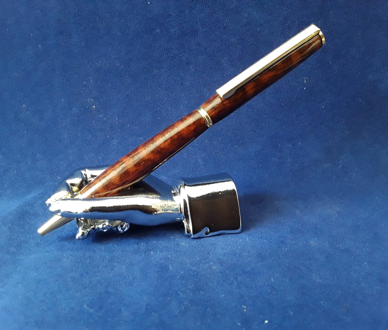

I have read all the input on this thanks to everyone. Thought sod I'll do it the same as the last one only in one piece though. Started it earlier today with sharpend tools and just a bit extra care. It's now finished and will be my pen . After reading all the input I wont sell it on. Lucky these 15mm square blanks worked out free to me after selling other bits on.
