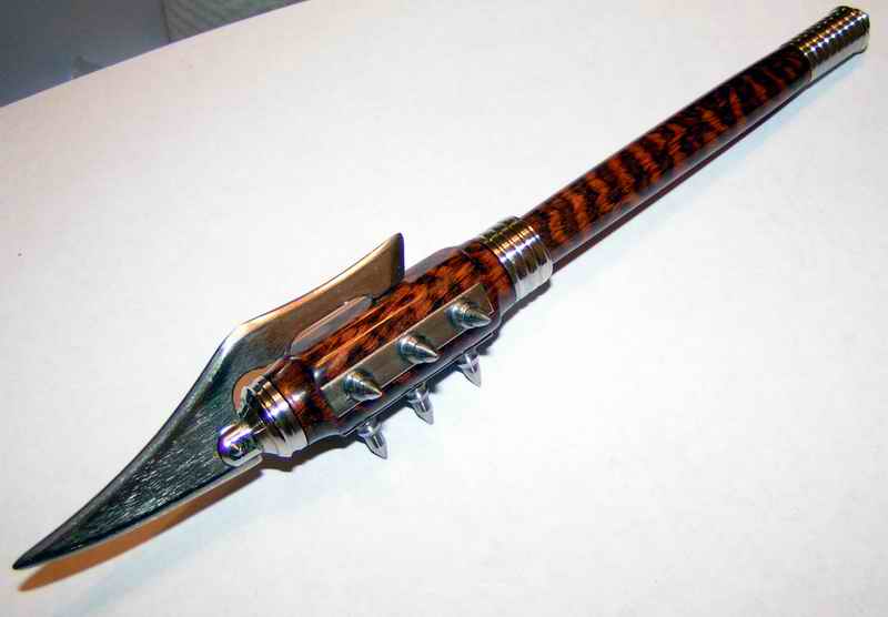

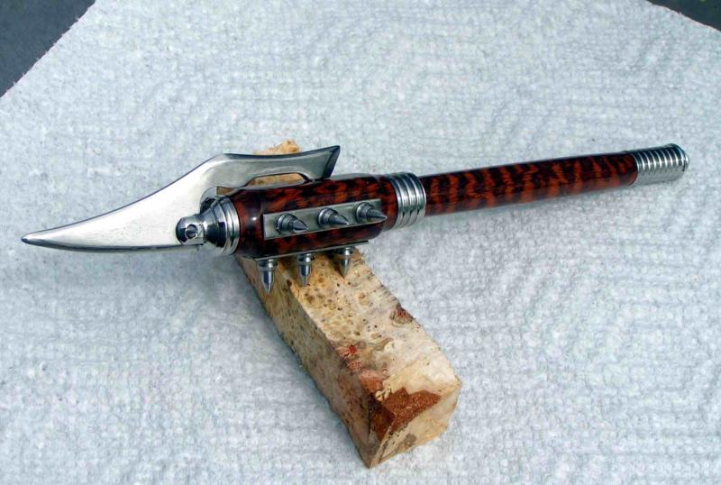

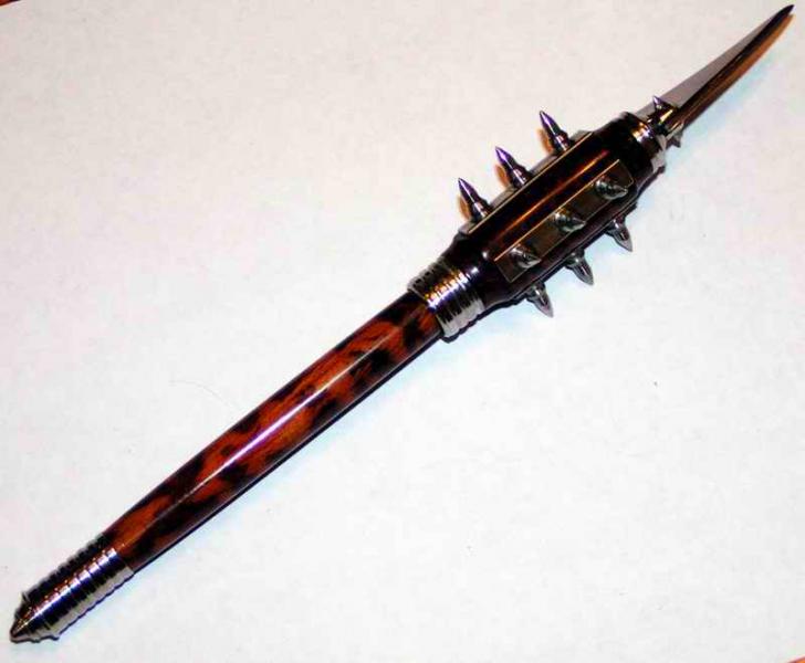

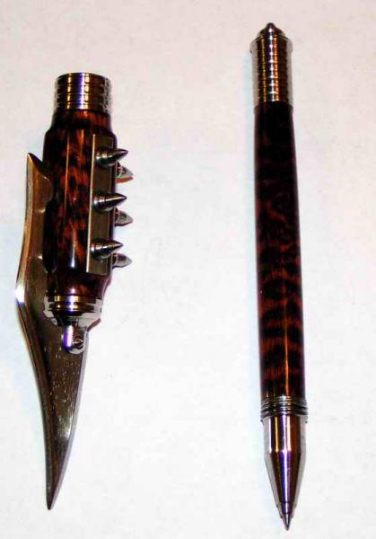

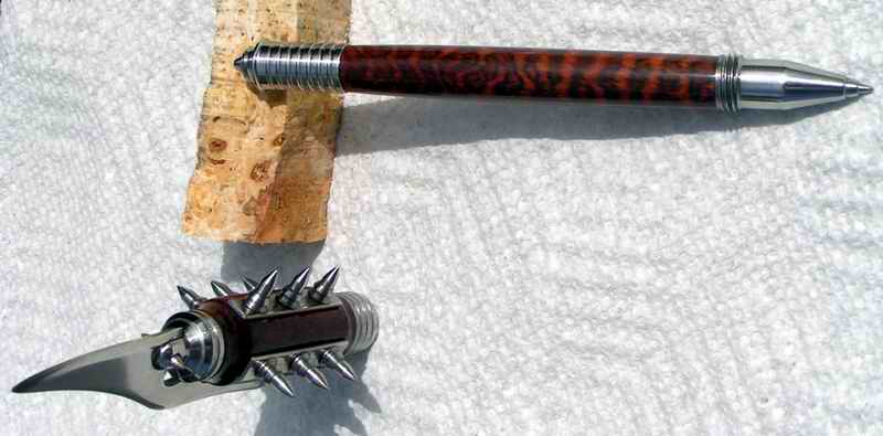

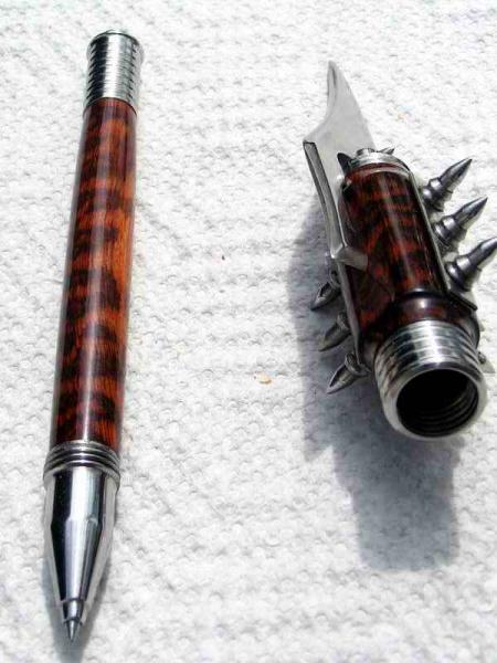

I got a little crazy with this one, I built it to resemble a Medieval Berserker war club, It has a G2 rollerball insert. The entire pen is kitless, hand built from stainless and snake wood. I plan on making a desk stand for it. Hope you like it>>>>>>>>JK >>>>>>>>>>>>I added a few more pictures taken in the sun.

That's some dragon slayer ! Just don't get that snakewood too close to the dragon's hot breath, wouldn't want it to crack instead of the dragon.
