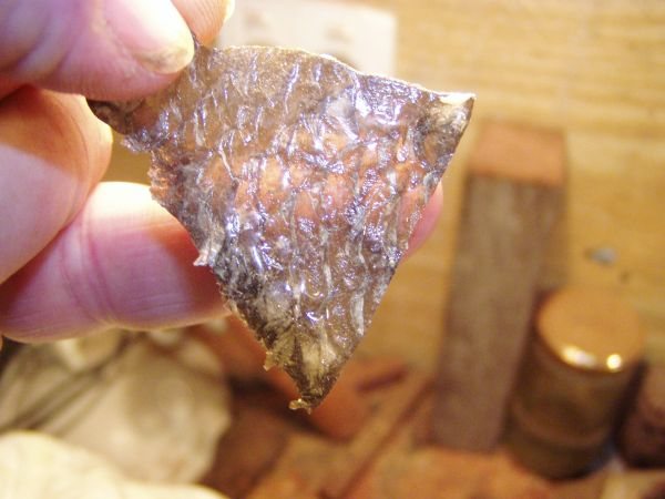

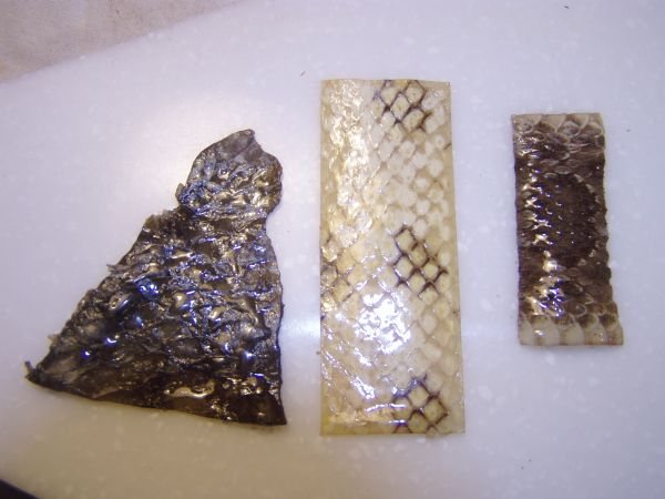

Darley Member Joined Sep 3, 2004 Messages 2,165 Location Hervey Bay Queensland Nov 22, 2007 #4 I don't know anything about alumilite product but here we have something similar " 2 pack " I did a test on some off cut, here's the result Left to right: Barramundi fish skin, Sea Snake skin, Rattle Snake skin Barramundi fish skin become translucent
