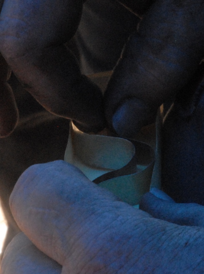

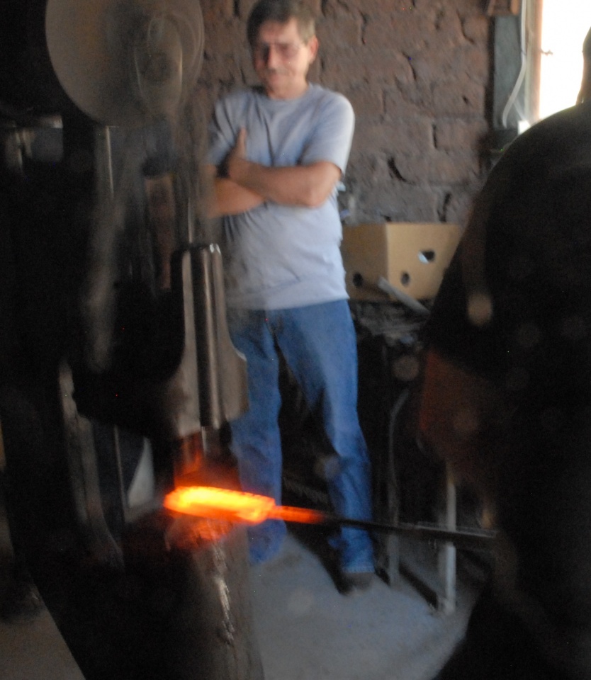

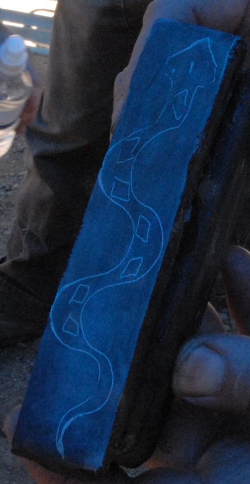

Steps: 1) is forming the snake with nickel 200 strips 2) filling the can with powdered steel and sealing 3) forge welding solid then grinding the can away 4) acid etch with feric cloride and the snake appears.

That is pretty cool William. Now, what do you do with something like that?
Ray
You could make a knife out of it, a belt buckle or a scraper or..... let your imagination run wild. The powdered steel is 1084 a high carbon tool steel so you can make almost anything. The nickel runs through the the billet so no matter how you grind it the snake will still show.
