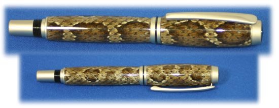

As most of you know I have been trying to improve my snake skin casting techniques. I have just added a step to the process. I did a cast last week where I used a vacuum pump to degass the resin prior to casting. I have just turned the first pen from that cast. It turned as nicely as the other and is just as clear. The thing I liked is that every tube is useable. I am or was having problems with some of the larger tubes coming out looking cruddy and unuseable. Bue, each tube in this 10-tube cast was nice and clean and clear. I also dropped the pressure in the pressure tank when casting to 25 psi instead of the 40-50 I had been using. I had no leakage of resin into the tubes at this lower pressure. I have pictures of the steps edited and in PageMaker and will be adding text to them soon. Maybe I can get it to Jeff this week sometime. Her is a picture of the frist pen from this lates vacuum-pressure casting. I also added a picture of the back side. I've been getting emails asking about the seam side. Enjoy and comments welcome.

I'm now very tempted to try the vacuum and pressure method; from a purely "intellectual" perspective, that seems like it would give the most consistent and best quality blanks.
I look forward to your write-up. Will it include your entire process?

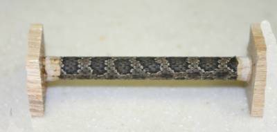

I degass the resin in a glass jar until the bubbles stop, then I take the resin and slowly pour it into the mold then place the mold into the tank and apply pressure. I want to try to pour the resin in the molds with the skinned tubes and apply vacuum, but I'm thinking the air sucked from inside the tubes will possible pull out the corks I use to seal the lends and the tubes will fill with resin. I should give it a try, but I may need to find a new way to seal and support the tubes. Here is how I do that now.

How 'bout using a rubber band around your stand-offs? That will keep them from opening up when the vacuum is pulled.
I like the cork idea!
its_virgil
Jan 1, 2004
8,131
Wichita Falls, TX, USA.
<b>Jim,
I actually run a bead of CA around the cork and glue it in the end of the tube. I also put BBs into the tube to keep them from floating in the resin. But, some have leaked in resin when the tank is pressurized. If the pressure can push the resin in, I would think the vacuum could pull the air out. The resin doesn't travel through the corks because when I cut them off the tubes, there is no resin inside...i.e. the corks are not stabilized. I may just have to prepare a tube and use a small mold and do the entire cast in vacuum and just see what happens. I'll report back when finished. Thanks, the corks seem to work very well. I ordered them from:

Don those skin blanks are really nice and I think you are on to something. As far as the leaking into the tubes goes, have you ever tried to fill the tubes with plunbers putty? It wont stick inside the tube and when you remove them form the pot just take a dowel and push out the putty. Just a thought.

Thanks Dusty. No, I haven't use plumbers putty. I use modeling clay before the pressure casting, but thought it would not work with the pressure. I'll put that on my list of things to test.

<b>UPDATE:</b>
<b>Yesterday I placed the prepared blanks(see earlier post in this thread) in the mold and poured the resin over them. Then I applied vacuum for 20 minutes, released the vacuum and applied 25 psi pressure until the PR kicked over. Came out very nice and the tubes did not leak...I'm excited. This will eleminate a couple of steps from the process. I'll turn the pen this evening or tomorrow and post a picture.
