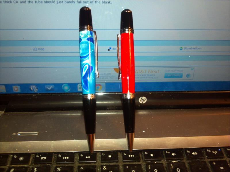

I still need to buy some equipment, like a grinder, jig and some more supplies. Right now I only have thin and medium CA. Used the medium CA tonight, slowed the drill press down and honed the skew. Much better :cool:
Made these two Sierras for my son and his girlfriend.
Again, thanks for the help!
