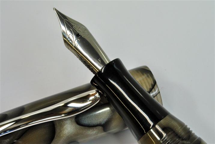

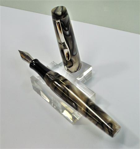

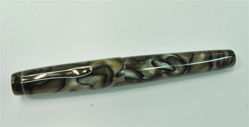

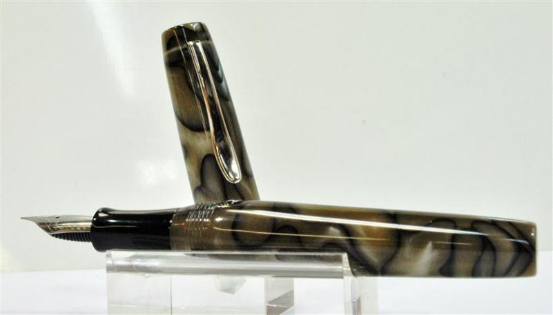

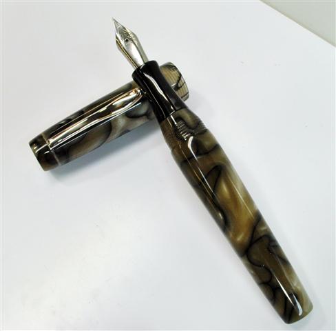

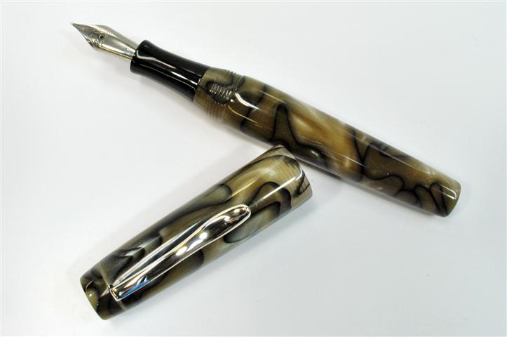

I spent quite a few hours on this one. In fact, I spent a few days on another attempt, which I won't post. I took some good advice from a fellow pen maker and then went to work on this one. Comments appreciated. Thanks for looking.
Weight 26 g
Overall length 135 mm (5 1/4")
Uncapped 125 mm (5")
Cap posted 170 mm (6 3/4")
Cap diameter 17.5 mm
Barrel diameter 16.5 mm
Section diameter 12mm
Polished steel #6 Meisternib (Jowo)
Below: This clip comes from a Polaris and is rhodium plated. $6.95 from PSI for the kit.

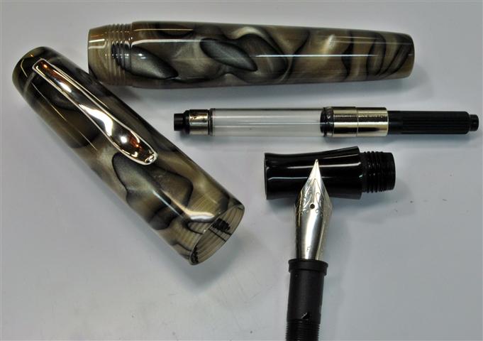

Below: The barrel to cap threads are BIG--16 x 1, but they're very smooth. BIG was necessary for the stout shape.
attachment.php
Below: It looks like an exposed clip ring or a band, but it's not. The material is transparent enough so that the clip ring shows through.
attachment.php
attachment.php

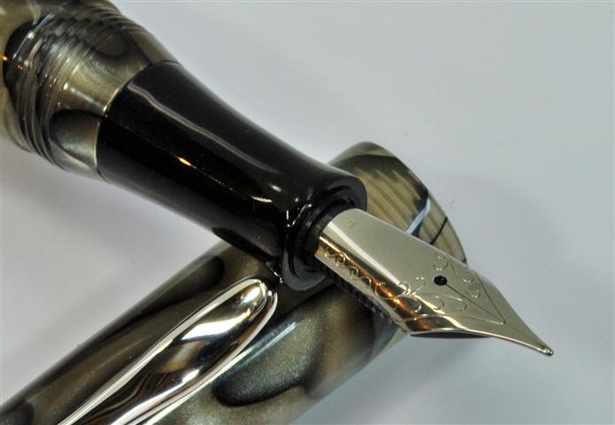

Below: The section is very thin at the waist.
attachment.php
attachment.php
Below: The blank is called Gray-Black Pearl and comes from Ed and Dawn at Exotic Blanks.

Such a great looking pen! There are only a couple people who can nail the shape and design of these custom pens and you're one of them Robert. Very nice!
Very Nice Robert, what is the diameter of the front section where it meets the body?
Robert, That is amazing!! Big, bold and beautiful. I love the smooth transitions from the larger to smaller areas of the pen! That is an awesome piece of work!! Regards, Doc:smile:
Edit:..and that section is unreal..in a good way..if I may ask..what is the diameter of the mid portion of section?
