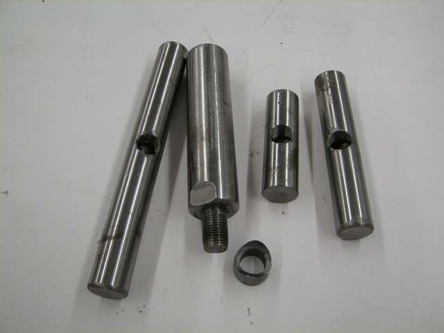

I make my own from 1" and 3/4" stock. By far I use the short 2 1/2" one the most.
Hey ole buddy ole pal... If the threads are the same on yours as mine, would you be interested in making me a 2 1/2" rest?
As I stated above, I use my 4" rest the most because it's the shortest. I'd love to have a 2 1/2" rest then it would probably be the most used of the lot.
