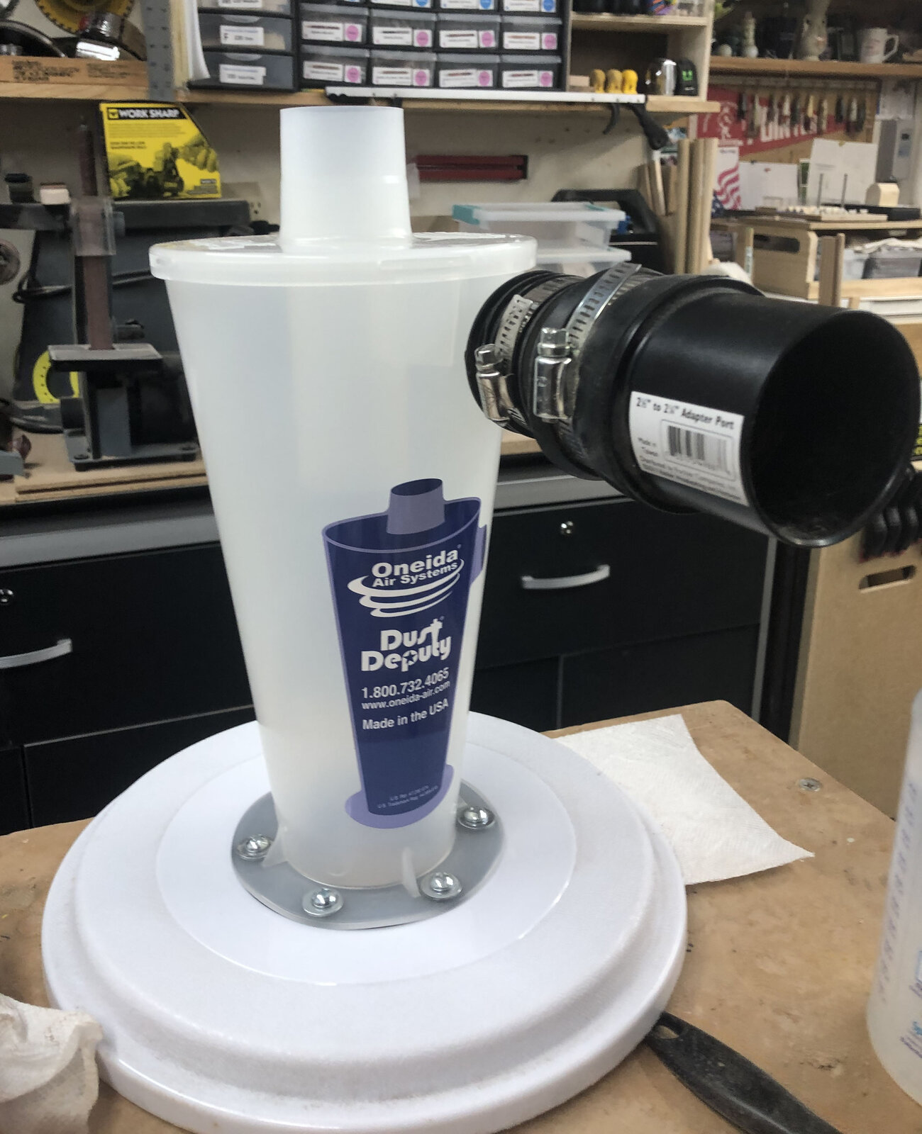

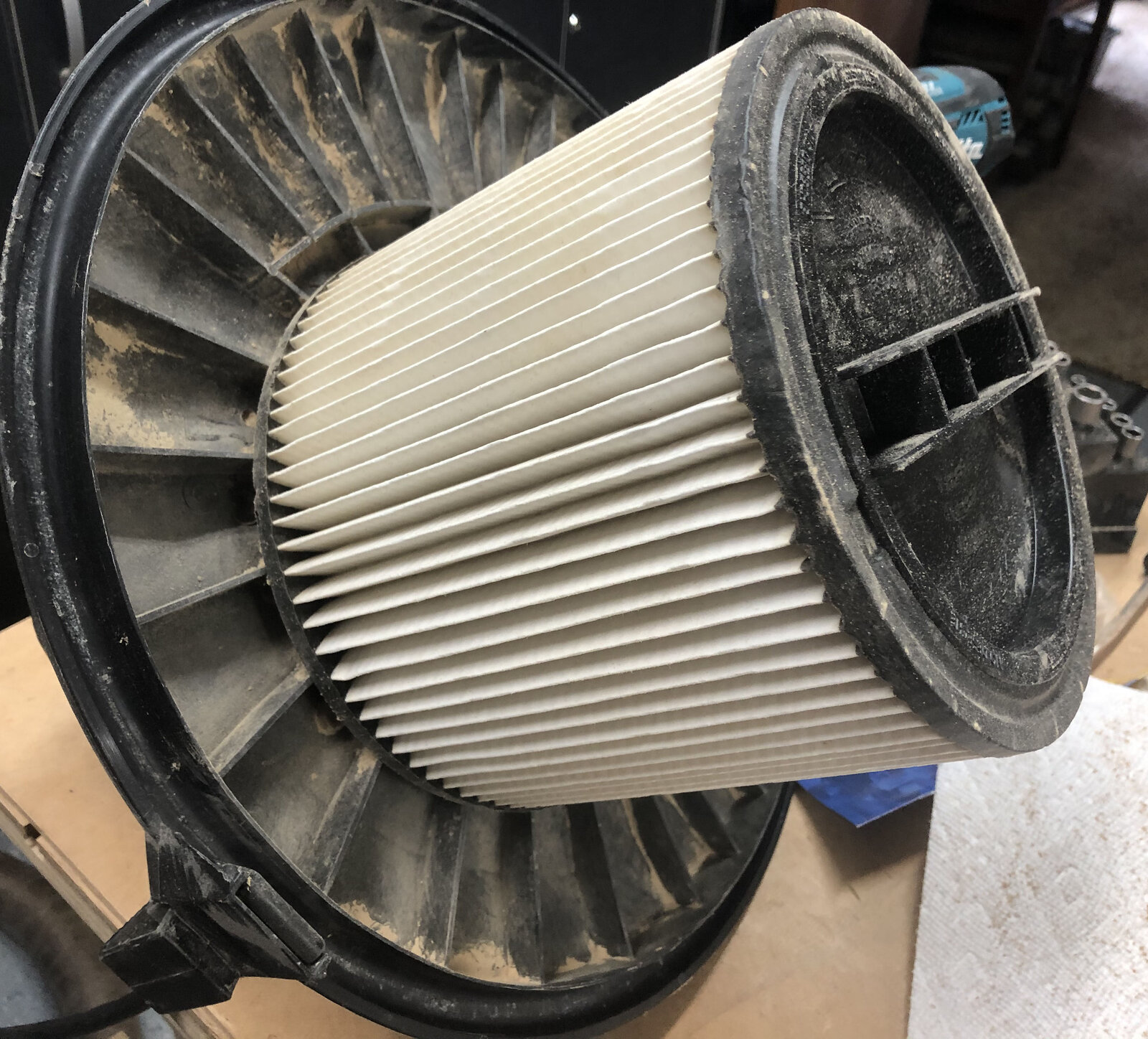

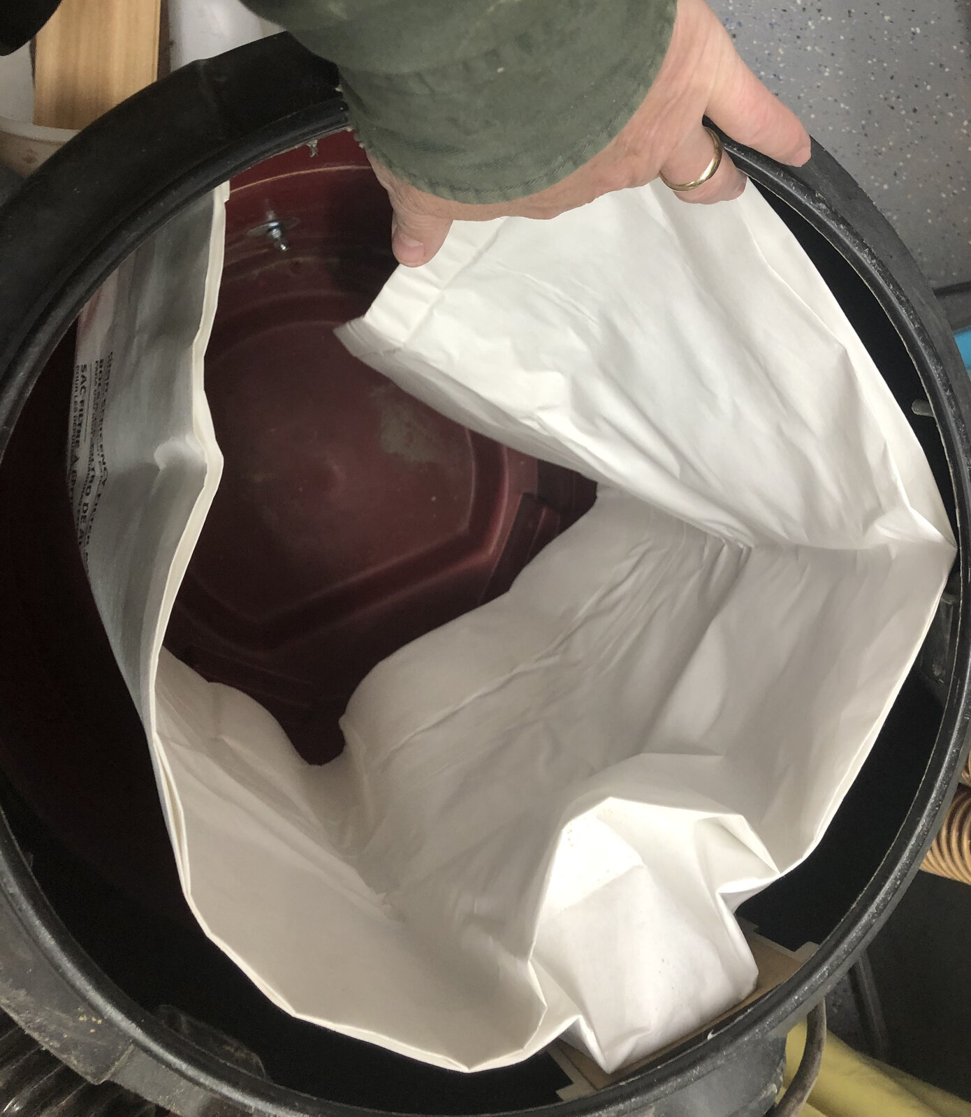

Upgrade: Yesterday I read about the "New" style of Anti-Static Dust Deputy that incorporates what they call Neutral-Vane technology which is touted to improve separation efficiency by 20% over their older model and to remove 99% of the dust. (There are a couple of YouTube video reviews with some testing of the efficiency improvement from the new design that appear to bear this out). So, this morning, along with doing some long overdue cleaning and maintenance, I replaced my "old" Dust Deputy with the "new" Neutral-vane design. I also replaced the standard filter bag in my vacuum with one made for capturing drywall and other fine dust.

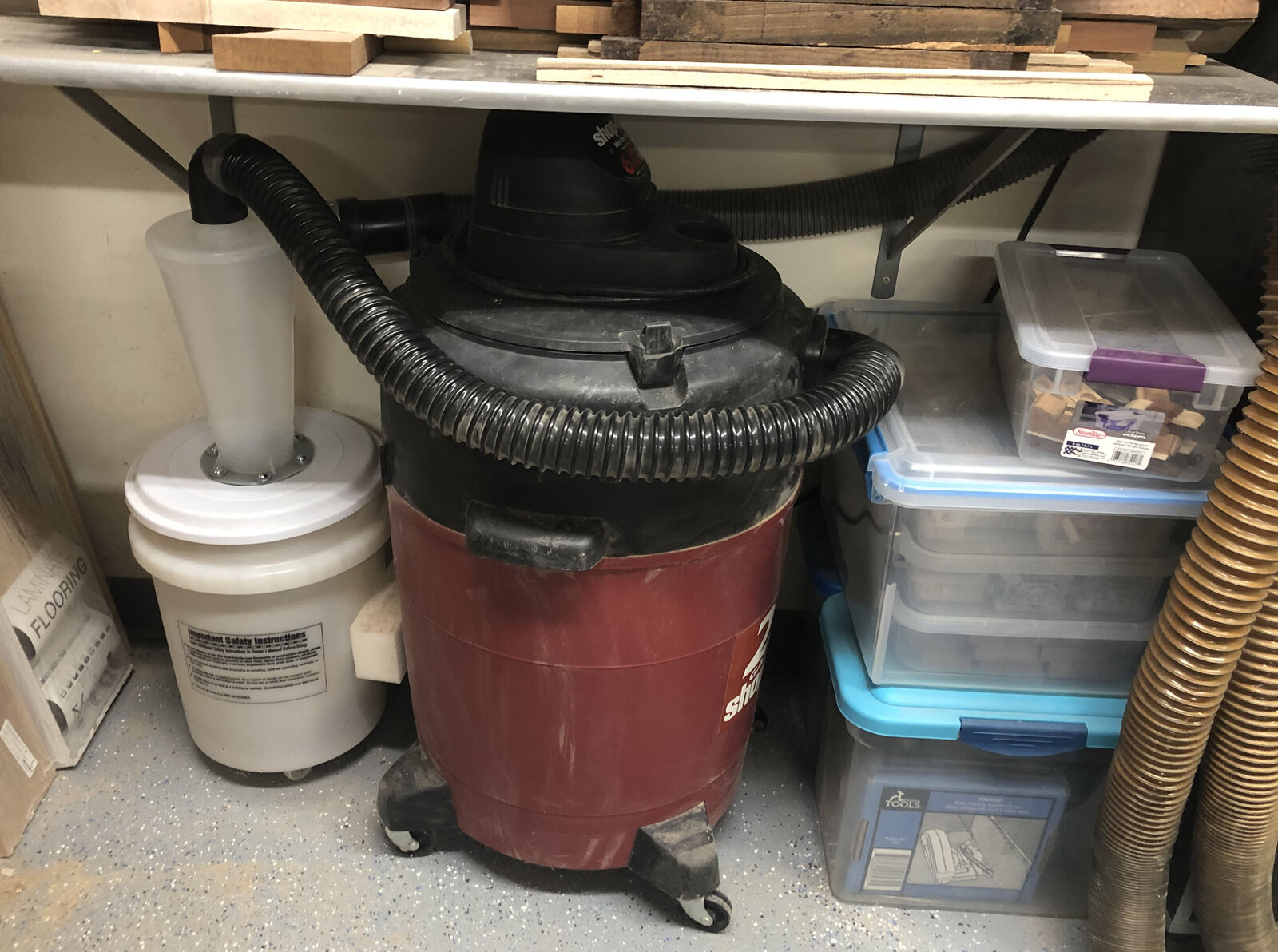

So, other than occasionally emptying the bucket, my system will probably go without maintenance for another 5-years and I will have a little more peace of mind that I at least did something to improve the air quality in my shop considering the available space and my financial means.

Drywall and Fine Dust bag, cartridge filter, "new" Dust Deputy:

The system tucked back in its place, tucked away under a shelf in the shop:
