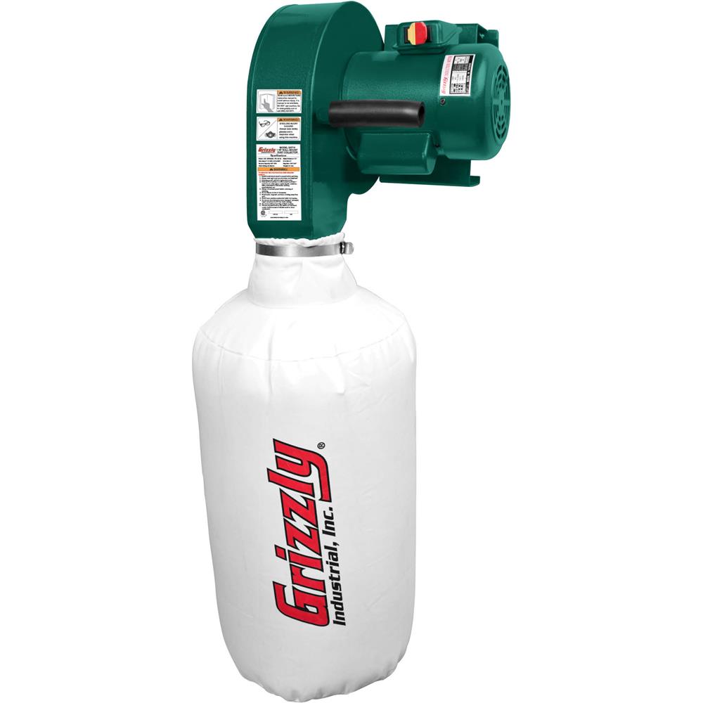

When I was looking for a small one, I liked the Grizzly G0710 wall hanger, $200
I never got it, but it was my choice, but never moved in to the smaller pla.ce

I got one just like the photo in the post above at Harbor Freight, looks just like the Grizzly, I mounted it on the wall next to the Lathe, got a clothes driver vent hose, removed the screens in the suction, found that the long slivers will stop them up, it really works nice, sucks everything up, got to hang on to the 1,200 sand paper small pieces they vanish quickly.

You may not have had it long enough to notice, but if so I'm curious if you find the bags are fine enough to filter out the smaller dust particles as well or does it just catch the bigger stuff?
I too have a very small space and am currently using a shop vac. I've been back and forth between a dust collector and a ceiling hung filter with a finer filter. I do a lot of bowls and work with green wood, so that doesn't generate to much fine dust. It's the dry wood and sanding that's frustrating and what I'm more concerned about.

The Grizzly has a 30 micron bag and the Harbor Freight 5 Micron. Neither is good enough to capture the finest dust particles from sanding. You want 1 micron or better.
