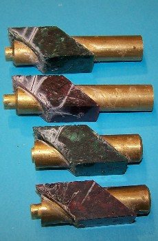

Here's how I do it. The brass rod in the glue ups were also cut in the same clamp, on the same saw.

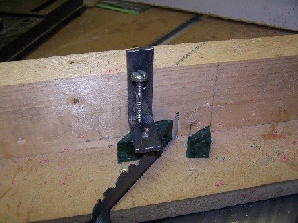

Aint no way I would trust the "holding power"(I use the term loosely) of a clothes pin.
I kinda lean towards that thought too, Eagle....
But it does give me an idea for using a metal spring clamp I have to give a bit more holding power, using the same concept.
It sure does beat chasing small pieces around the shop, even when you keep the blade down after the cut and let it stop spinning.
Some really thin pieces, like accents in a segmented pem might be too small for even this to work well. But for segmented bowl pieces, it would work well

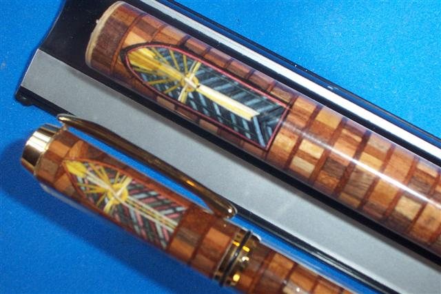

You cannot make a blank like this on a mitersaw.

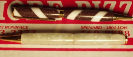

I have been using a tablesaw to make the blanks I make for over 2 years which I believe is long before some listed on this forum ever made a pen let alone a segmented blank.
My third pen was a spiral segment made on the table saw.
Use what ever you feel comfortable with.I have adapted 30 years of WOODWORKING skills( and mistakes) to making the blanks I make with the tools I use.

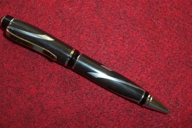

Do this with a miter saw.Bear in mind I make my own veneers with a tablesaw.

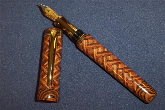

or this
