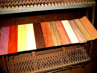

GREEN VALLEY WOOD PRODUCTS, LLC (goes by monitorseller on ebay) has a pretty good variety of thin stock, and I would say reasonable shipping/prices (shipping is baked-in and 'free').
Thin dimensioned lumber prices are pretty insane IMHO, getting a decent jobsite table saw will save you loads of money in the long-run.
search for 1/4 and 1/8. Not exactly easy to navigate, but they do have a lot of variety. Packs are probably the way to go.
