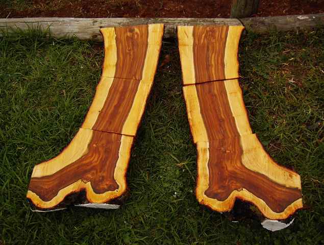

Some are obviously worse than others, and one that I have had the worse experiences with is the Almond tree wood, particular on young trees yo to about 25 to 30 years old. On the other hand these type of young trees produce some of the most vivid and interesting heartwood shapes I ever seen and, despite every possible attempt to preserve this natural beauty, have dramatically failed...!
Some of these fruit tree logs and or blanks if processed into such while green, become unworkable, unless you like to make tooth-picks, the total separation of the wood while drying is one of the most extreme I also seen with logs naturally ripping themselves apart as if they were blown with dynamite, some do actually split in 2 or 3 pieces like if they were split for firewood...!
Making round blanks out of these type woods, is the most difficult, the same goes to making any decent size square size blanks, the only blank type that these woods many time are only useful for is to make pen blanks, even tough with a great percentage of waste...!
Turning them very thin to void cracking and or warping, didn't work for me either, and I had mine totally soaked/saturated in the Fungishield witch as proven to be a great wood stabiliser saving a good 80% of my green turnings from the firewood pile.
One other problem with most fruit trees wood is that, if left to dry excessively, the wood becomes extremely hard to work with, making tool sharpening a constant reality...!
Attached is a pic that impressed and intrigued a lot of people, some called the "tall boots pic"...! :biggrin:

Kool pair of boots George :biggrin:
I know what you mean about extremly hard when dry.
Someone gave me a big chunk of apple wood in lof form that was dry for about 5 or 6 years . Man . . that stuff was like turning concrete yet all of them are so nice to turn when green and seeing those long curly ribbons of shavings coming off the wood.
