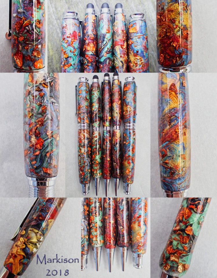

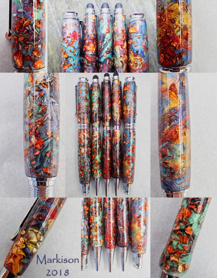

RVA - I use my slow drying systems often for painting tubes with hand made flat and dimensional paints prior to casting - here are some examples from this 2018 post:
http://www.penturners.org/forum/f13/mica-acrylic-paintscape-pens-157482/
attachment.php
Best regards - Bob
