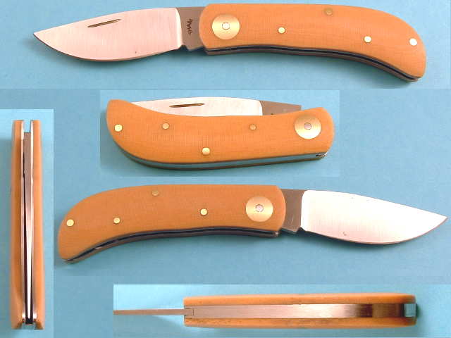

I'm still turning an occasional pen, but here lately I've been spending most of my shop time figuring out how to make traditional slipjoint knives. Here's the latest one...5.75" overall length, 3.25" closed, ATS34 stainless blade and backspring, bone G10 scales. Thanks for takin a look! -Phil

Thats pretty nice Phil.
I have always wanted to get into knives but I good wood tools. What kind of tooling do you need to make that knife?

Lupe dont let the tooling worry you. you can make a fine knife with simple hand tools. the first belt grinder i used was a simple delta 1 X 42 from the local HomeDepo. a drill press is a plus to have. If you stick tp useing a good high carbon steel like 1095 or O1 you can do the all heat treating at home. I am by no means a master grinder with 300+ knives now, but if I can do it Anyone can HA!
my guess is there are lots of guys like me and Phil that would be happy to help you take your first steps.

Thanks for the kind words guys.
