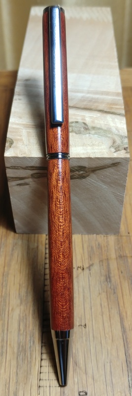

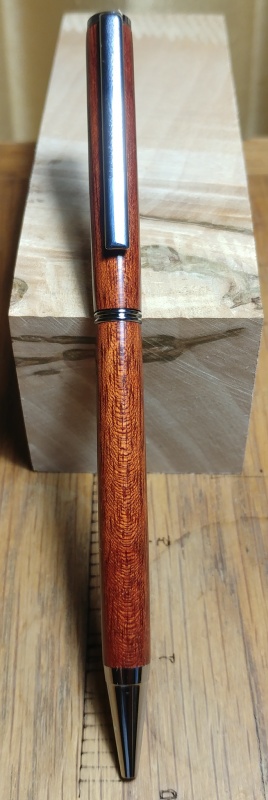

ok here is the first one.
the transmission is set in to the crimp and looks good when opened.

I like the look of Euro's over the standard slimline. I buy euro tubes to make slimlines. I end up with a lot of extra tubes this way, but our local VA has pen turning as an activity, and I use the extra tubes to make blanks for the vets to turn. I know I could buy the 10" tubes & cut them to the length I want, but since I have a use for the extra tubes, there is no need.
Good job on the longer slimline. :good:
