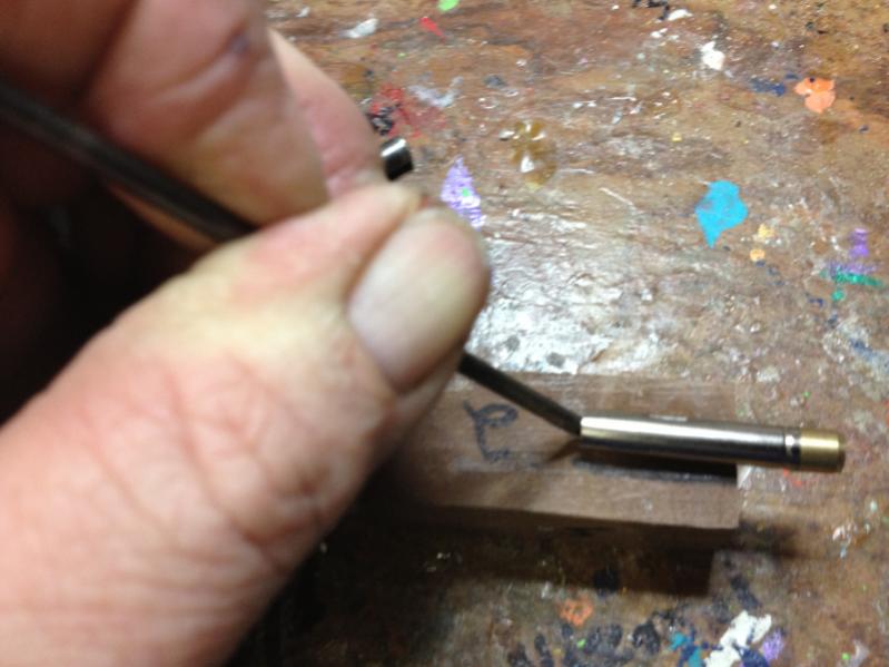

Bernie if I'm understanding you right the tranny is just turning in the upper tube, not grabbing. This is a common problem when tubes an d hardware get mixed up. What I do to all my transmission is take the smallest punch ( use the one from my harbor freight transfer punches) and grind the end to a fairly sharp point. Use this at an angle as deep in the tranny and tap a couple of time with a small hammer. This should create a dimple. Do this three or four time around the barrel of the transmission. These dimes will now "grab " the upper barrel and twist the tranny as it should. Hope this helps
