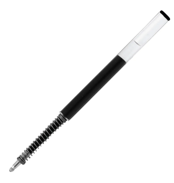

I've attached a photo of the f-301 cartridge. These are common pens, and they have a cult following. If I can figure out a good way to do this, I think they could be a great seller, but the main thing is to get this one done for my uncle.

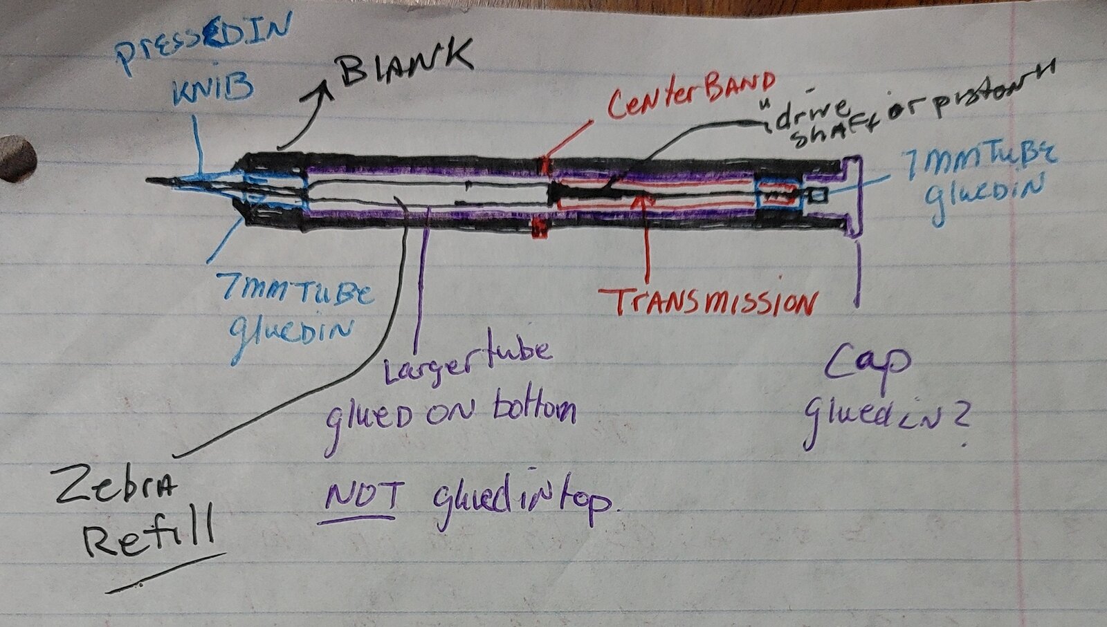

So I think I was to hasty in my response. I forgot that the way slimline transmissions work is by having a threaded cross refill. The transmissions are held in the bottom tube and the cross refill threads in from the top. When you twist it, it extends via the internal mechanism of the transmission.
What I was think was that the "slimmer" part of the transmission would press against the top of the refill, thereby extending it.
It might still work, but you would have to make a piston which screwed into the transmission and pushed out the zebra refill as you turned it. I'm still not even convinced that would work, but it might be fun to experiment with.
Crude drawing attached.
I used different colors to represent the different parts.

Thanks! Your design makes sense now. However, you can dispense with the larger tube by drilling out the transmission, trimming the refill, and pressing the transmission as far as you can (leaving about 1/2" protruding) into the upper tube. In the end, I think that's the simplest solution.
