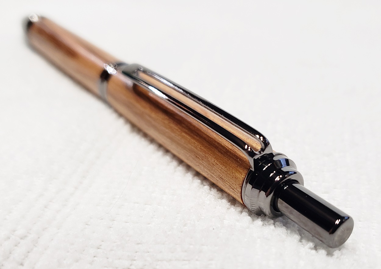

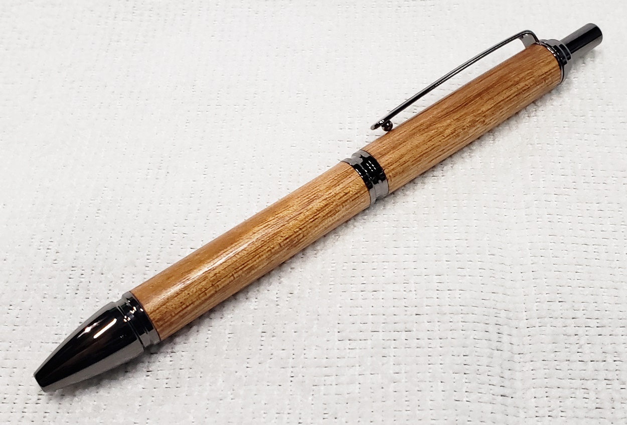

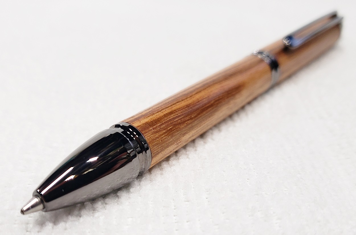

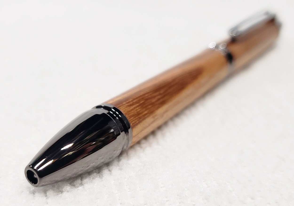

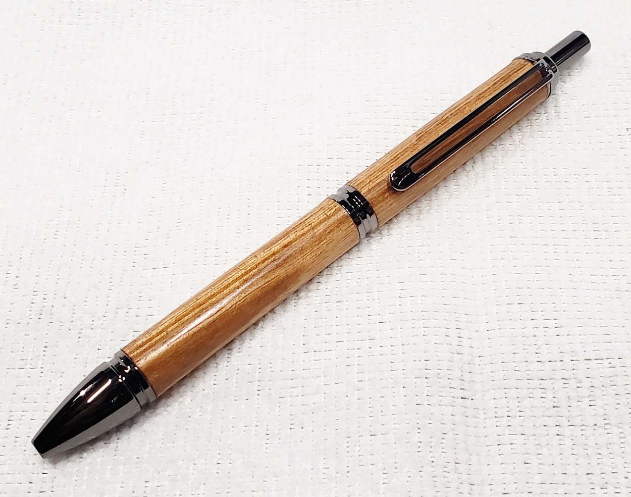

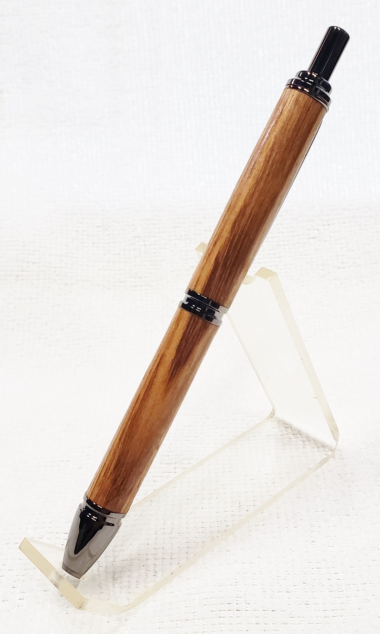

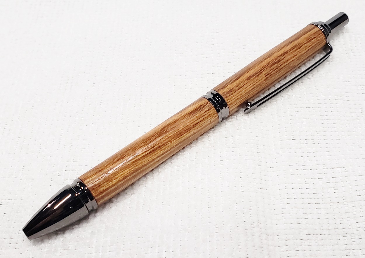

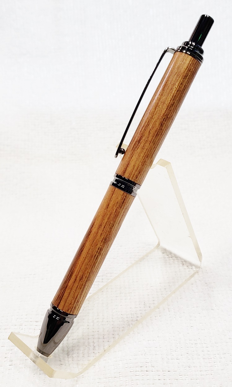

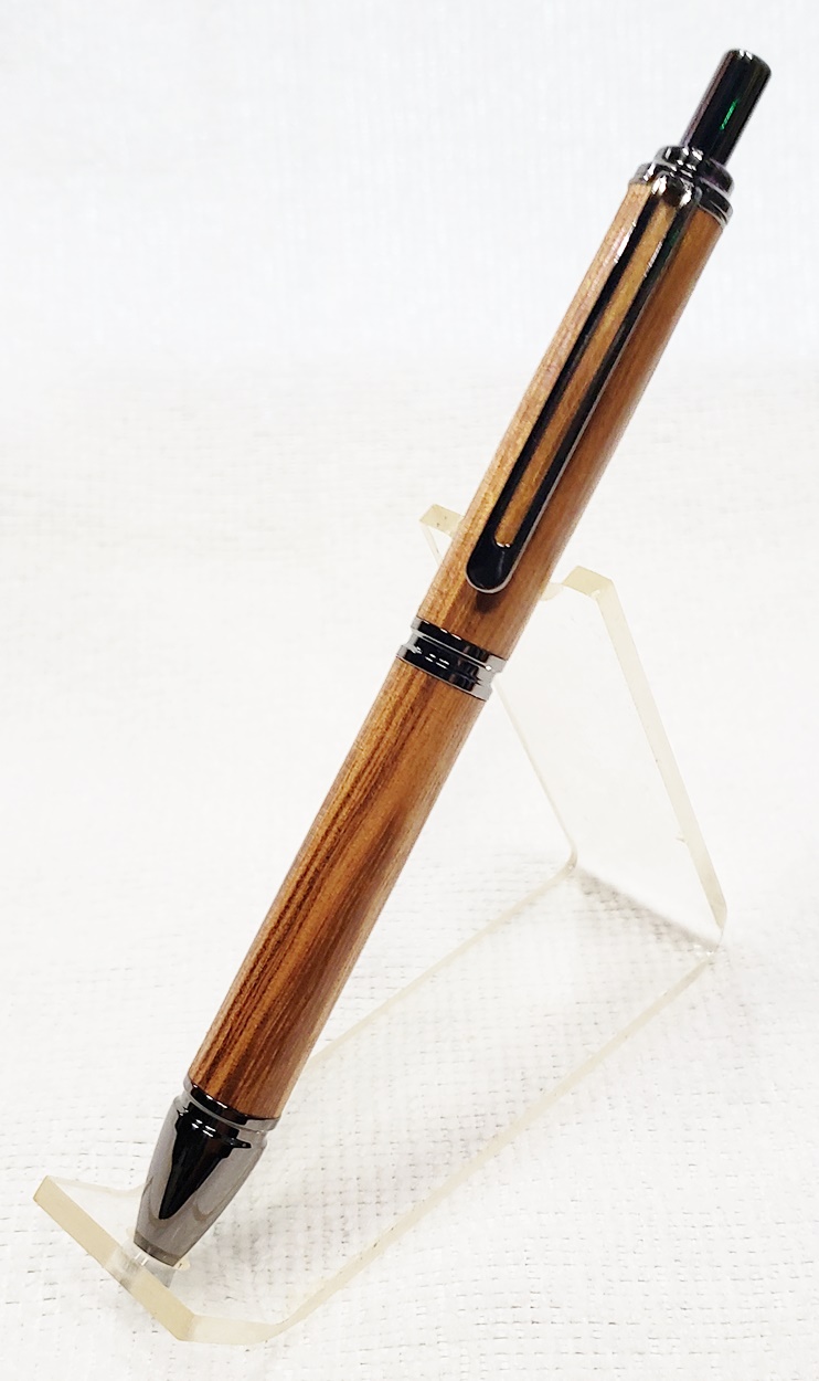

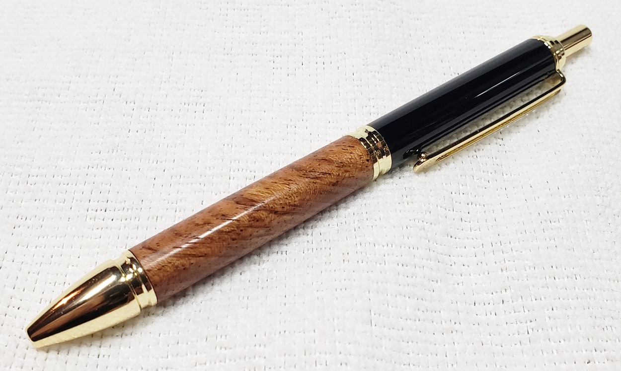

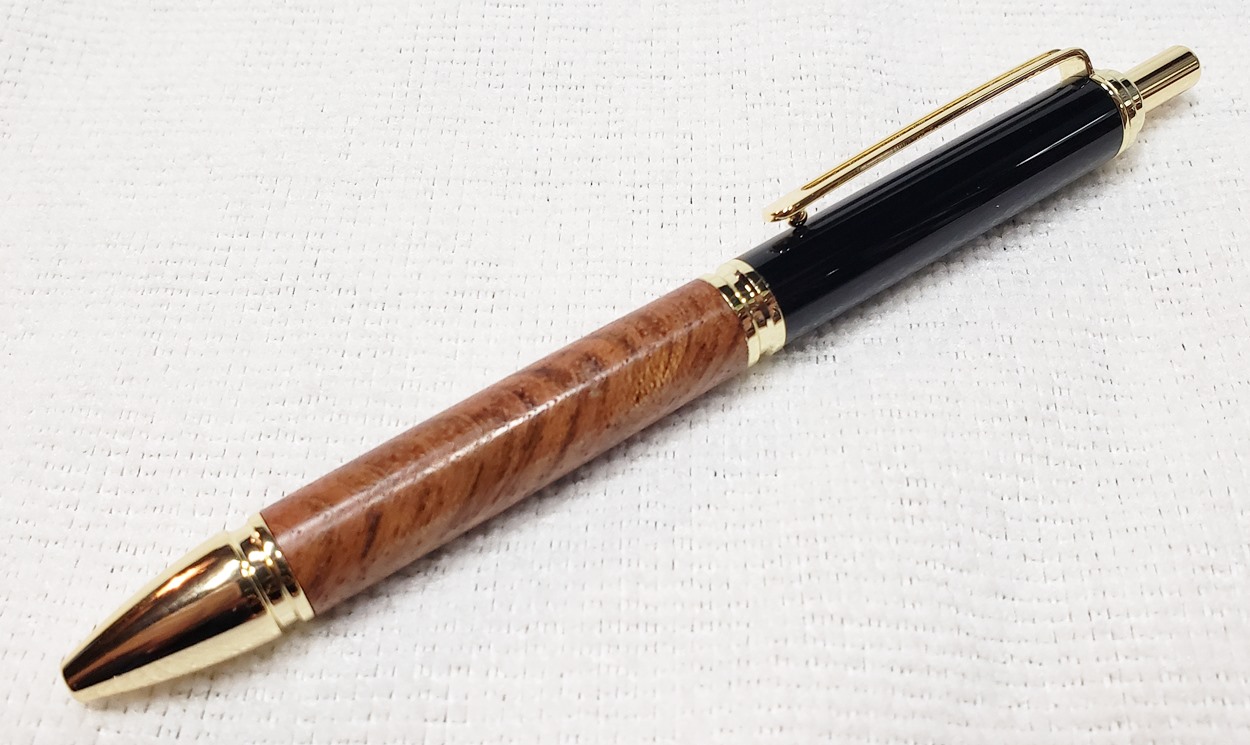

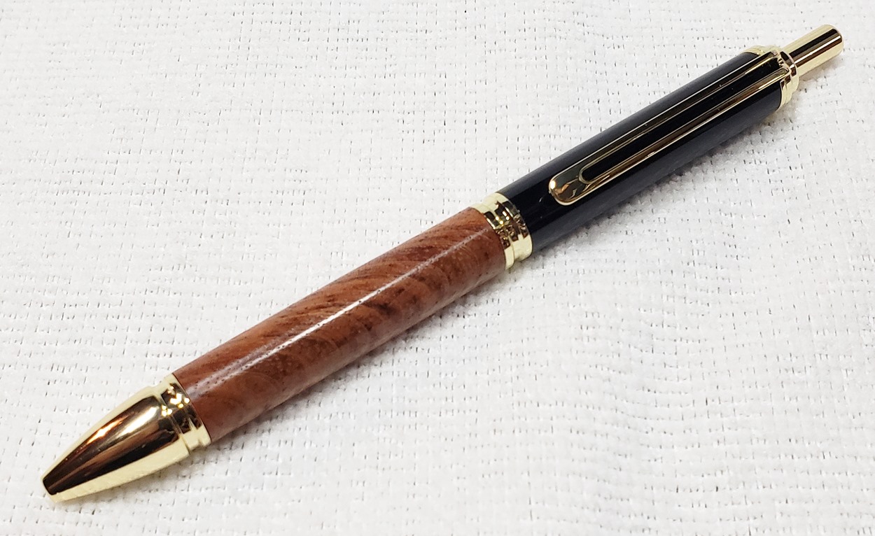

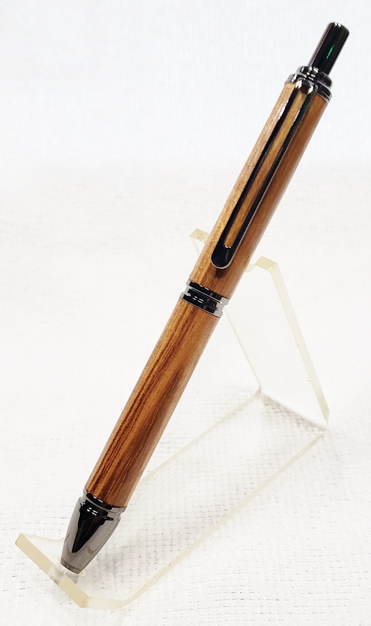

This is a PSI Slimline Pro EDC click pen in gunmetal. The blank is hububalli. This blank is nicer than the first hububalli blank I turned. The finish is Pens Plus. Made a great looking pen.

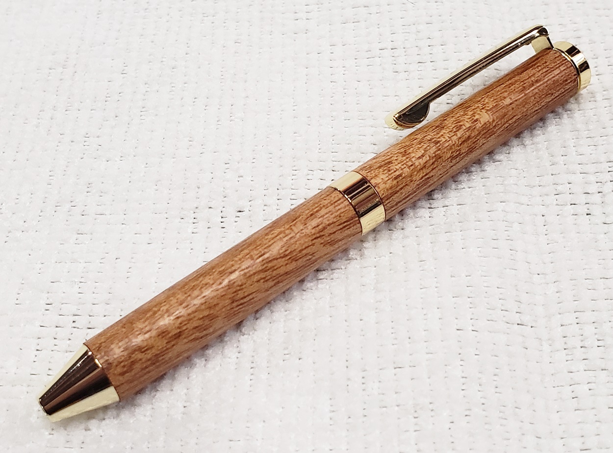

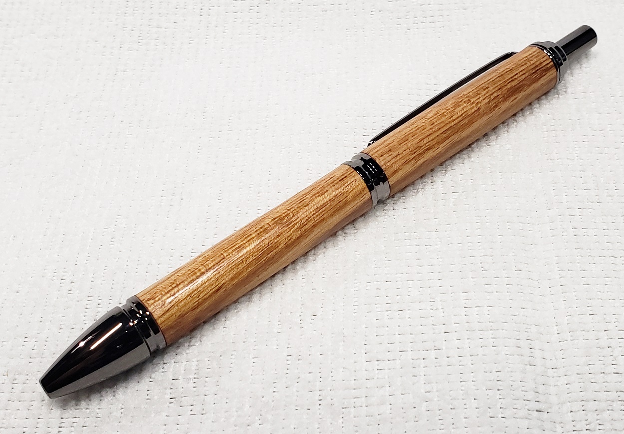

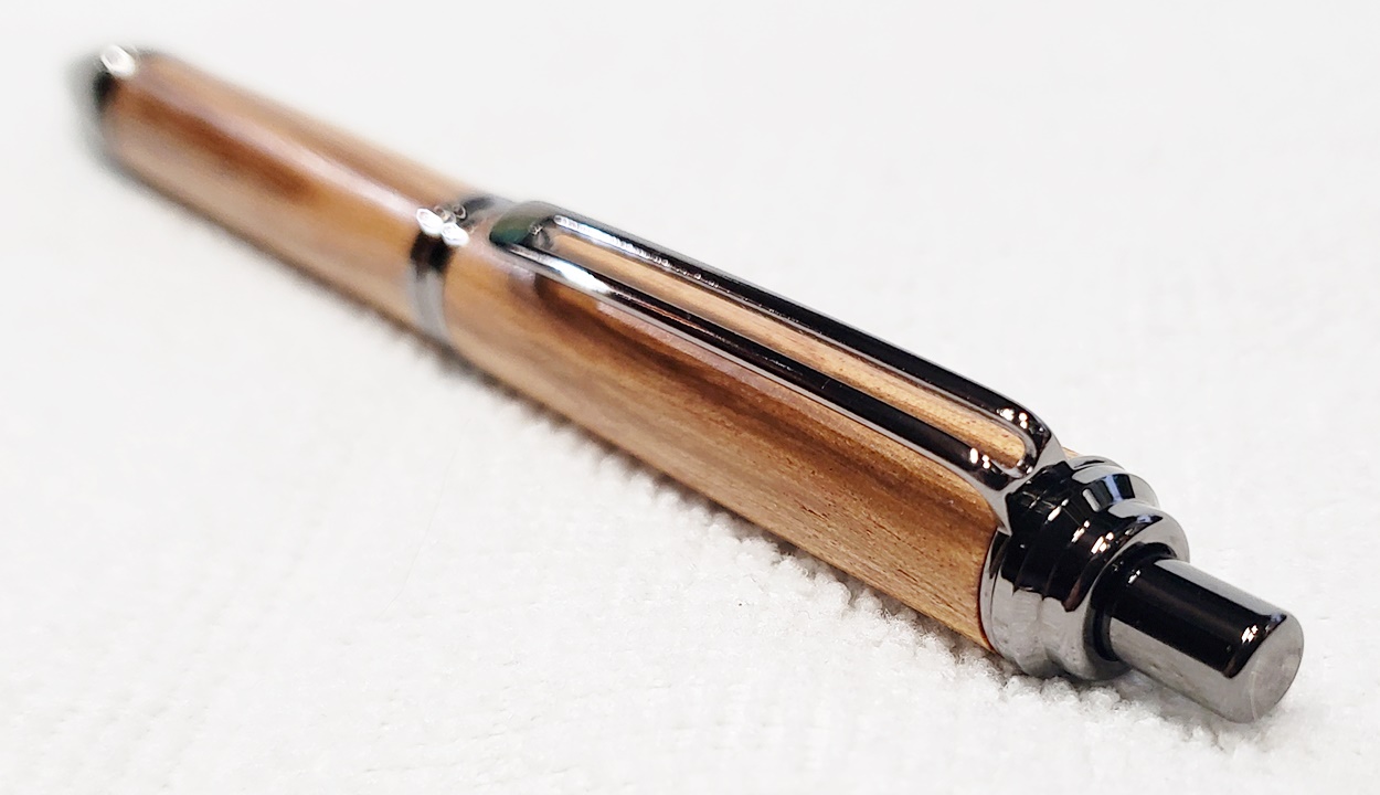

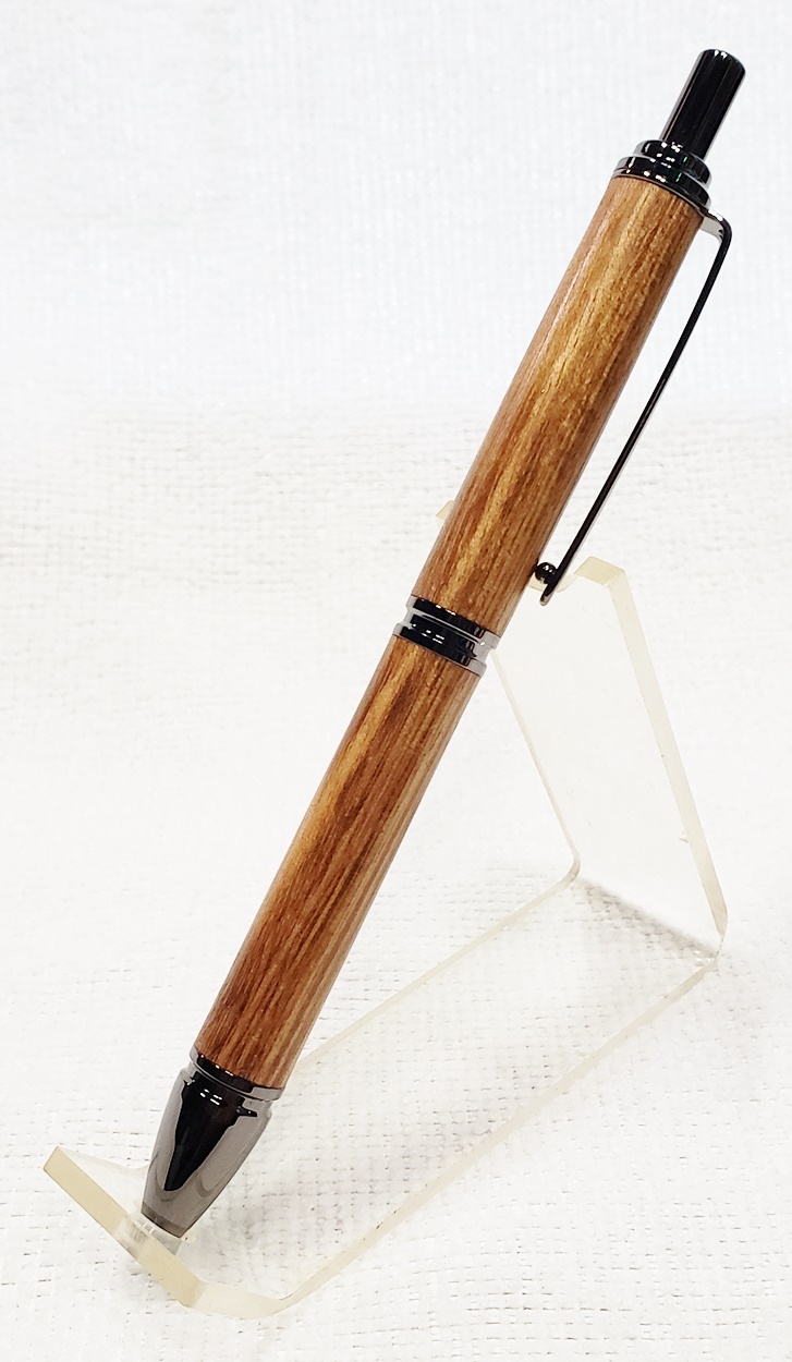

This is the first hububalli pen I turned. A little more bland.

Nice job. I've made a couple of those and I have to say it's one of my favorite click pens and it uses a Parker refill.
All very nice pens Jim. I may have to try some of those Pro EDC Click kits. - Dave

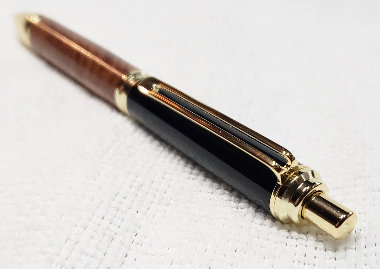

This is my second. I like them. The first was jatoba and black acrylic. One of the blanks chipped out on me, so I replaced it with the acrylic.

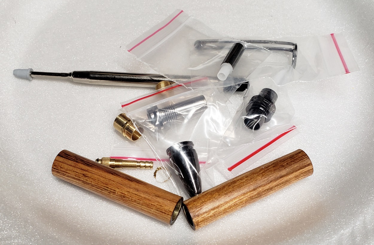

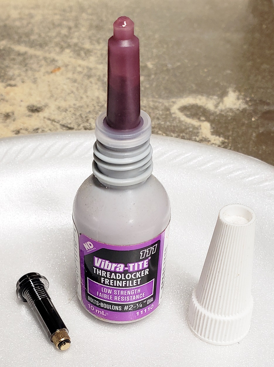

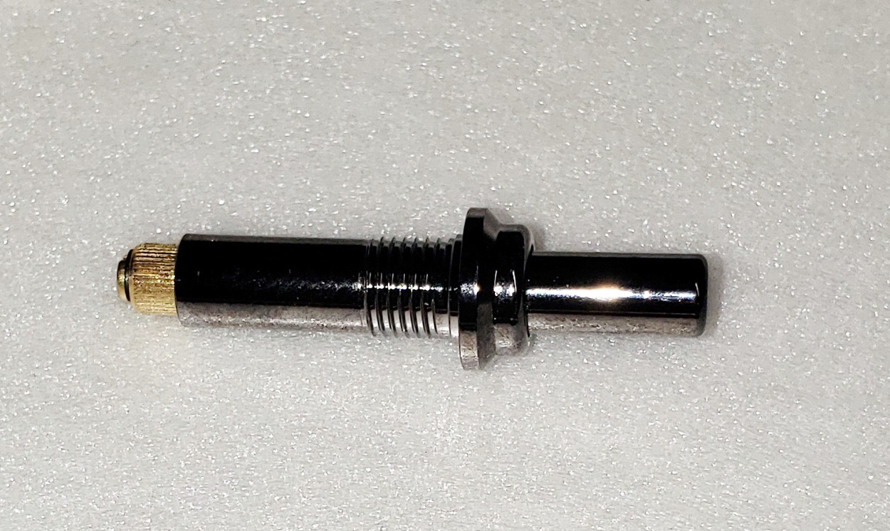

Here are the components. I use threadlocker on the click mechanism so it doesn't work loose.

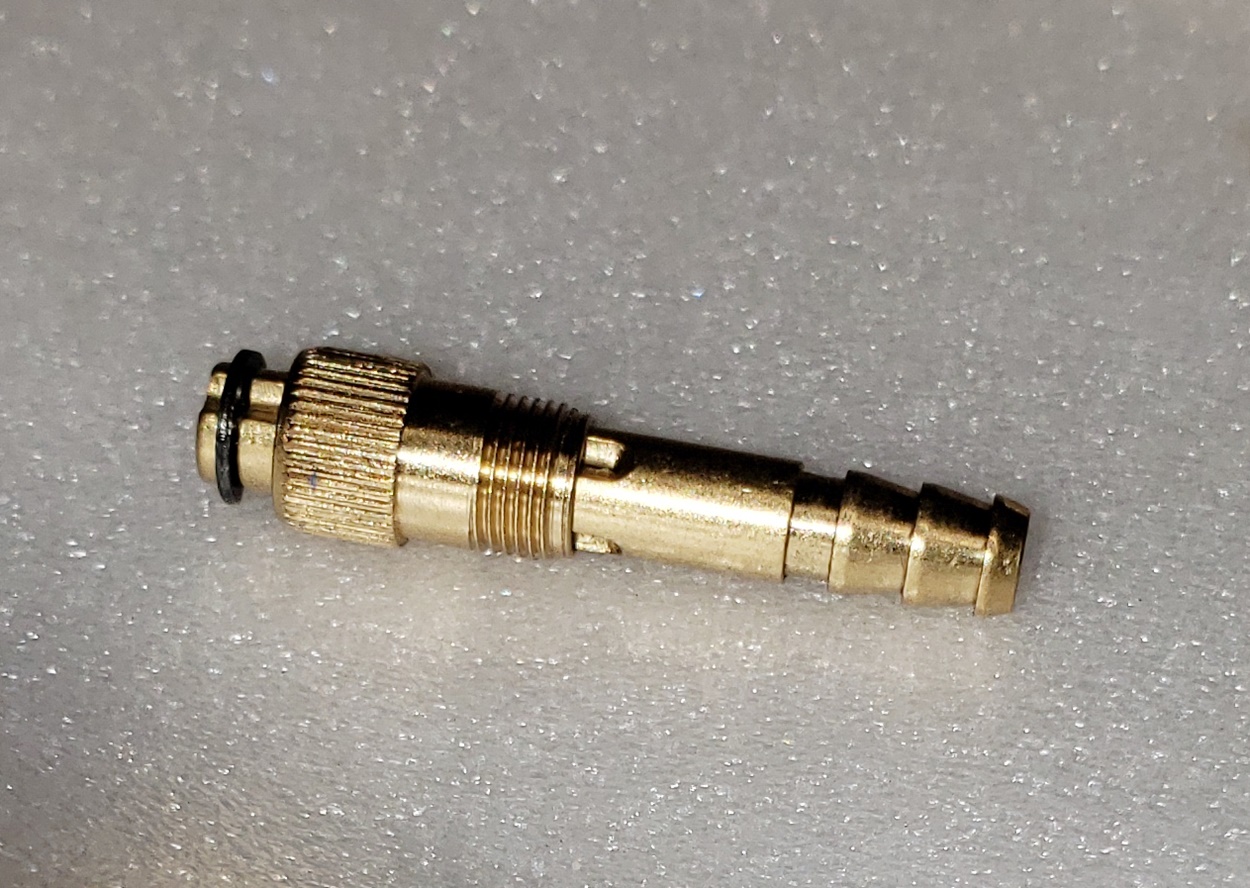

This Slimline Pro EDC kit makes use of the Schmidt SKM-192 click mechanism, which is a much improved and quieter click mechanism.

5. The original Slimline Pro has a 3-piece click mechanism (plus spring) which has to be assembled by the pen-maker;
. . . the new Slimline Pro EDC has 1-piece Schmidt SKM-192 click mechanism (much better)
