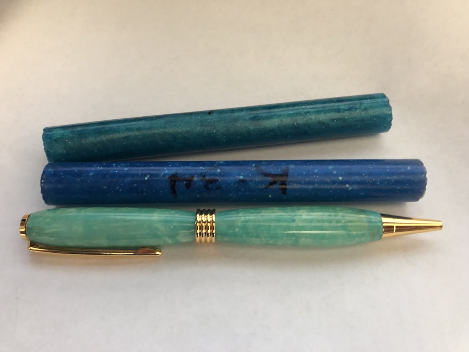

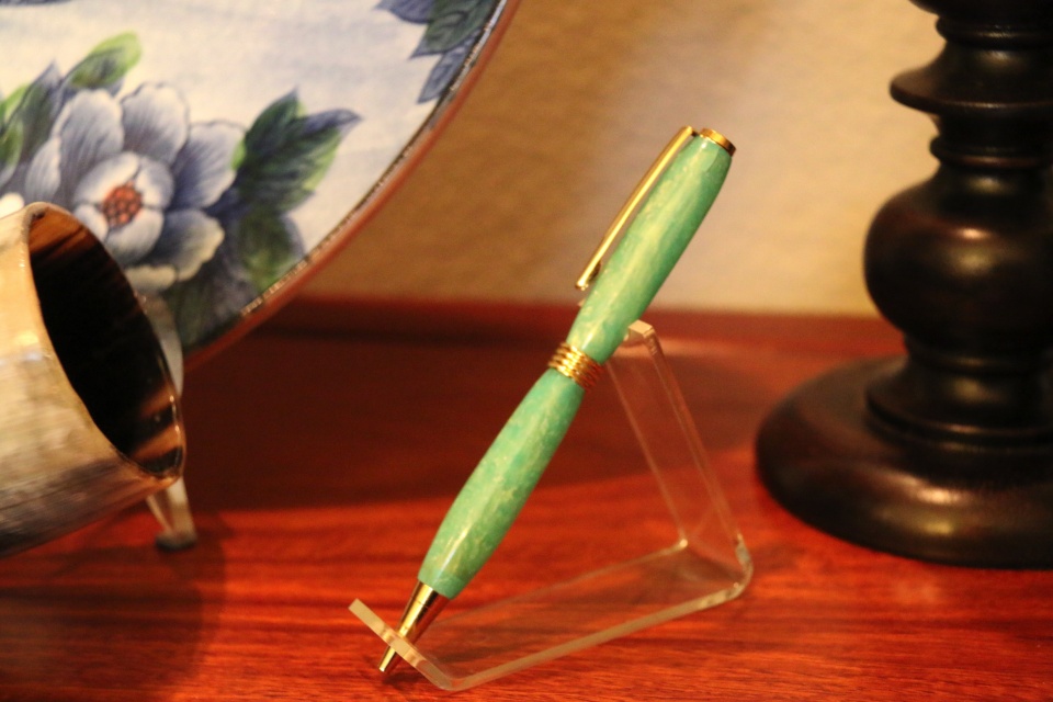

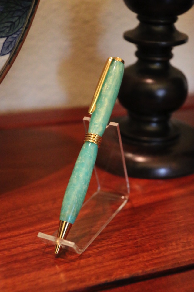

I received a few very small blanks from a friend. I really wasn't sure it they were going to be big enough to make a pen. So, I thru one of them on the lathe and made a Slimline pen.
The photo show how small the blanks were compared to the finished pen.

In the early 1990's, the only available pen kits were slimlines and all the blanks sold for penmaking were 5/8". I don't know of anyone who drilled on the lathe, but it taught me how to use a drillpress much more accurately than I ever had to, previously.
When the cigar pen came out, "standard" size pen blanks changed to 3/4".
I really like the colors of the pens and the blanks, especially the dark blue. I think the lighter colors have sort of an old timey appearance that works well. I turn my slim lines a bit on the thinner side, so I've been using 1/2" pvc molds for single and two color blanks. Way less material to just end up on the floor.
I just went out to the shop and measured one of the blanks. It was just under 9/16", but a little bigger than 1/2" (17/32"). That is the smallest I have ever drilled out.
When I was turning pens way back when (~'05 - '06) the only kits available through Rockler were Slimlines. All the blanks were about 9/16". Barrel trimmers were hand-operated and the only finish available was Wundercote. My how things changed when I wasn't looking.
My wife was watching me turn a Slim Line pen. She wondered why we turned off so much material to make a small pen. I think if I custom cut blanks, I will cut them smaller than
3/4 square. I do turj other styles that would use the 3/4 blank.
Looks like you worked them pretty good! Nice looking! It's amazing what you think won't work and does. I've had a couple times where my blanks were not squared and when I drilled from the center at top, the bottom came out about 1/8" from the side. It's funny though, still had plenty to sand after turning. Lol
