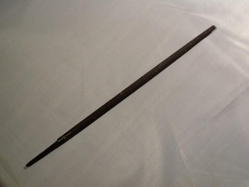

Rat tail rasp
Get yourself a small diameter rat tail rasp. After drilling with 7mm or J size bit a few strokes with the rasp will enlarge the hole slightly, as well as provide additional surface area for glue (whatever you use) to grip. Don't forget to clean out hole after using the rasp. Simple and it works.
