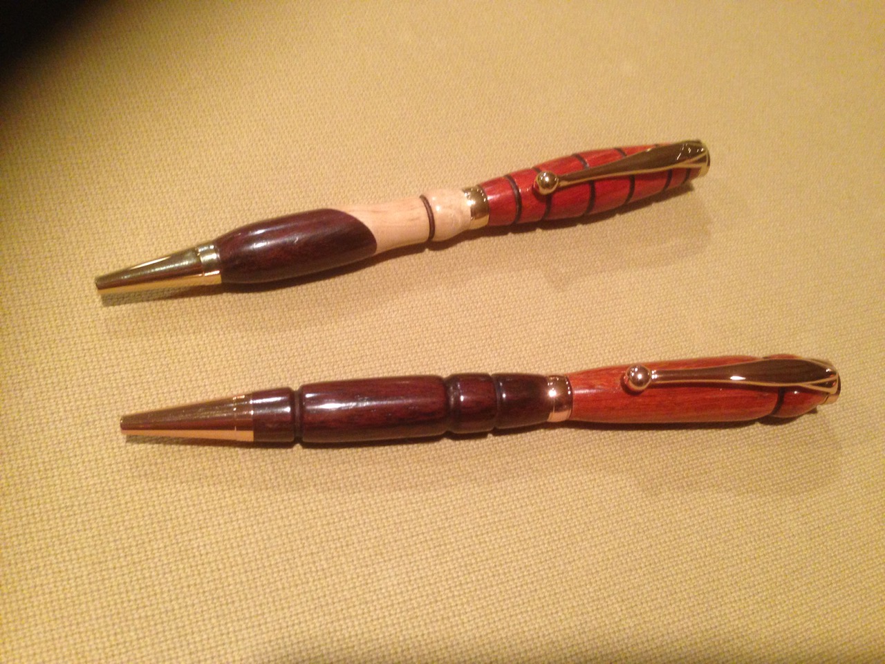

Odd man out, I like them, usually made about 50 to 75 a year. Wood blanks only, turned slim like the Cross pen that they are designed after. One year I made 75 of them for a reunion. The following reunion I made the brass bullet pens using the Slimline basis.

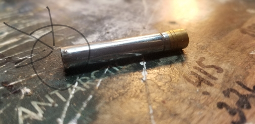

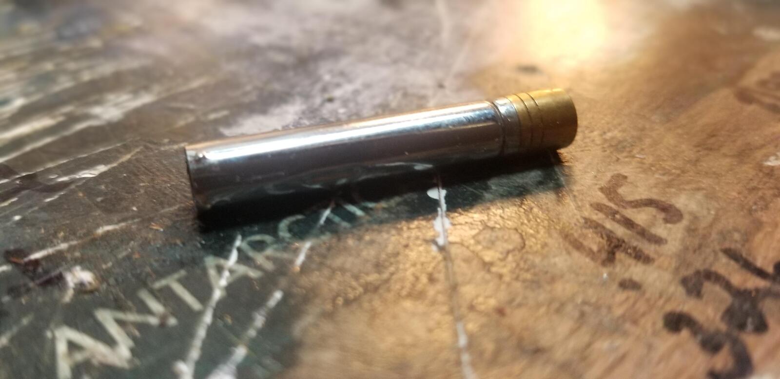

I dimple my transmissions(from the inside) in 3 places around the open end. This makes it a little harder to pull the pen apart but also gives more grip when twisting to open or close.

Ok thanks. I had the same problem today. I think the barrel trimming shaft is killing the brass tube walls. Will replace. It might be distorted. How do you dimple? Dremel with a small ball burr?
I use my smallest transfer punch...twist the transmission like you were extending the refill all the way out. Then I angle my punch in and tap it with my tack hammer. I usually put 3 spaced evenly around the throat of the transmission.

Maybe this will explain. Hope you can tell from my crappy picture.

Thanks. Great tip. I roughed the surface and applied a few dots of CA to add dimension. Dimpling is the fix. I like it.
Edit: pictures are perfect.
