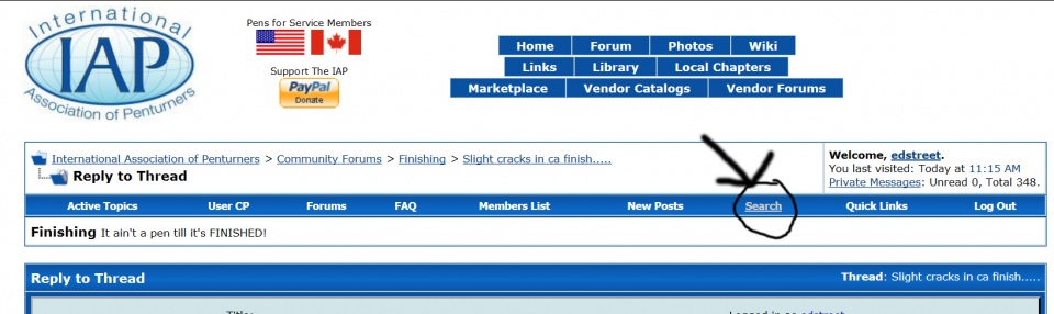

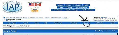

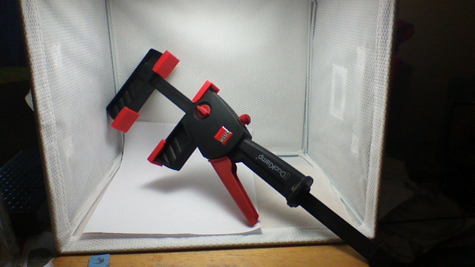

attachment.php
That one link ... yields this, of value.
http://www.penturners.org/forum/f28/ca-finish-issues-117432/
