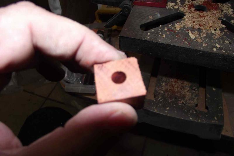

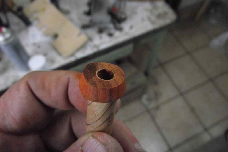

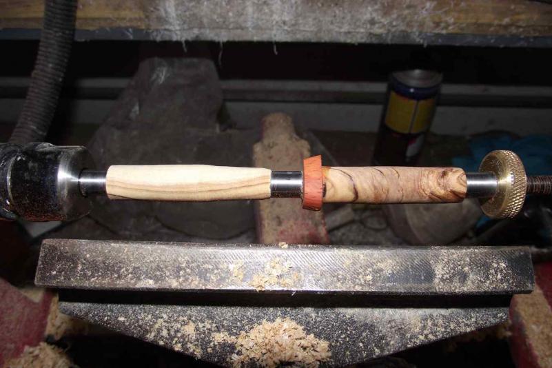

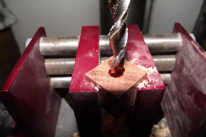

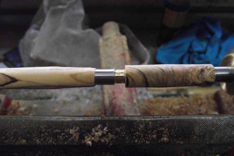

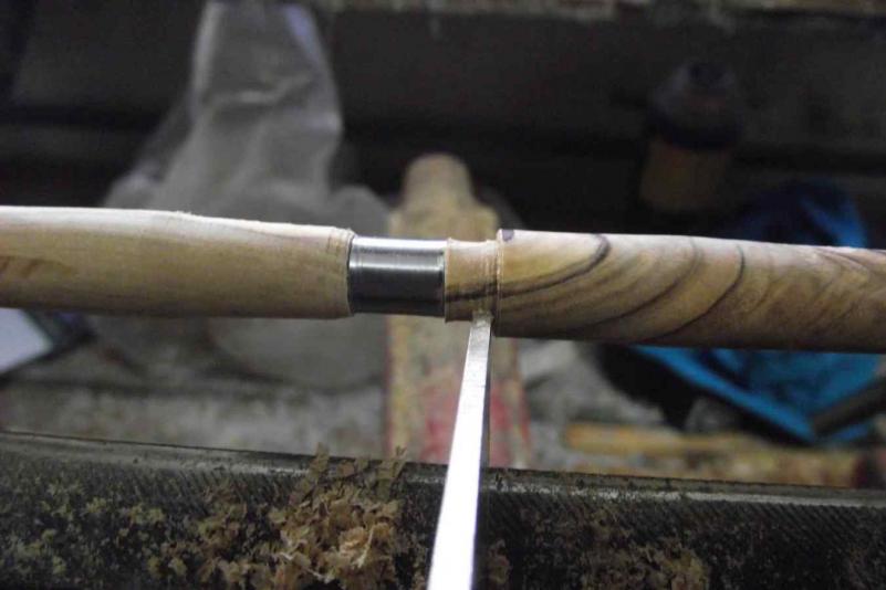

What I do in these cases, I cut a small band where the chip is. Just enough to get rid of the chip. Think making a tenon, but get rid of all the wood down to the tube. Then take a contrasting blank and drill a hole just a bit deeper than the width of your cut. Cut and glue to your blank. Trim and turn to size. You will get a nice looking band.

Pauly99 I have no means to make a video, but I hope these photos are self explanatory. If they aren't, please ask!
I HAD to make this band today because a chip in one of my BOW blanks.
