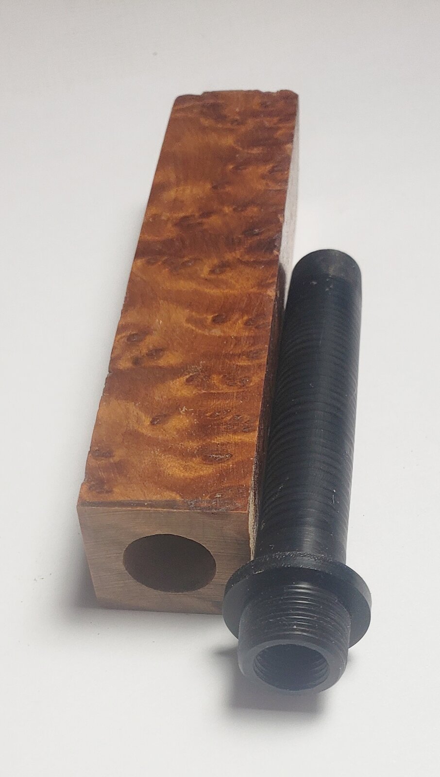

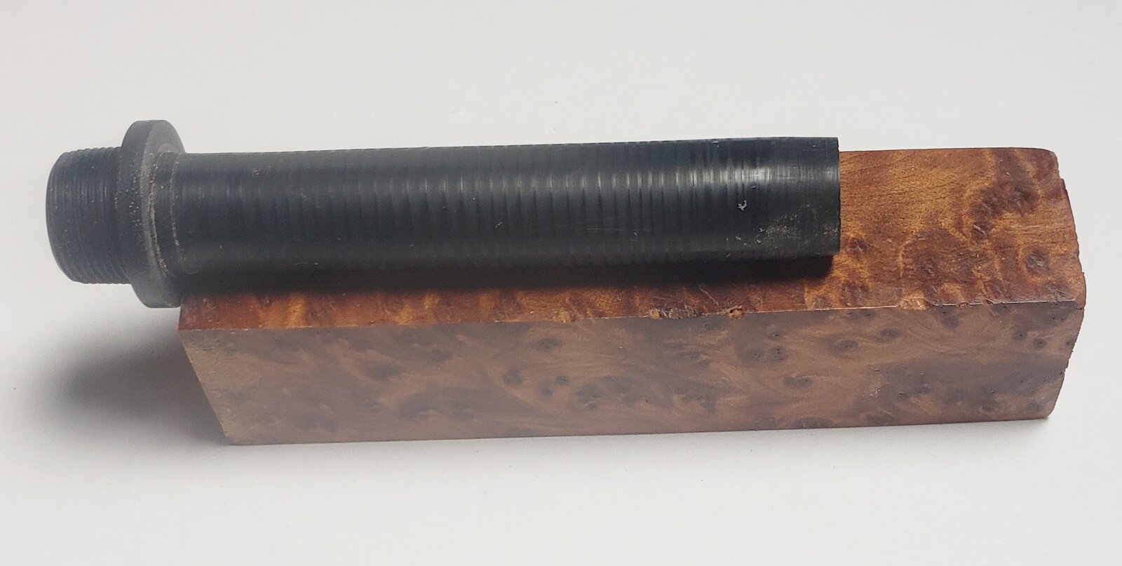

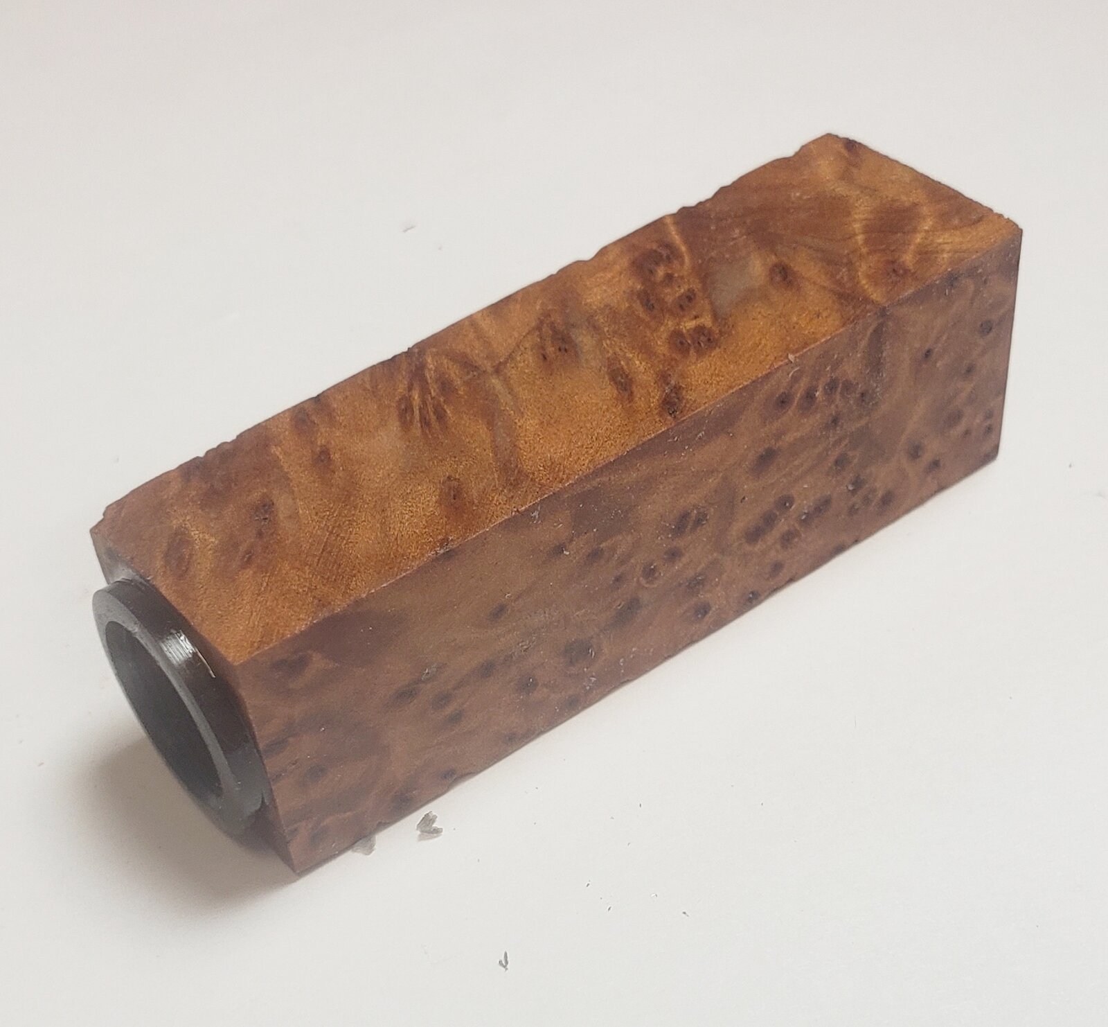

Hello Michael, There are others far more experienced than I here on the IAP, but here is my 2 cents.
I am using a wood lathe, a Jet 1221VS.
I get my ebonite from Vermont Freehand. They aren't in Canada, they are in Vermont USA.
I like the ebonite because I like how it machines. It is smelly when turning (sulpher) but that goes away eventually for the finished product.
