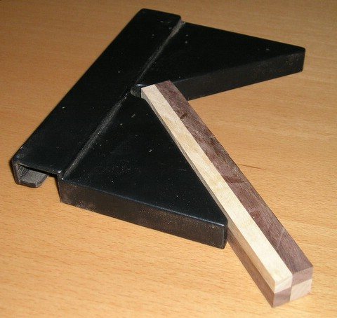

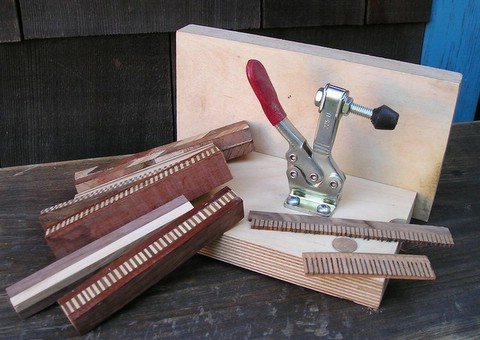

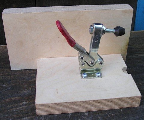

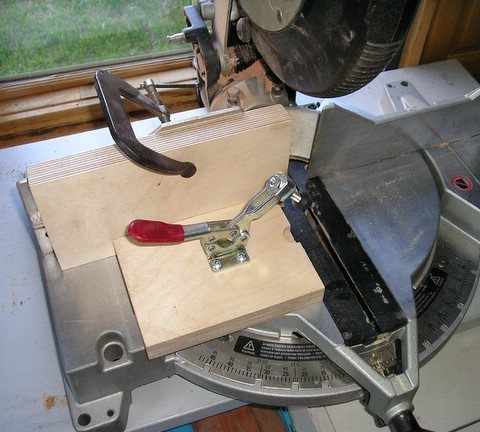

As promised, these are the sleds/jig that I use to make segmented cuts SAFELY. The one jig (wood w/ toggle clamp) is used exclusively with the mitre saw. The black plastic jig is intended to be used for the band saw and rides along the saw's fence.

Thanks for posting the pics. I can't quite see how the bandsaw sled would orient on the table. Does the left side mate with something that rides in the miter slot? Just curious.
I won't add to the diatribe in the posts above but I for one will not cut pen blanks segmented or not if my fingers are involved. If I can't clamp something to my Miter Saw and cut it with BOTH hands free I won't cut it. On my bandsaw the same applies to a point. And, I don't have a table saw yet.
I do this for two 4 reasons. The first three reasons are the 3 fingers my brother lost long ago when a Circular Saw jumped on him. The other reason is that I sit in a wheelchair which would obvioulsy affect the ability to turn away...move...get the heck out of the way etc...
Thank you for the pics by the way...it gave me some ideas. I just need to understand that bandsaw slide better. Seems to be made of metal? What did it come from?

Ken, the black jig is made out of plastic but it could very well be easily made with woodscraps. The jig rides along the wall of the fence, either to the left/right. If still unclear, I can post another pic with the bandsaw and bandsaw fence. It does not 'ride' in the slot but rather slides on the wall(fence).
