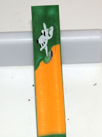

I was never able to join in on the fun of Skippy's World Tour because I just don't know about graphics software. So, I am taking on the challenge in a totally different way. I just pulled this blank out from the final pour. It took several pours and although some of what is in the blank is still hidden below layers of resin, this gives ya'll a fun peak at a pen in progress. There is actually 20 pieces just in the head of the rat alone. Hopefully once it's turned he will be emerging from a holey block of cheddar. Been wanting to try this for the longest time, but it took me to now to find some spare time to do so. Perhaps this will be Wisconsin Steve. :biggrin:

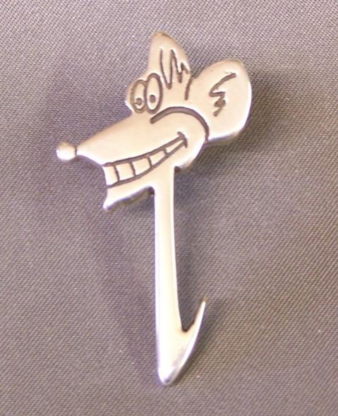

LOL!!! If you make a pen out of that, then I'm gonna have to commission you to make another one!!! My ego is alive and kicking and my good buddy Mr Bruce Robbins even made a Stirling Silver clip for me. Up till now, I've used it as a lapel badge for the rare occassion that I wear a suit, but you have to admit that with a blank like that, combined with his clip, then it would REALLY make my head big!!!:biggrin:

There be whiskers, but they are not visible yet. There are several things on the blank that can't be seen because they are covered over with resin.
I think that clip is great and I've seen it before but I think it is too much to have two skippy's on one pen.

I gotta fix that eyeball too..the black is not equal on both eyes....no big problem. The eyes and mouth were quite a challenge..heck the pupils are probably 1/16x3/16

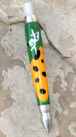

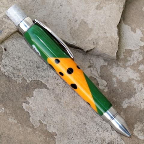

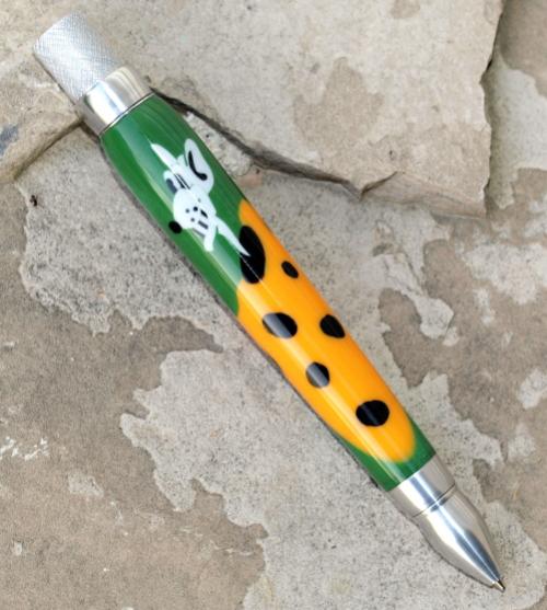

Part 2....my Skippy Pen! :laugh::laugh::laugh:
I was able to spin some guts and drill and mount the blank yesterday afternoon, then finish the pen this morning. I absolutely love it. Makes me smile ear to ear to have pulled it off like this! I love the shape, proportions and weight. I am not crazy about the girth aspect of the pen though. It is just a little bulky for my average sized hands, but the Rat is 7/16 wide, which is 1/16 wider than I would normally dare to go, yet I could not get him to be any smaller with that many pieces in him. I was really pushing it close to overspinning him. Fortunately I nailed the drill hole dead center. I wouldn't use a pen like this as a daily writer anyhow..it's just an ego showpiece. :biggrin:
Hope you guys find this as funny as I do!
This pen is Alumilite, Aluminum, Parker refill with double twist tranny and finial activated, Jr Gent clip, threaded nib to change refill. All segmentation and pentarsia completed using a scroll saw.

Jeff, you just seem to get better and better!!!!:eek: That is crazy cool!!!!!.:biggrin:
Mmmmmm....I think I'm gonna have to dream up a stainless steel scrolled nut and bolt pen to try and persuade you to trade:rolleyes::tongue:

That's cool but not really necessary Steve. I just wanted to do it to see if I could and because the idea of it seemed really funny to me. I do love joking around! I sent you an extra blank, I mixed extra resin when I poured that batch so you would have an extra one of just the same color swirl in case you needed some more length for anything out of the ordinary like a closed end or whatever. It would be real nice if you would take one of your nice quality pictures of the Skippy pen for me.
Thanks for the great feedback guys! We're all kids till we die.

Of course, I'll post a pic but your's looks pretty good to me.
