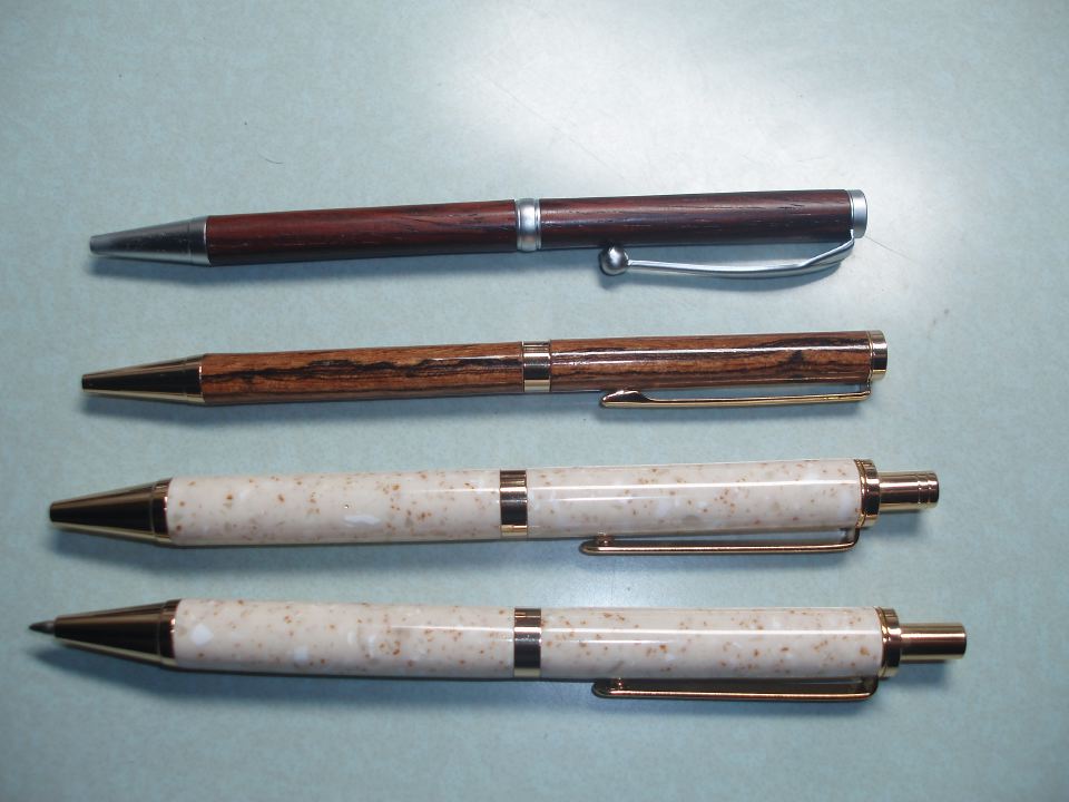

penicillin
Feb 27, 2019
1,036
I like the Slimline Pro. I am not sure that it is the "thinnest" but it should be close. It uses the same "O" = 8mm drill as the American Double Twist pen above. You can get them at Rockler or Penn State. Penn State has the matching pencil kits. It comes in multiple finishes:
Notes:
* It is a click pen, not a twist pen.
* Some people do not like the click mechanism that comes with these pens, but I like them just fine.
* It comes with a Parker-size gel ink refill.
https://www.rockler.com/slimline-pro-gel-click-pen-hardware-kit-24k-gold
https://www.pennstateind.com/store/PK-PENXX.html
https://www.pennstateind.com/store/PK-PCLXX.html
Photo: Slimline pens in cocobolo and bocote, plus a Slimline Pro pen and pencil set in Kryptonite Glow Stonez. The Slimline pens are rejects destined for donation to the local public library. The Slimline Pro set is my favorite personal set at my desk. I use it every day. I like thin straight pens, but my friends tease me about it. I make shaped curvy pens once in a while, just to shut up my friends.
