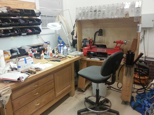

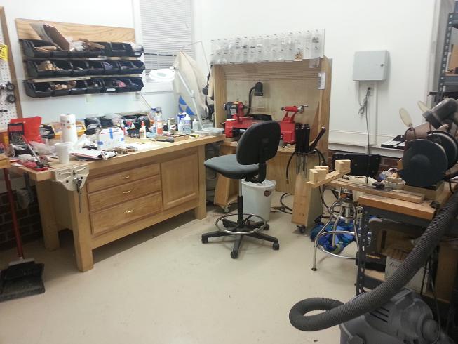

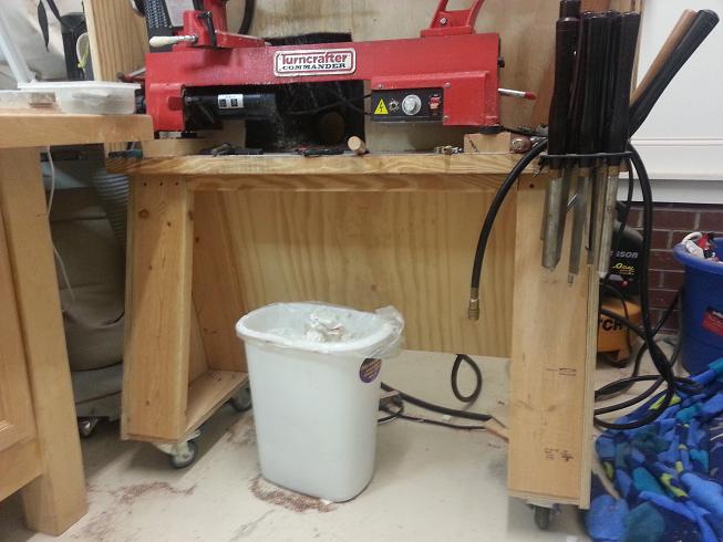

Carmen, I just built mine out of 2x's and put it on wheels. I made the rest of my worktables at the same height and I use a roll around chair to do my turning, drilling and cutting. Not much but it works for me.

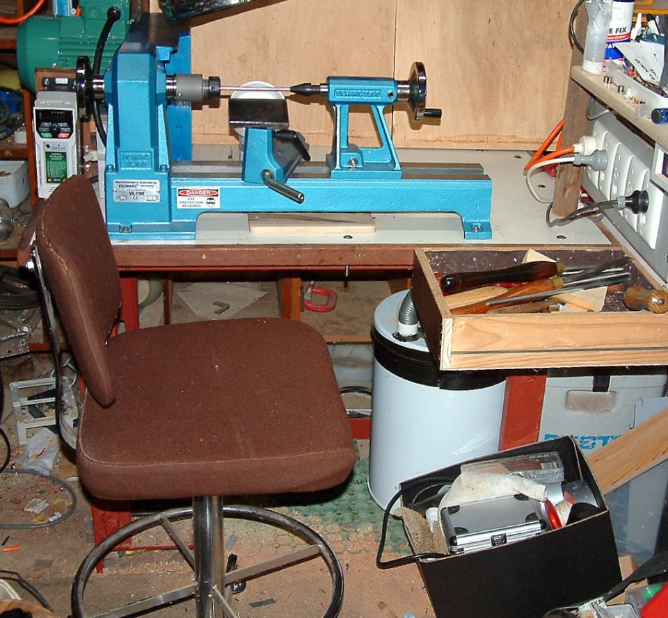

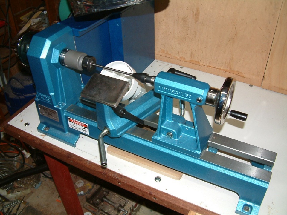

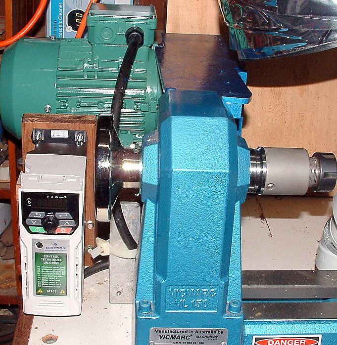

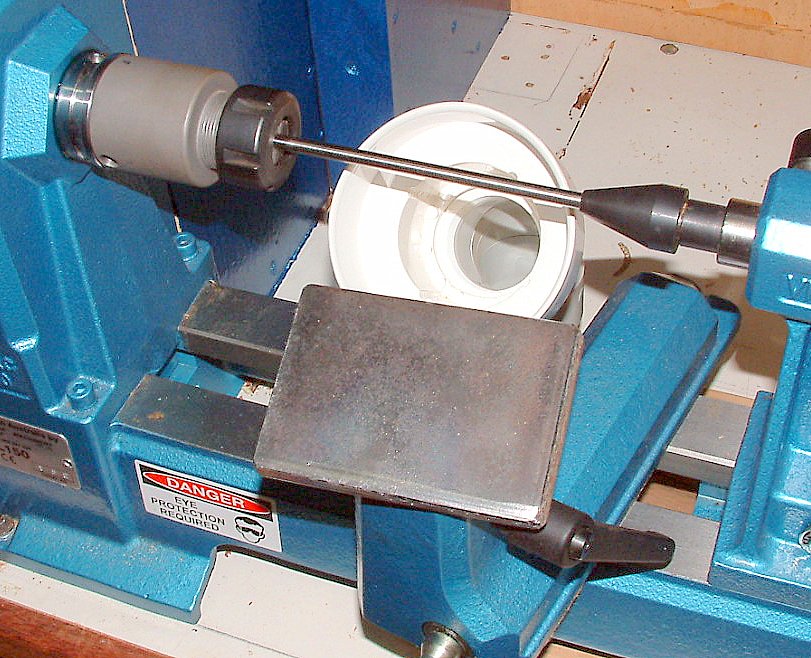

Hi Carmen, My wife is 5 1 1/2 I am 6 2. So our heights you and me are different.

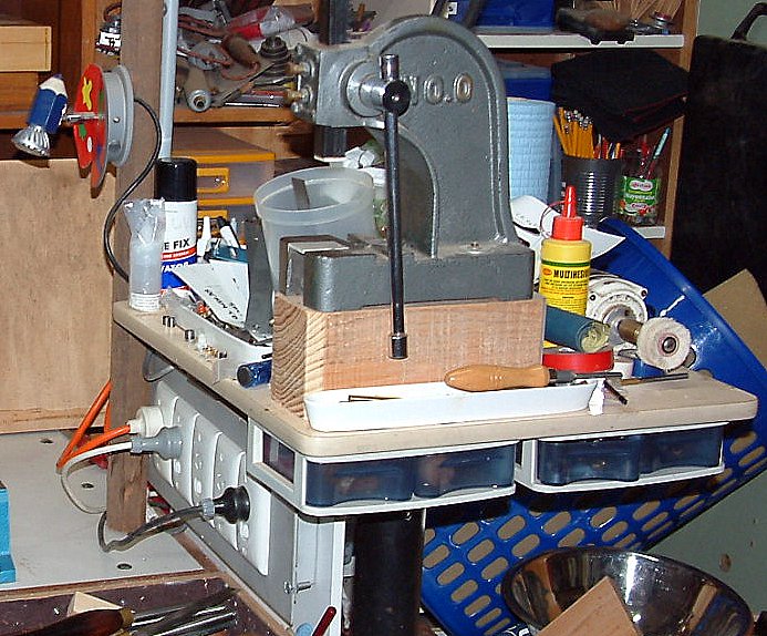

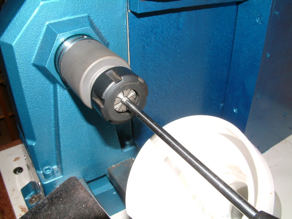

I turn sitting down seated at a draughtsmans swivel stool with arms. I welded the lathe table put 1 1/4 inch reject top sheet with laminate on top. I use a Vic Marc vL150,previously and I still use the VL100 on this same bench moved to behind where I sit.
I built a stand for the bearing press I use to press my pens that sits at eye height.In other words I sit to turn and finish my pens.I can turn all day in comfort,sitting higher than the lathe. I diverted the drive through the back of the head stock to give me free space under the bench (table).
Cumbersome angled lathes are never for me,stick with a conventional lathe. Please see some pics when I was installing the VL150.
Some additional helps for me I made a 45 degree pen rest and I use it to the max it holds the chisels at the right angle for me.
I had a beaut friend who bought a large lathe ,he is wheelchair bound ,cost him a fortune for the angled stand etc,I would not swap him for my set up. This is my 85th year and I can stand but love being seated for twenty years now for penturning.PS I took the arms off the chair.
All the best Peter AKA PenPal.

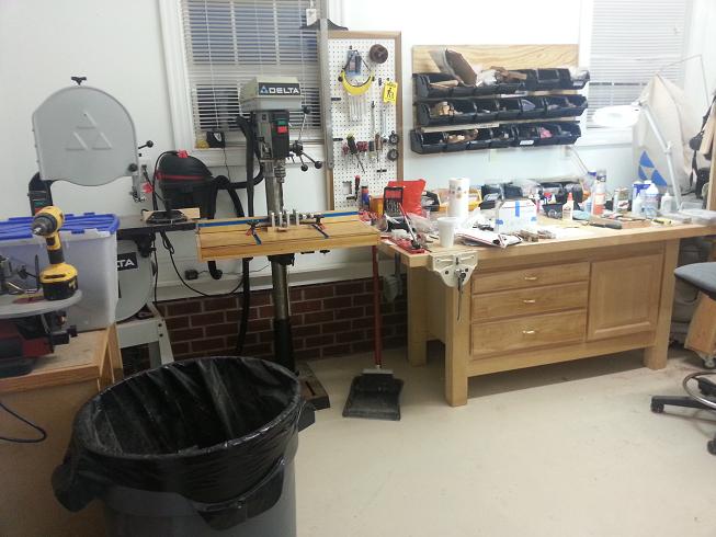

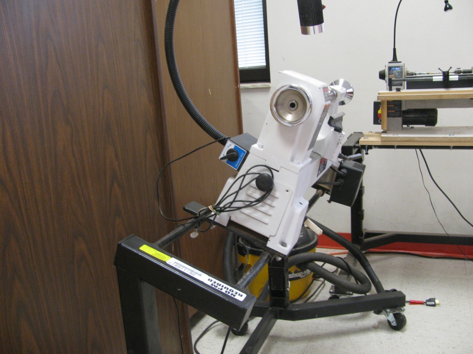

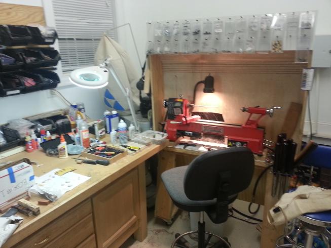

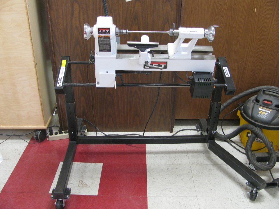

Here are a couple of photos of a sit down lathe in use at the VA Hospital in North Little Rock, AR. They started a pen turning program a few years ago and now have about a half dozen lathes that can be used while seated in a wheel chair. The stands were custom made for the hospital and the fellow that made them has since passed away. Might be an idea or two in those photos.
