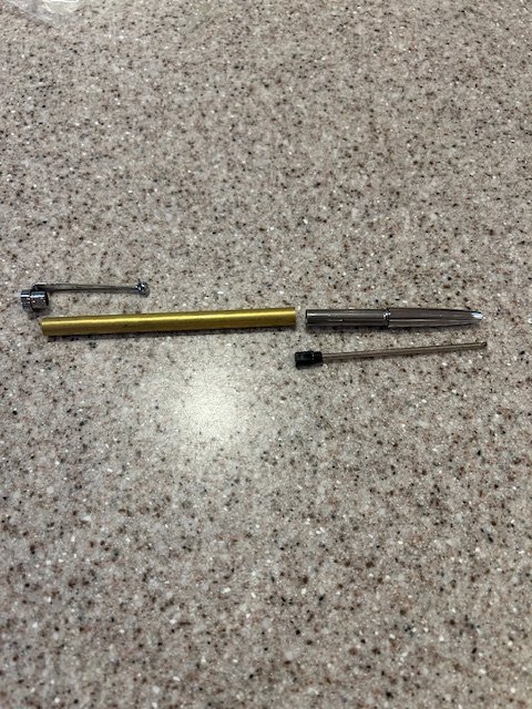

C CGrant Member Joined May 14, 2024 Messages 23 Location Santa Fe Apr 19, 2026 #1 Any idea what kit this is? The tube is 7mm and 3 9/16" long. Who makes the refill? Attachments IMG_3801.jpeg 110.9 KB · Views: 185
jttheclockman Member Joined Feb 22, 2005 Messages 20,590 Location NJ, USA. Apr 19, 2026 #2 It looks like the old version of either PSI slimline single tube kit or the Bera/ woodcraft slimline single barrel kit
Loucurr Member Joined Feb 15, 2016 Messages 377 Location SW Florida Apr 20, 2026 #3 As shown in the kit, it takes the mini refill that is used in credit card pen kits. https://www.turnerswarehouse.com/products/mini-ballpoint-ink-refills?_pos=8&_sid=214322153&_ss=r
