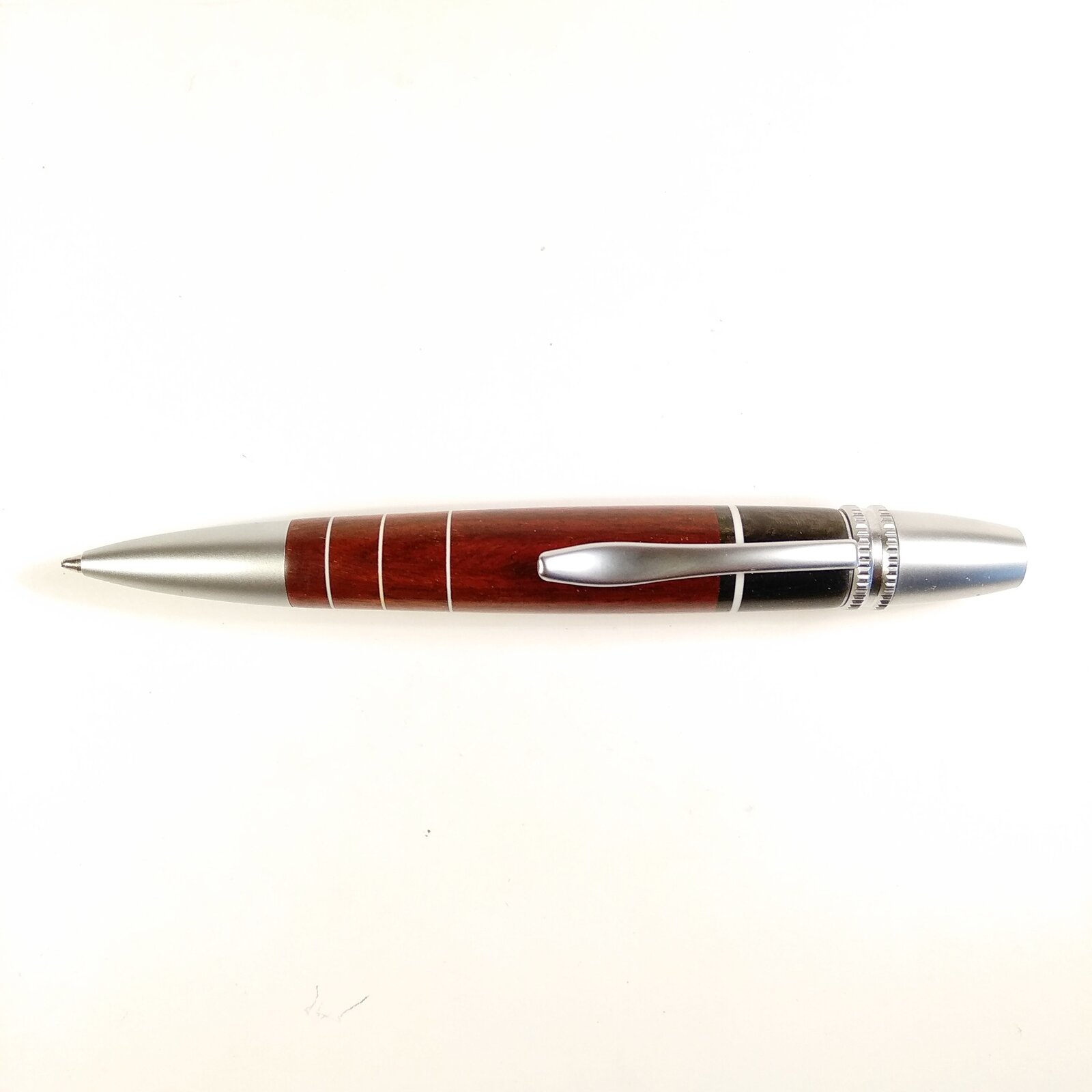

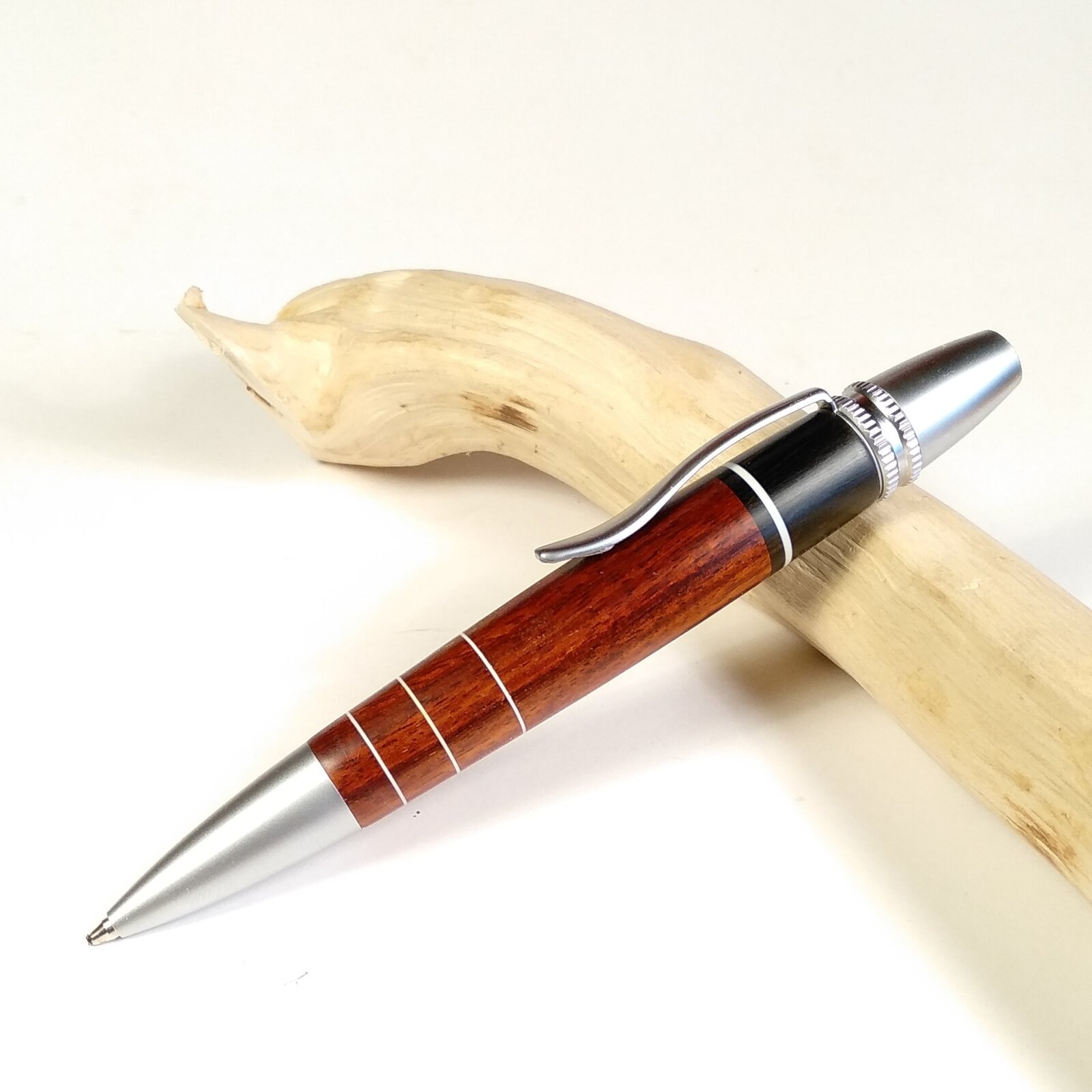

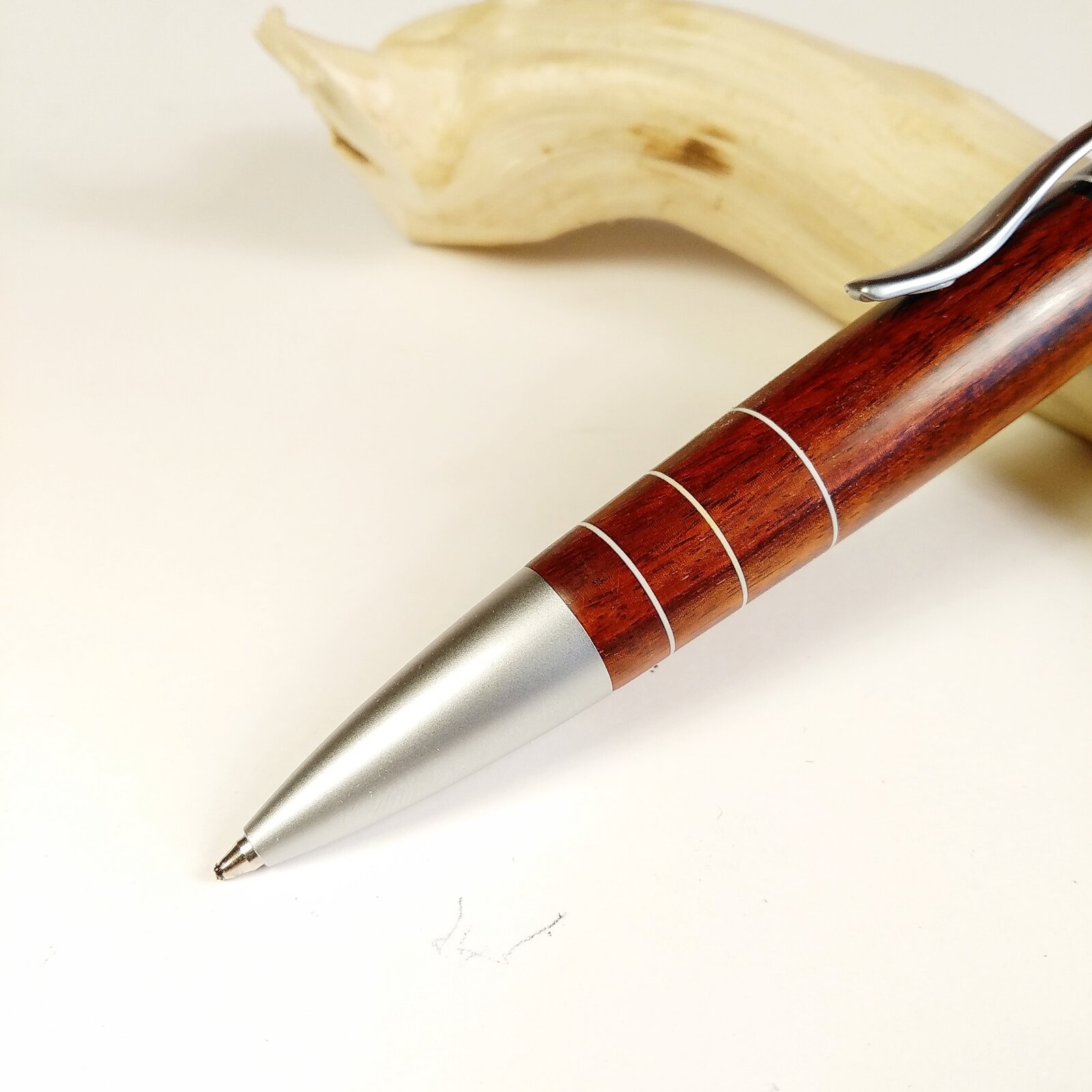

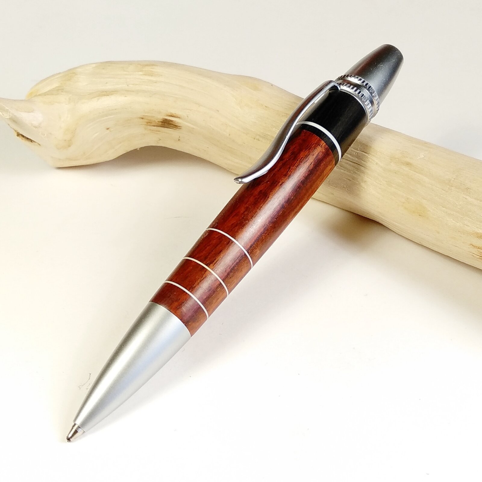

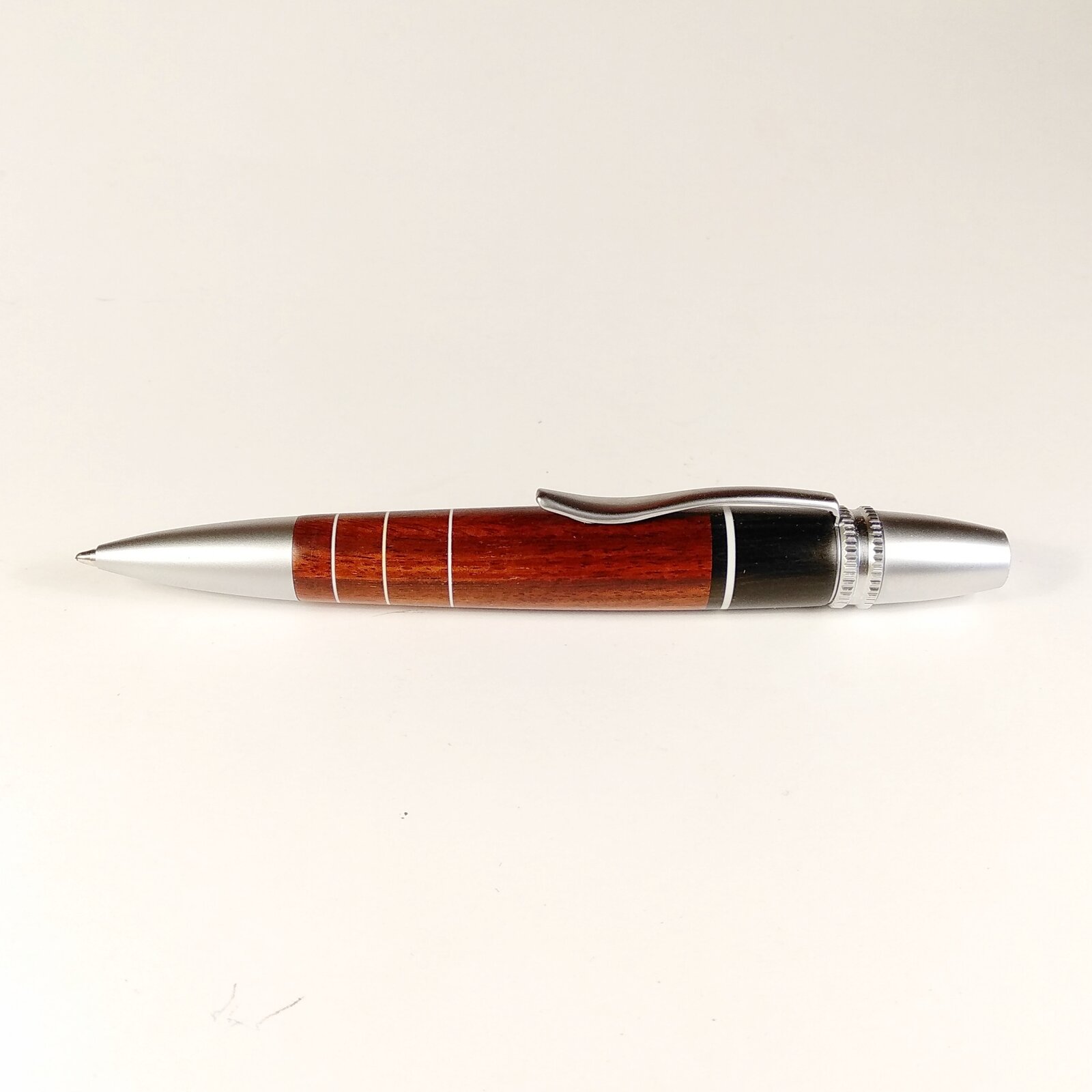

Hi all,
I'd like to share my latest pen: made of swartzia and ebony wood with white styrene ring accents.
Requested by the customer I did a matt CA finish. As for the glossy finish, I applied several coats of CA, then sanded with 320/400 grit to flatten the surface: then again CA to fill small gaps, if any, and then up to 3000 grit. Then I polished with oil and tripoli powder. At this point, instead of buffing I went back by sanding with 3000 grit, down to 2500 and so on, stopping once I joined the desired matt finish. The last sanding has been done without the blank turning, but very lightly along the wood grain to avoid micro scratches.
Hope you like.

The spacing of the white rings does not apply to the whole barrel length since I planned to insert them only where placing the fingers when holding the pen. I first set the position of the ring closest to the nib, then, according to the rule of the golden section, i set the position of the second and with the same approach the third. Of course with so small surface to work on there are some approximations.
To be able to be more accurate I chose the swartzia blank slightly larger then 20x20mm so to insert the white styrene pieces just cutting 3 scarfs without separating completely the wood; it also helped to keep the grain of wood perfectly aligned.
