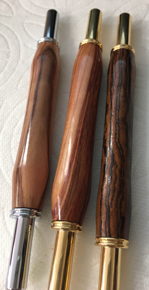

The photo shows the shine of two smooth wood and one open pore bocote seam rippers.

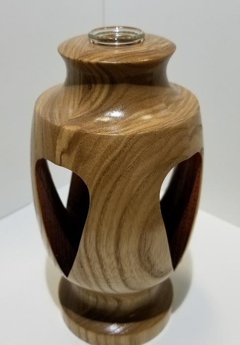

First attempt was this little bud vase, I used 2000grit between coats, got about 6 to 8 coats and it is hard like CA without the mess, fumes, and glued fingers. If you keep the coats thin it dries in about 2 minutes between coats.

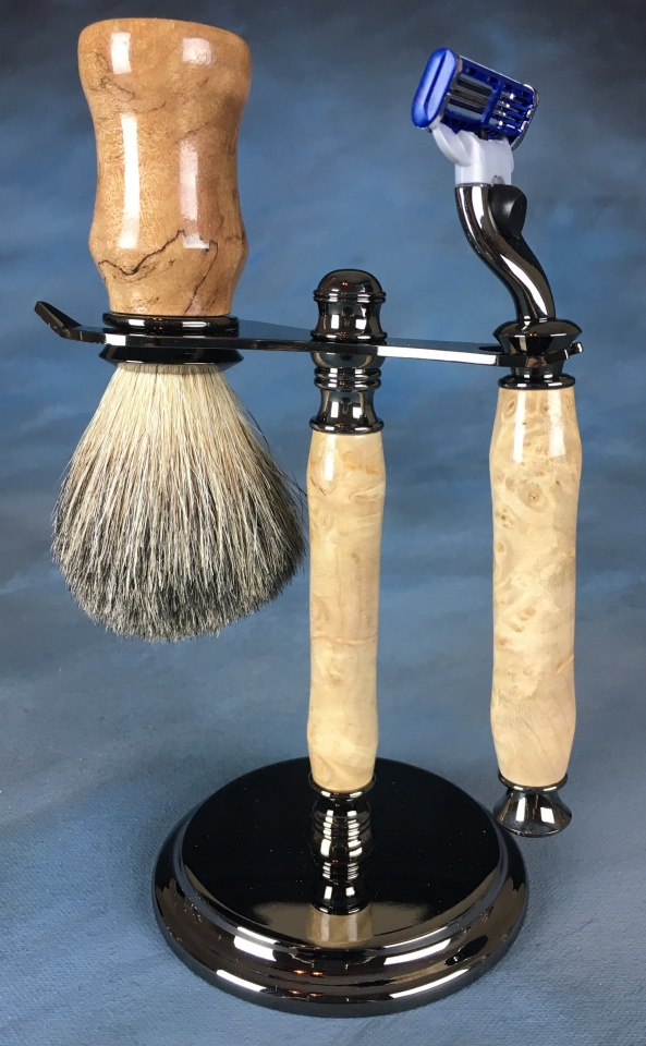

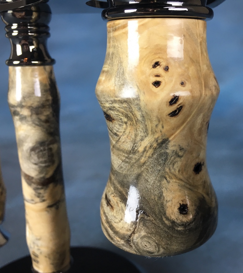

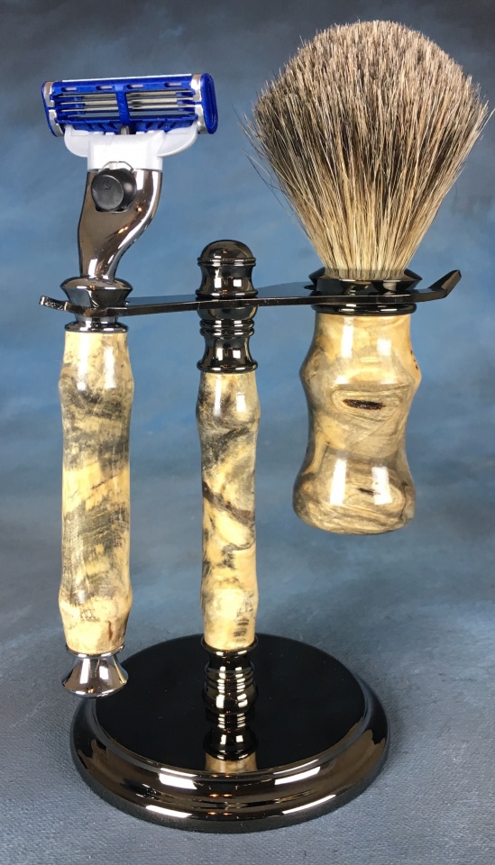

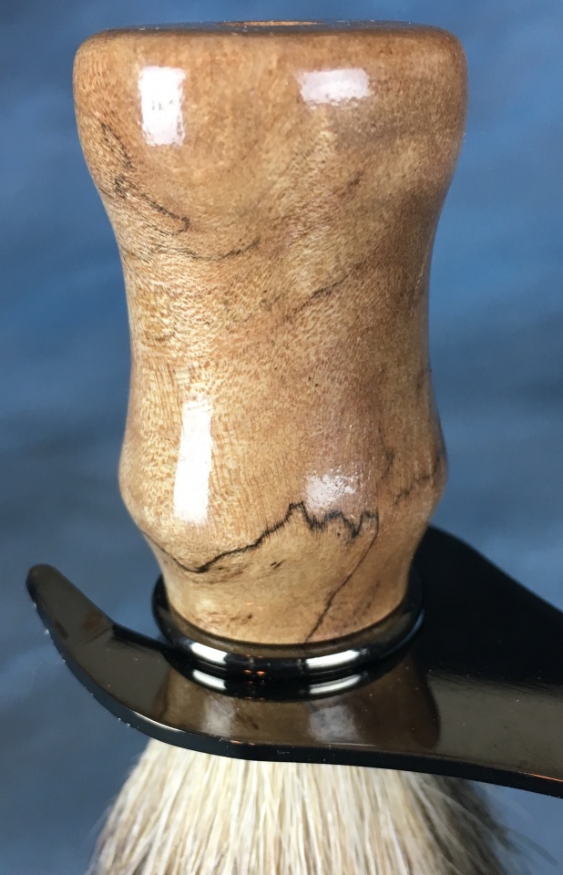

The shave set above is all stabilized with stick fast stabilization method. It turned very well and was very quick to show a shine with General Finishes WTF. For me it was easy with no dull spots. I guess I wish all wood I turned was stabilized. I let each coat of WTF dry for 2-5 minutes before sanding or applying the next coat. Some are faster than me.

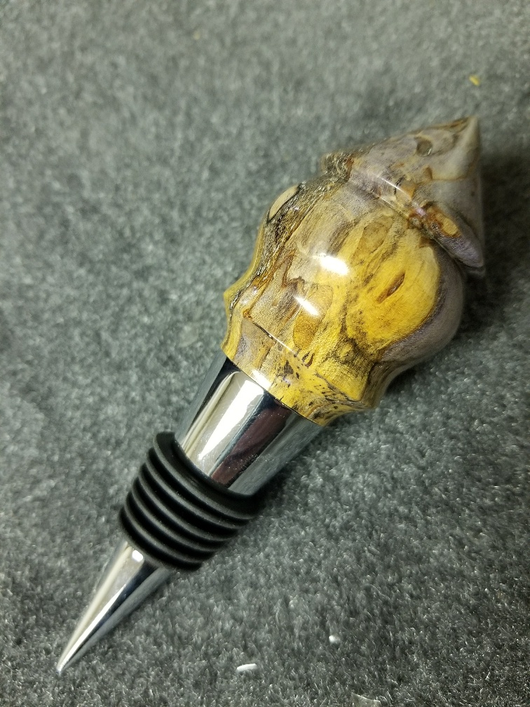

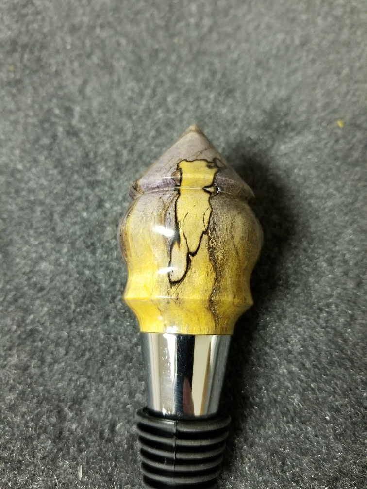

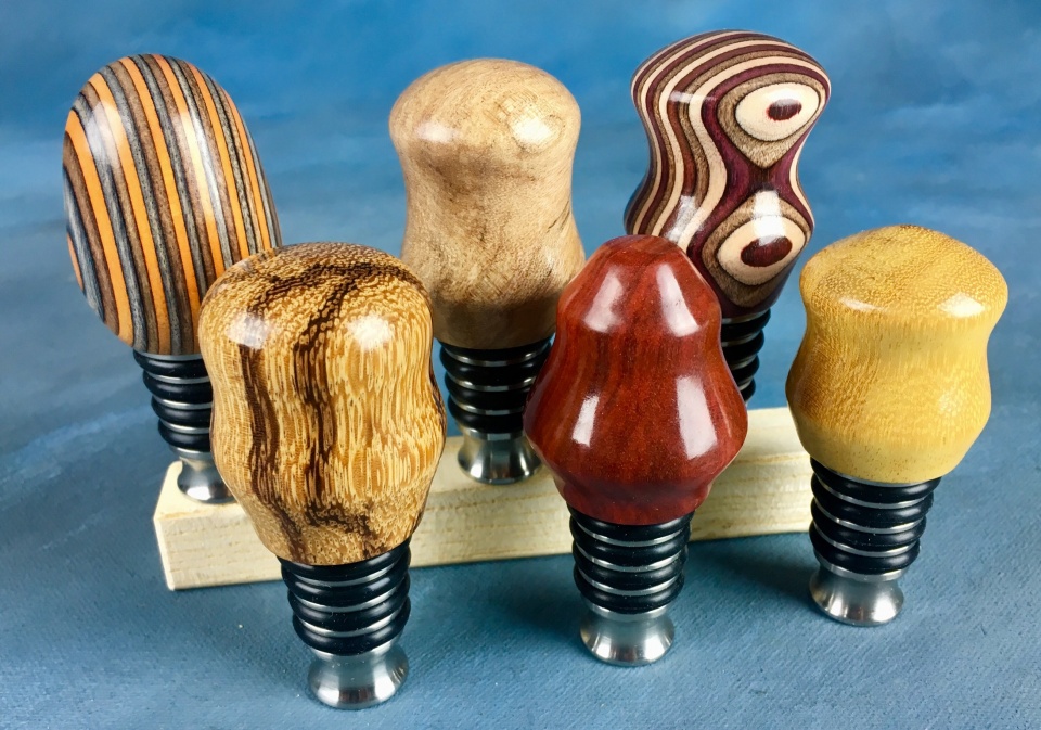

Here are some freshly finished bottle stoppers. Six coats of General Finishes Wood Turner's Finish. Very smooth and glossy after buffing.

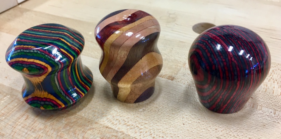

It could be the photographer (me), but when I brought that red one into put it on display today it sold in seconds the one on the left a minute later. They were all smooth and glossy everywhere. I left them overnight to dry and gently sanded them with 1200 grit and polished with all three buff on a Bealle System.

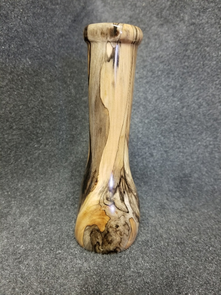

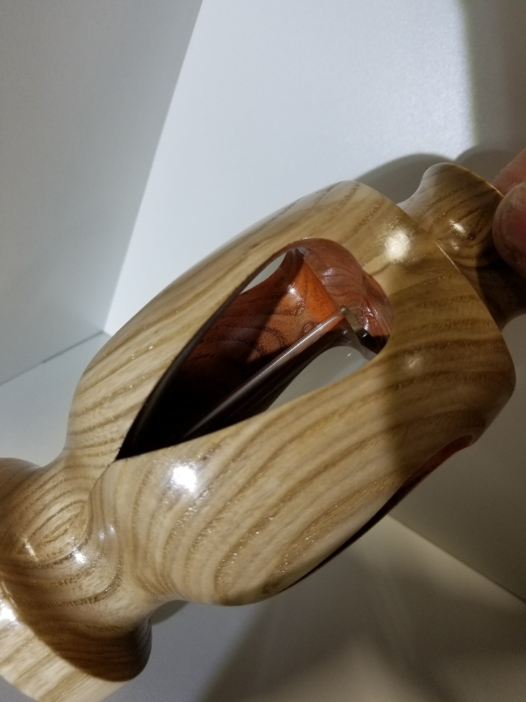

I like how CA gives a glass "feel" for somethings, but in some cases I want to still be able to feel the grain in wood. Here is a small bud vase I did for my sisters Christmas present. 5 coats of WTF, no polish. It would probably shine up even more if I polished it.
