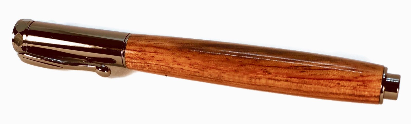

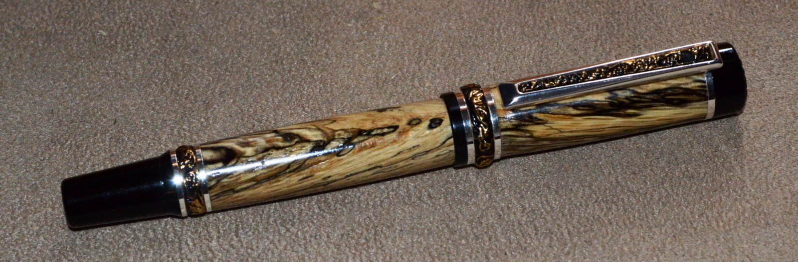

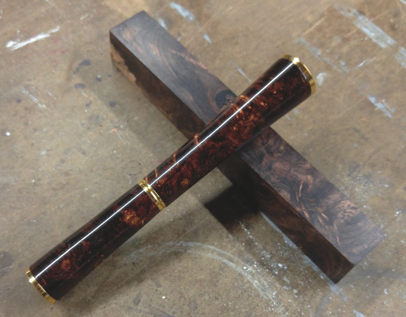

I purchased a few blanks of Honduras Rosewood burl (for exorbitant price) and wasn't all the thrilled with the outcome. I'd rather take a nice piece of Spalted Tiger Oak or Box Elder Burl any day.
One of the great things about turning pens is that the final product reflects the one who turned it. Me, I love rosewood and have a goodly hord of African rosewood pen blanks. My plans for those are that they will all be made with silver finish, but more importantly with Berea Hardwoods silver because it has been my experience that their silver is the best silver plate available. Don't know if BHW makes any silver single tube kits. If not I would look at their chrome kits for the same reason. Of course in the final analysis it is your decision; I'm just tossing out a few options.

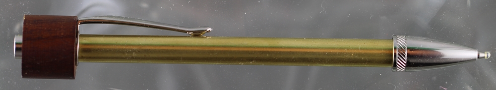

Well, if you don't like the height of the shroud around the push button, then you can modify your pen's design a little bit to hide the shroud.

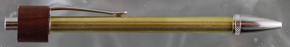

I did a quick experiment on doing this and here are a couple of photographs of one possibility. . Absolutely no dimensions of anything have been altered and all the Berea instructions can be followed to a T. . All I did was make a little block that would fit on the top of your usual blank.
This block can be shaped in any way you like to integrate it with the main part of the blank. . All I have done is drilled some holes to allow the block to slip over the top-end hardware as snugly as possible and then trimmed the block to length so that it would butt up exactly to your main blank. . Of course, you may want to recess the seat for the clip ring to complete the integration of the two pieces of the blank. . Or you may want to do some segmenting to make a feature of the block. . The holes that I drilled are sized: letter-M, letter-S, and 11 mm. . The letter-M just allows the pushbutton to poke through the top (I didn't think it was worth an extra pic of this. . The button JUST fits through and operates smoothly.). . . . . . . The 11 mm is a snug fit over the top-end hardware piece but it is quite easily removable. . I'll leave it to you to work out the 3 hole depths to suit your purposes. . Full kit details, photos of the parts, and instructions are on the BereaHardwoods.com website .... search for the Blade pen kit.
The block can be glued in place, attaching permanently to the main blank and, if desired, to the clip and the top hardware piece (but not to the button) and no function of the pen is compromised. . Refill replacement is by unscrewing the nib, fully complying with the original kit design.
The two pics show the position of the button for both the extended and retracted positions of the refill.
The remaining aesthetics are entirely up to your creativity. . Of course, every kit has its compromises and this one is no exception.

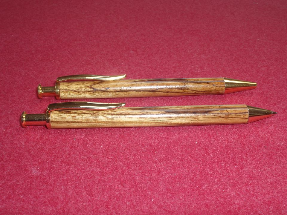

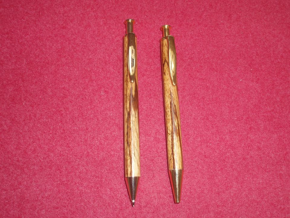

I buy nearly all of my pen kits at the local Rockler store. When Rockler doesn't carry what I want, I order from Penn State. I have not tried other sources. Rockler gets its pen kits from multiple sources. Many (most?) are from Penn State or Rizheng.

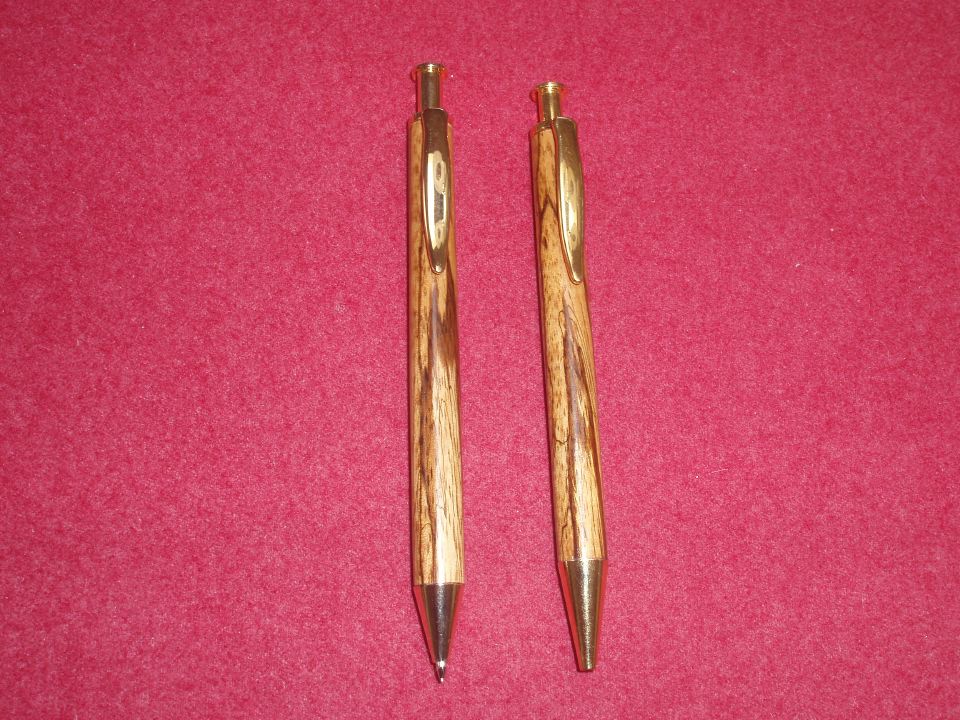

Two of my favorite kits at Rockler are the Long Wood pen and pencil kits. The wood on the pen and pencil is over four inches long. There are two issues:
* The pen click mechanism is loud and firm to push.
* You must match the pen tip to the wood perfectly. It is touchy that way.
https://www.rockler.com/long-wood-click-pen-hardware-kit-gold
https://www.rockler.com/longwood-click-pencil-hardware-kit
(Another favorite pen of mine is the Slimline Pro pen and pencil kits. You can't get the pencil kit at Rockler, only Penn State. The pen mechanism is quieter than the Long Wood pen mechanism.)
https://www.rockler.com/slimline-pro-gel-click-pen-hardware-kit-24k-gold
https://www.pennstateind.com/store/PK-PCLXX.html
Photos:
Long Wood pen and pencil set in zebrawood. Two views.

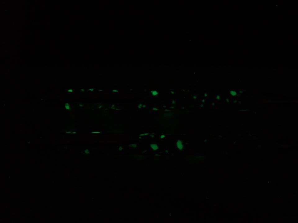

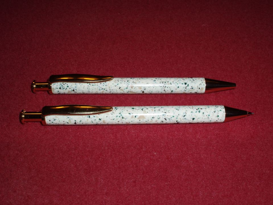

Long Wood pen and pencil set in Asteroid Glow Stonez. Two views: Light and glow-in-the-dark.
Long Wood Zebrawood Pen Pencil 1.JPG Long Wood Zebrawood Pen Pencil 2.JPG Long Wood Asteroid Pen Pencil Set Light.JPG Long Wood Asteroid Pen Pencil Set Dark.JPG
