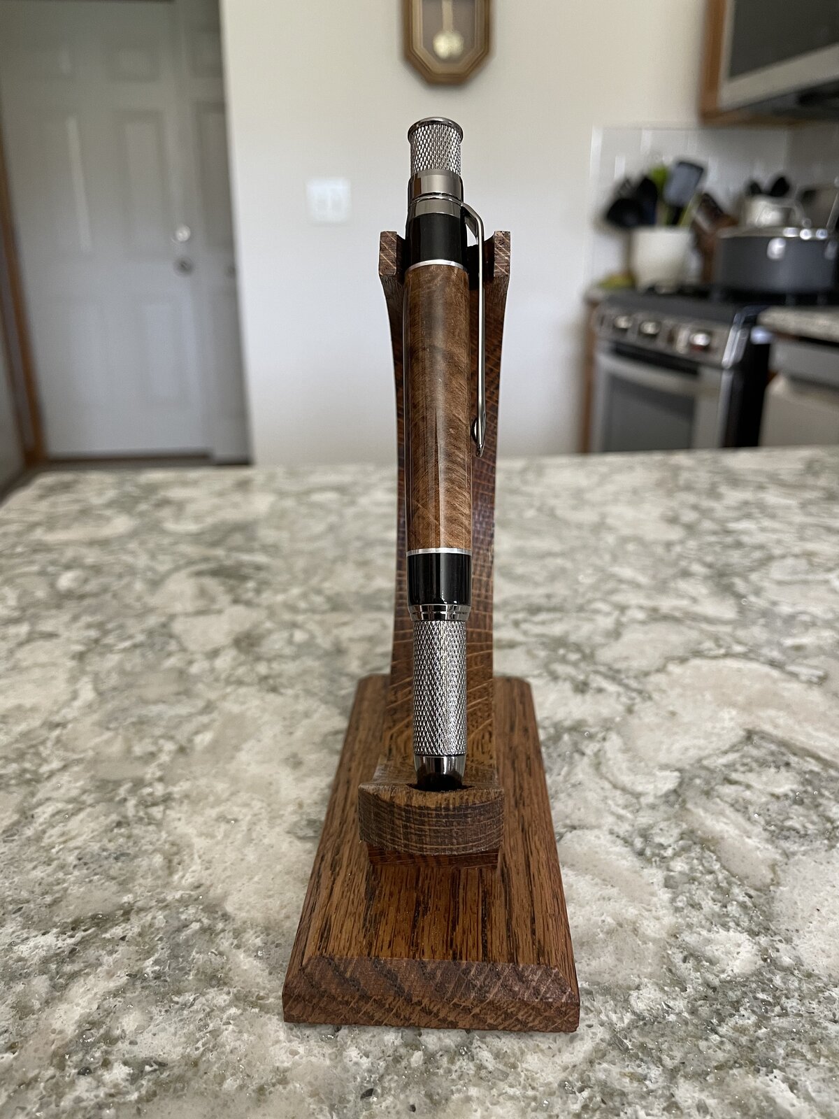

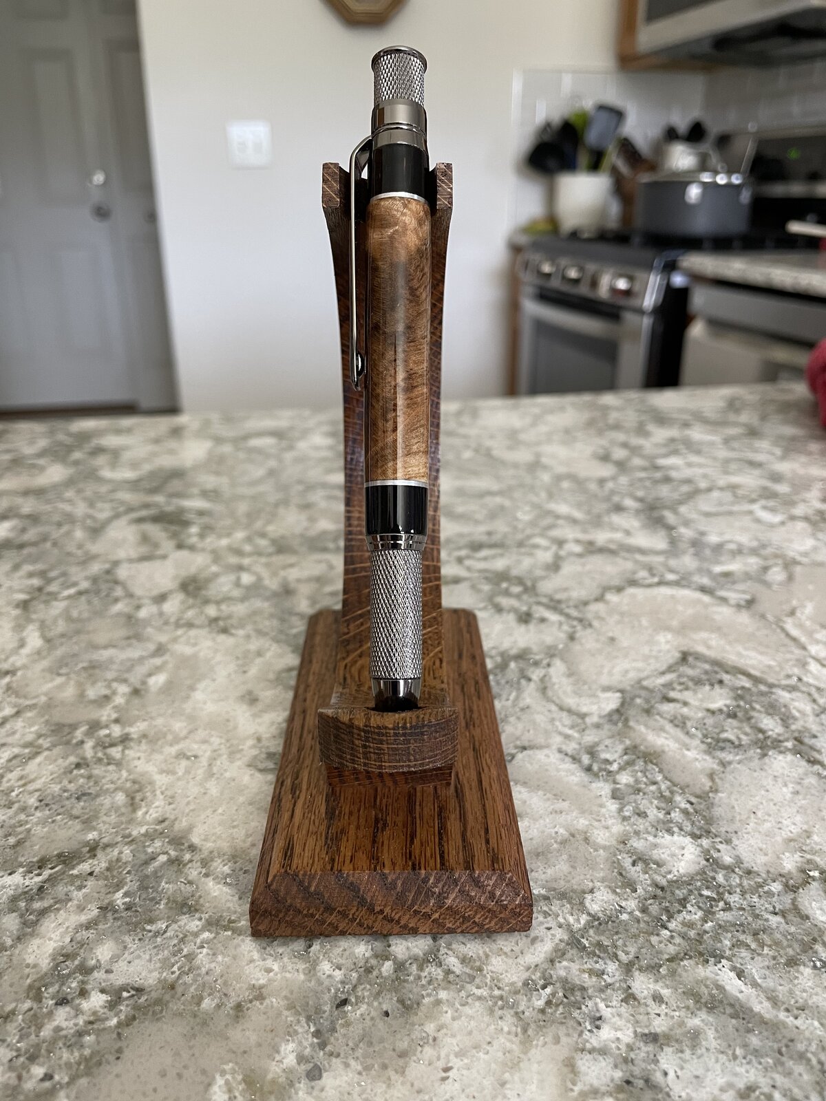

Very simple segmented Knurl GT. What's new about it? It's the first pen I've made with a blank I stabilized myself. Stabilized maple burl, Gabon ebony caps and aluminum accents.
Fantastic pen. I like the blank, and I really like the aluminum dividers with the ebony end caps.
