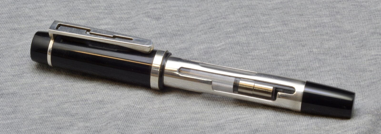

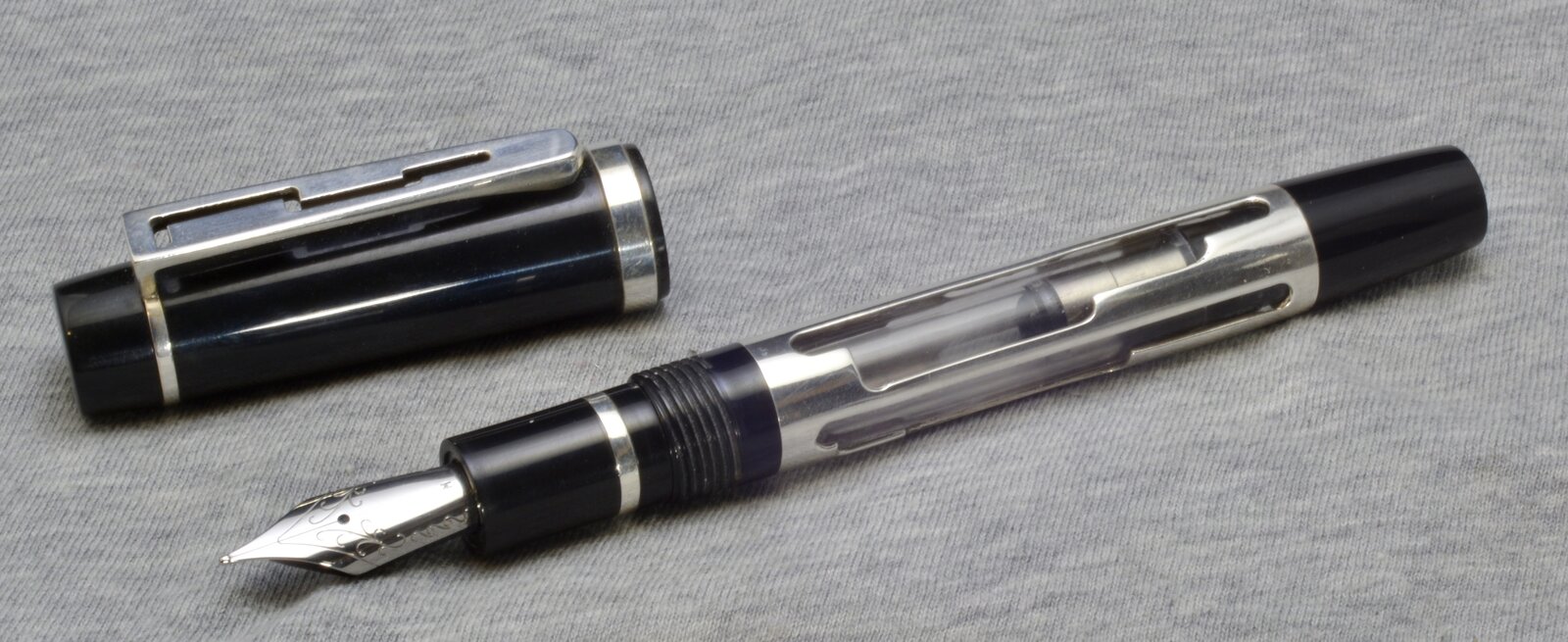

Here is a pen I finished a couple weeks ago that I finally got around to getting in the light box. It is a fountain pen with a skeletonized barrel overlay in silver, with a random linear motif. The barrel is made from transparent acrylic and black Ultem. The cap is made from black Ultem, and the cap band and clip are silver as well. OAL is around 5” from nib to end of barrel, which is about 12.5 mm at the cap threads, swelling to about 13-13.5mm in the middle of the barrel. It uses a jowo 6 nib, and can be filled via converter, or with a syringe for a cool effect of the ink being directly in the barrel.

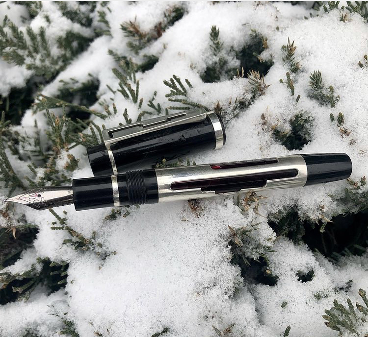

Always a joy to look at your work. Thanks for showing and please keep them coming. Well done and I absolutely love the snow and evergreen photo.

Love the snow pic ..... especially the water droplets on the cap !!!
