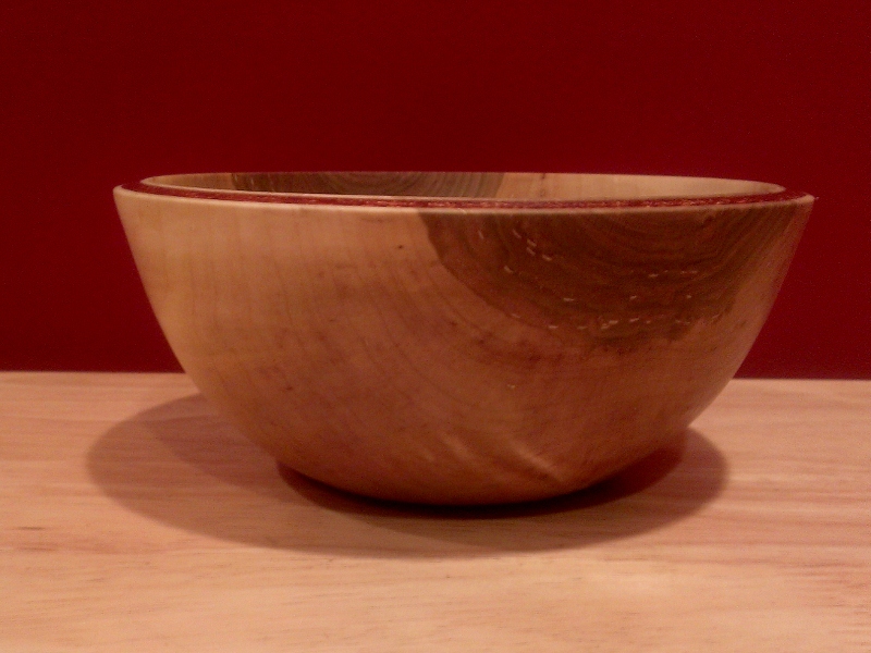

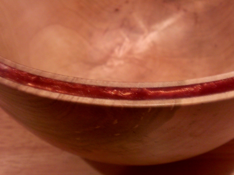

Since our local turning club has their Christmas party tonight, I needed something for the turning exchange. I wanted to try something a little different so when I was turning this Silver Maple bowl, I was going to have a little curve in the rim. It wasn't quite what I had envisioned so I decided to add a little bling to it. Basically I turned a little groove in the rim, mixed up some resin and ended up with this.
The resin turned out better than I thought. I tried to use micro mesh (like I do on my resin pens) to polish out the rim but there were just a few scratches that I couldn't get out. I pulled out my Dremel, mounted a small buffing wheel to it and polished it the rest of the way.
The bowl measures about 7" x 4" x 3/8". I want people to use my bowls so I like to leave them a little thicker. It's finished with walnut oil.
I think this turned out nice so I'm going to have to make another one to keep!
Critiques and comments welcome!
