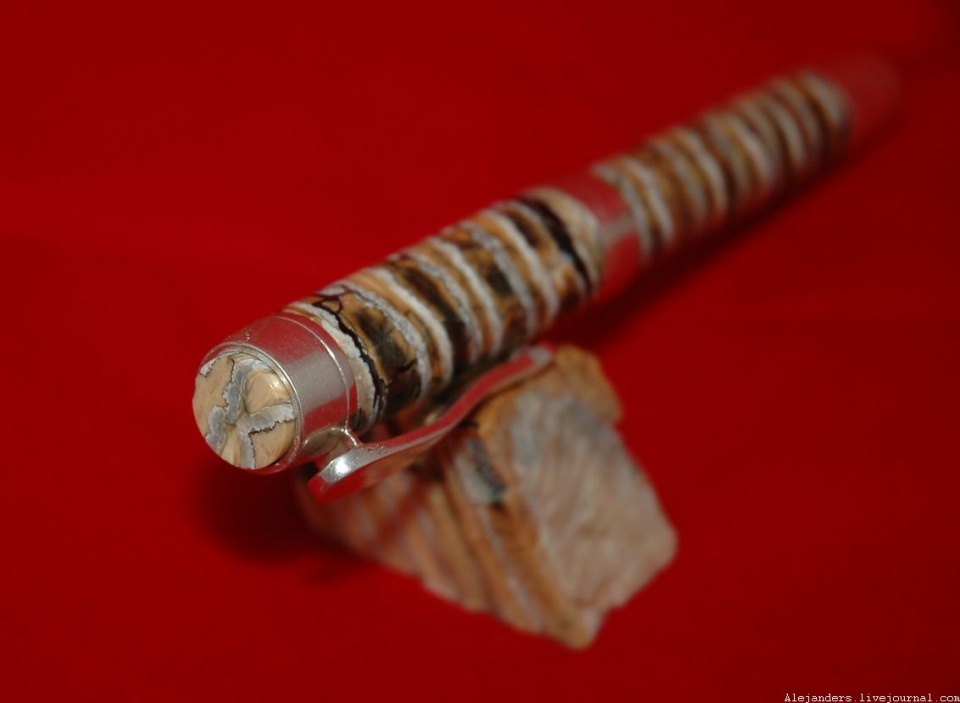

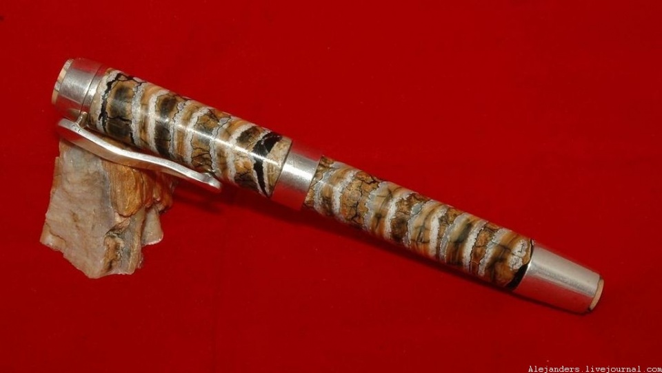

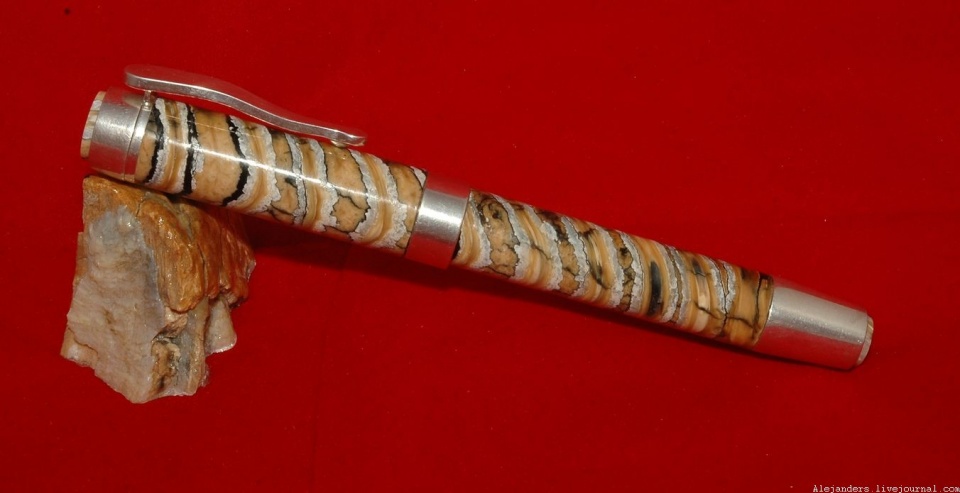

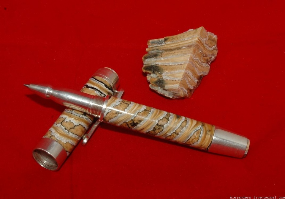

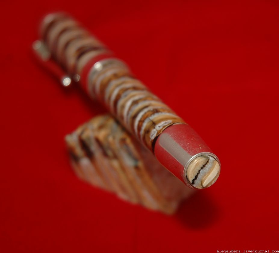

My new Best of Best. Silver and mammoth tooth.
Previous pen was made from mammoth tooth of warm yellow color.
This one made from more damaged part of tooth, with black spots, that looks fine with silver.
