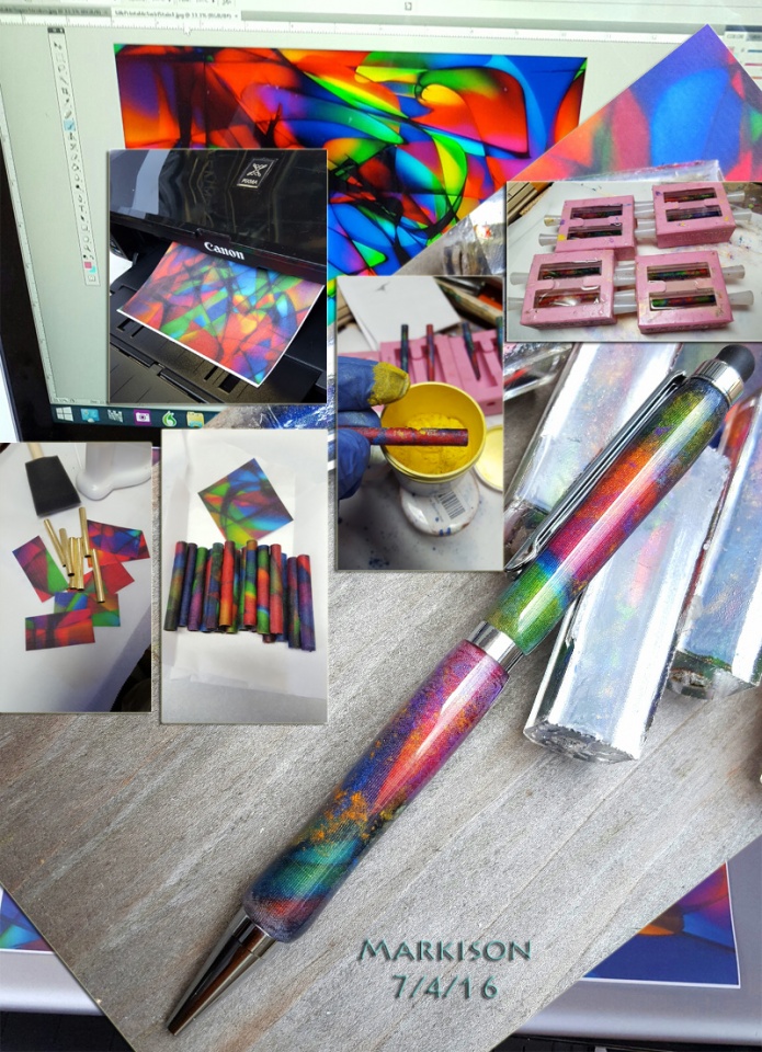

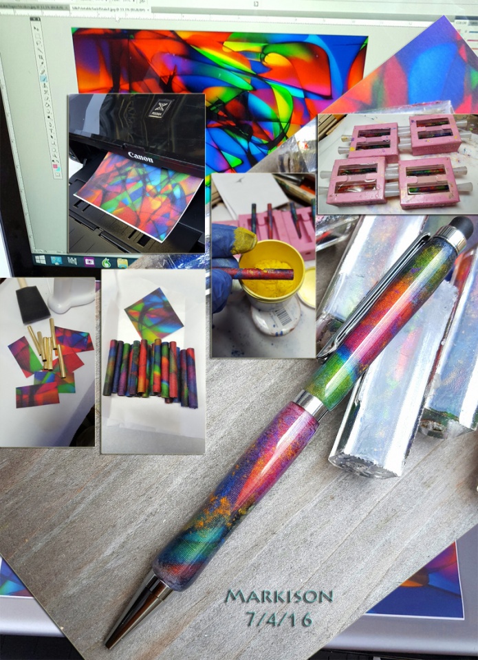

My humble offering in the spirit of invention - SilkPrint Pen(s) - steps:
Colored pencil/pastel drawing on paper, scan into Photoshop for some refinement.
Stretch 8mm Habotai silk onto a frame, coat thinly with Mod Podge and laminate onto parchment paper, let dry overnight, cut down to 8.5x11" size.
Print the image onto the silk/paper laminate (I use a fairly inexpensive Canon Pixma iX6820 inkjet printer)
Blow dry the ink (cool or warm setting)
Coat the face of the print with a thin layer of Mod Podge - let dry overnight.
Peel the silk off the parchment paper backing.
Cut silk strips to size, then glue them to 150 grit-sanded brass tubes with a thin layer of Mod Podge.
Dry the tubes overnight, then trim excess silk off the ends.
Dab on some mica powders for extra "pop".
Cast tube-in (I use Douglas and Sturgess PR)
Mill, turn, finish, and assemble as usual.
(opens up some interesting possibilities):
attachment.php
Happy 4th - have fun, be safe, and stay inventive.
- Bob
