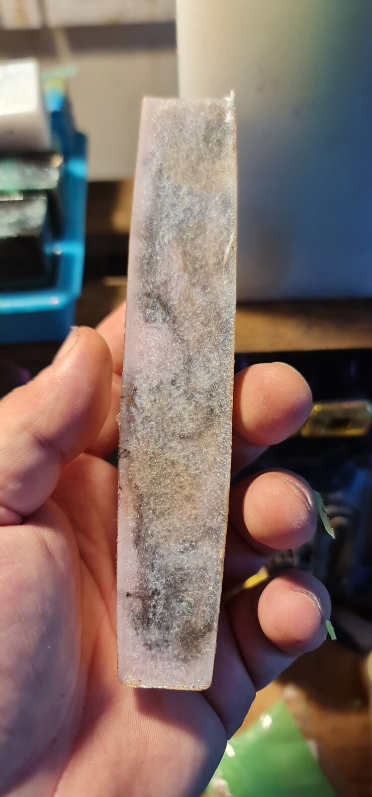

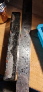

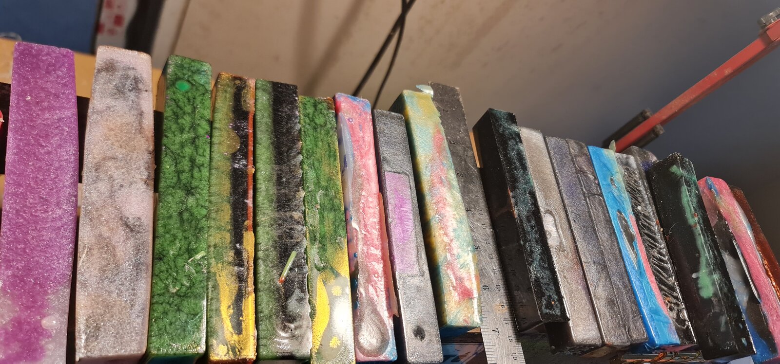

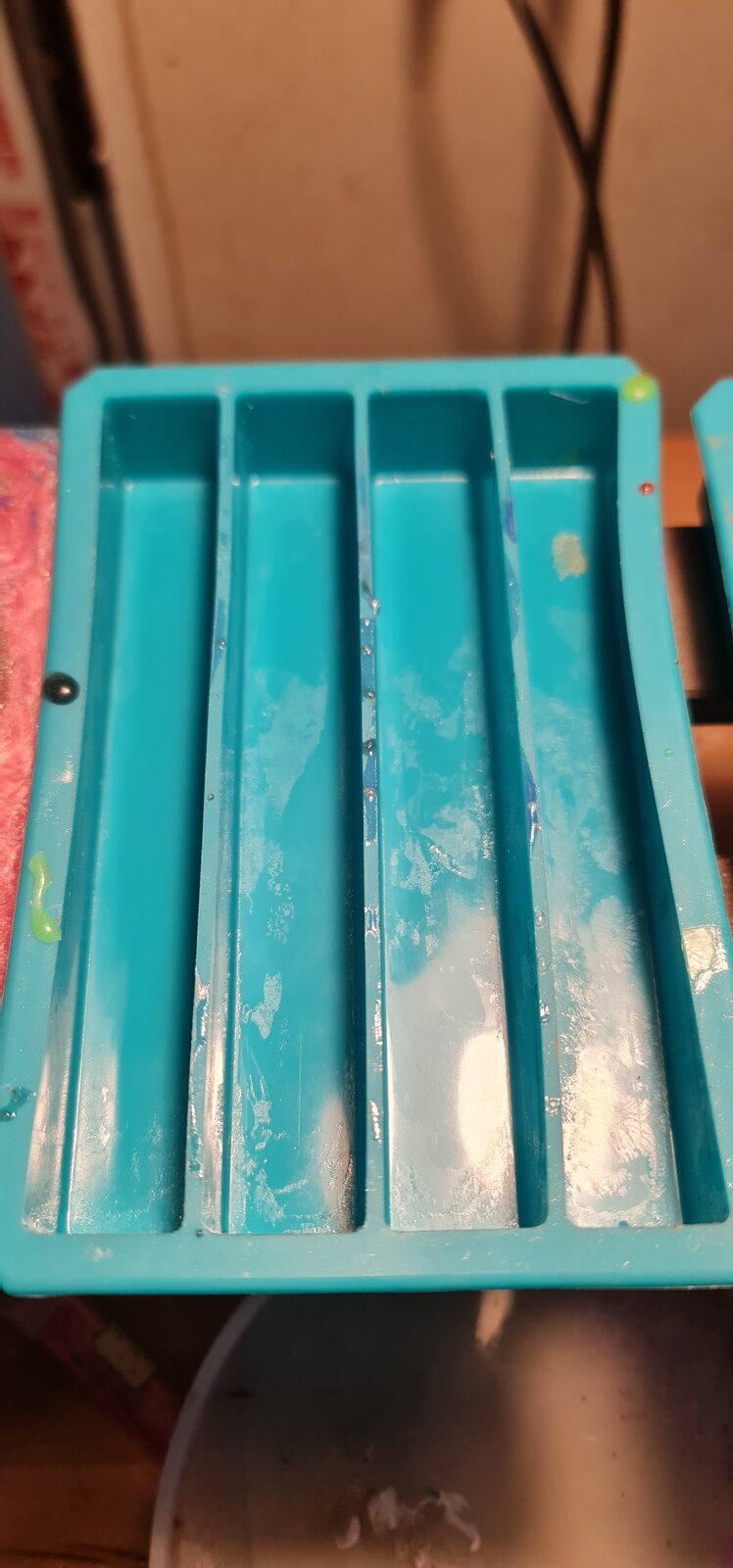

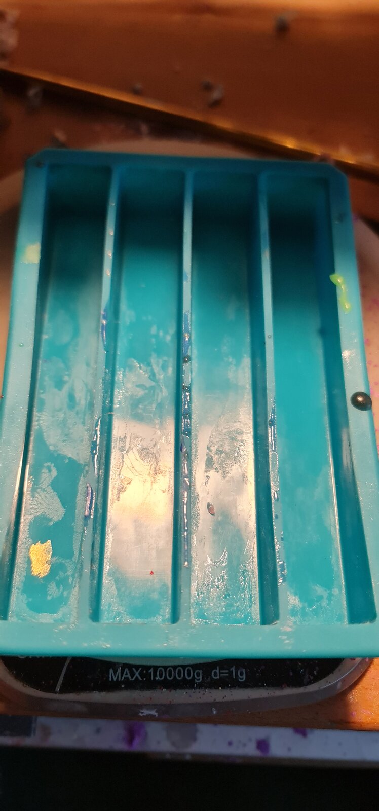

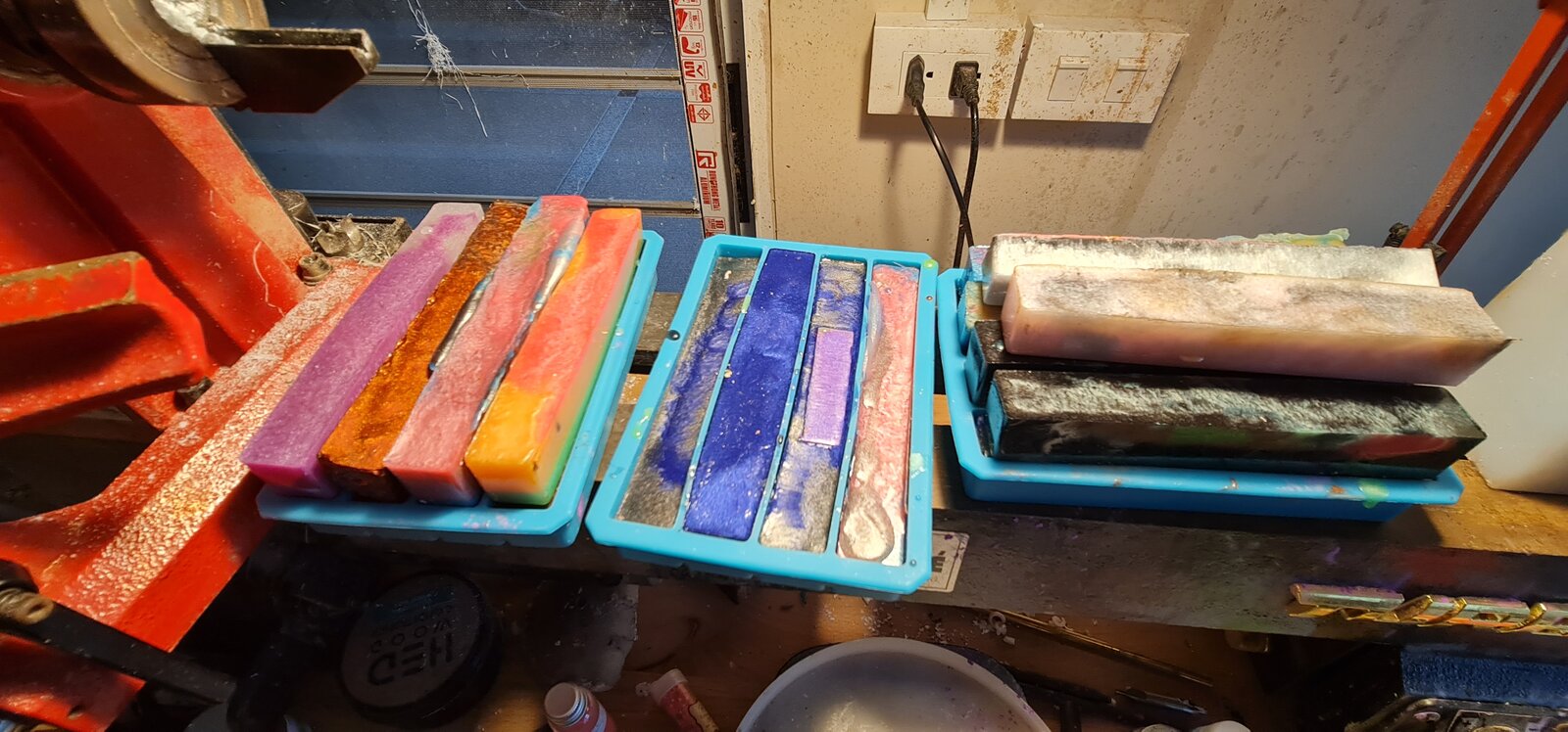

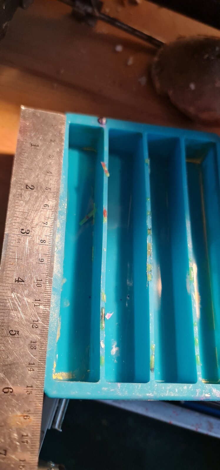

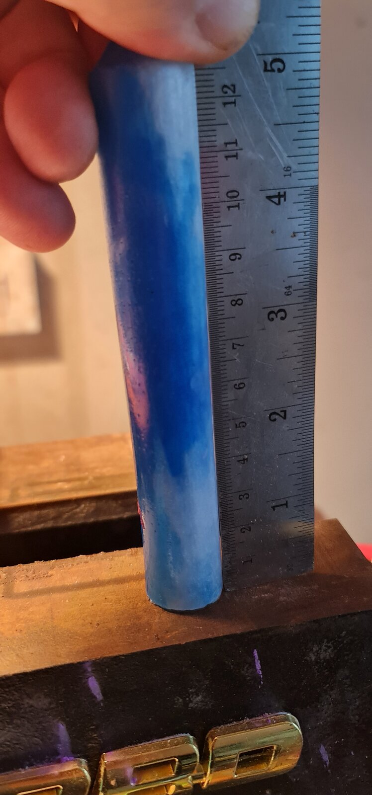

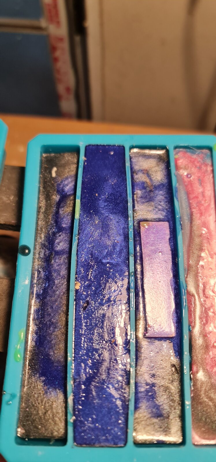

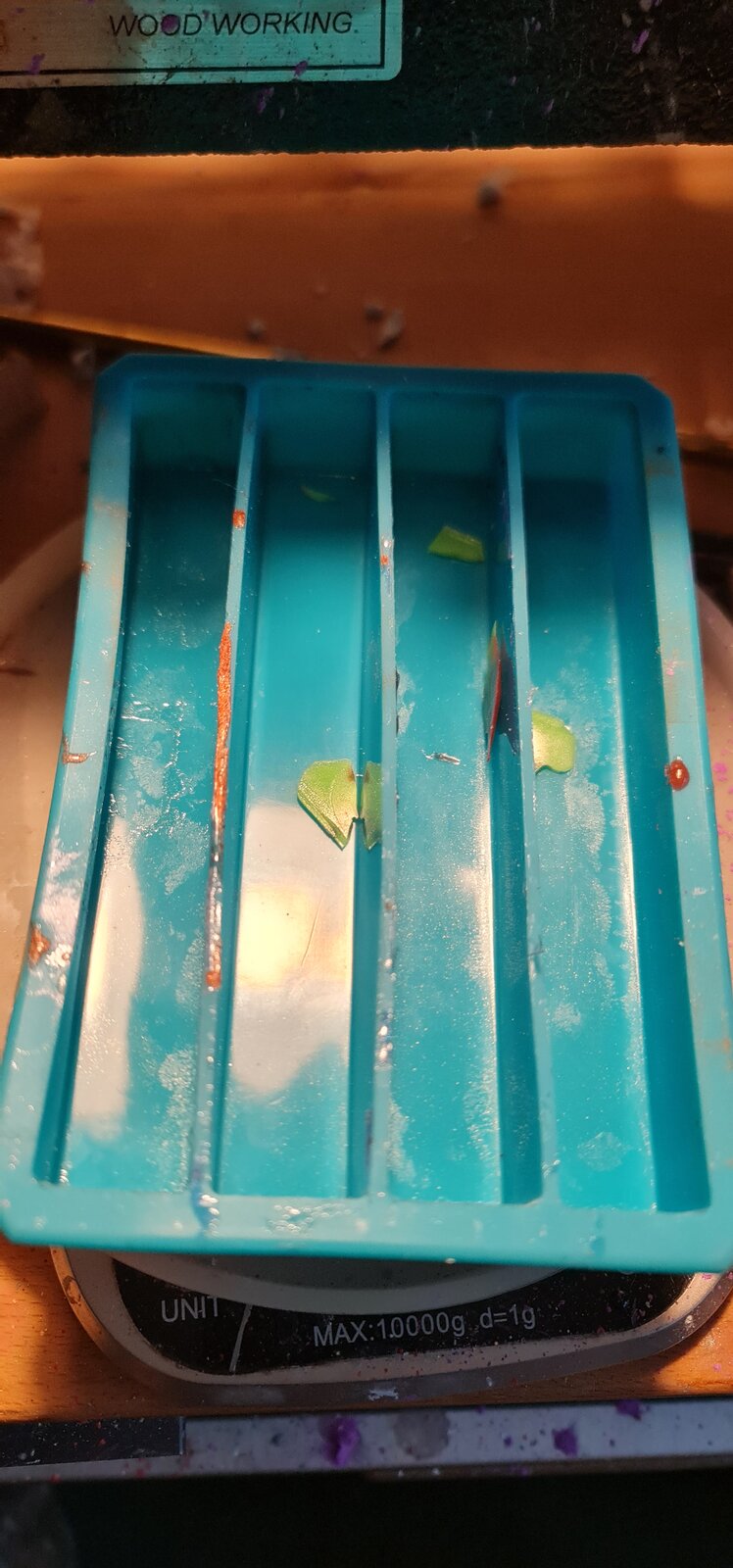

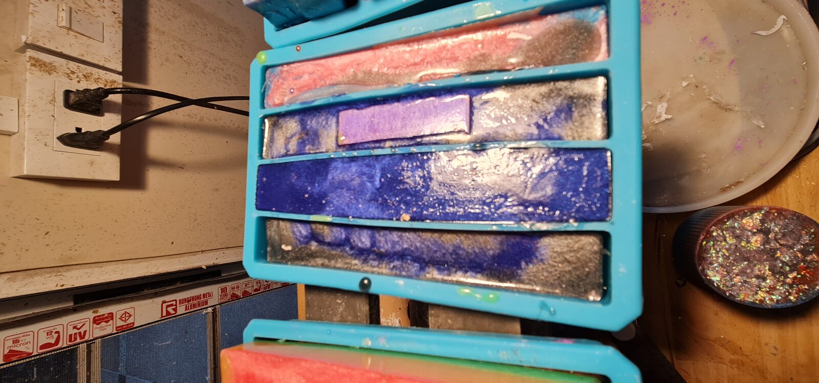

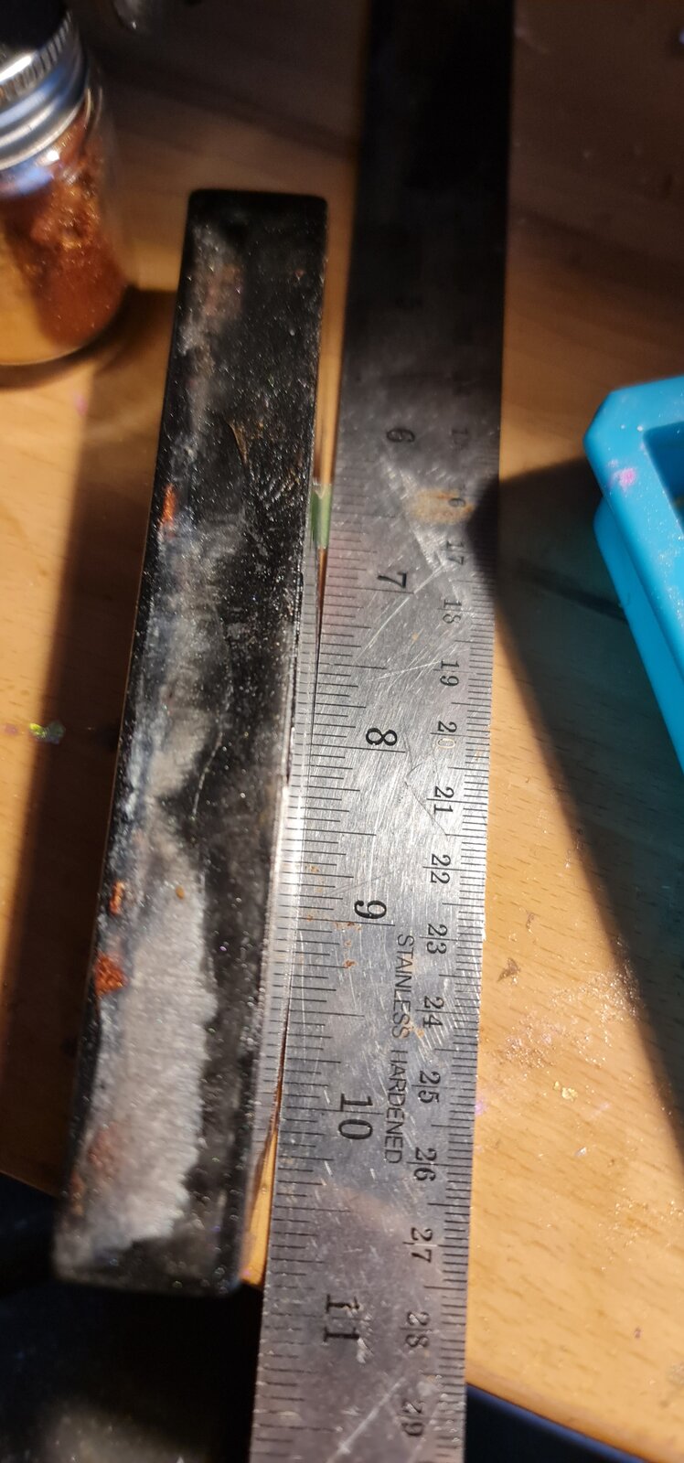

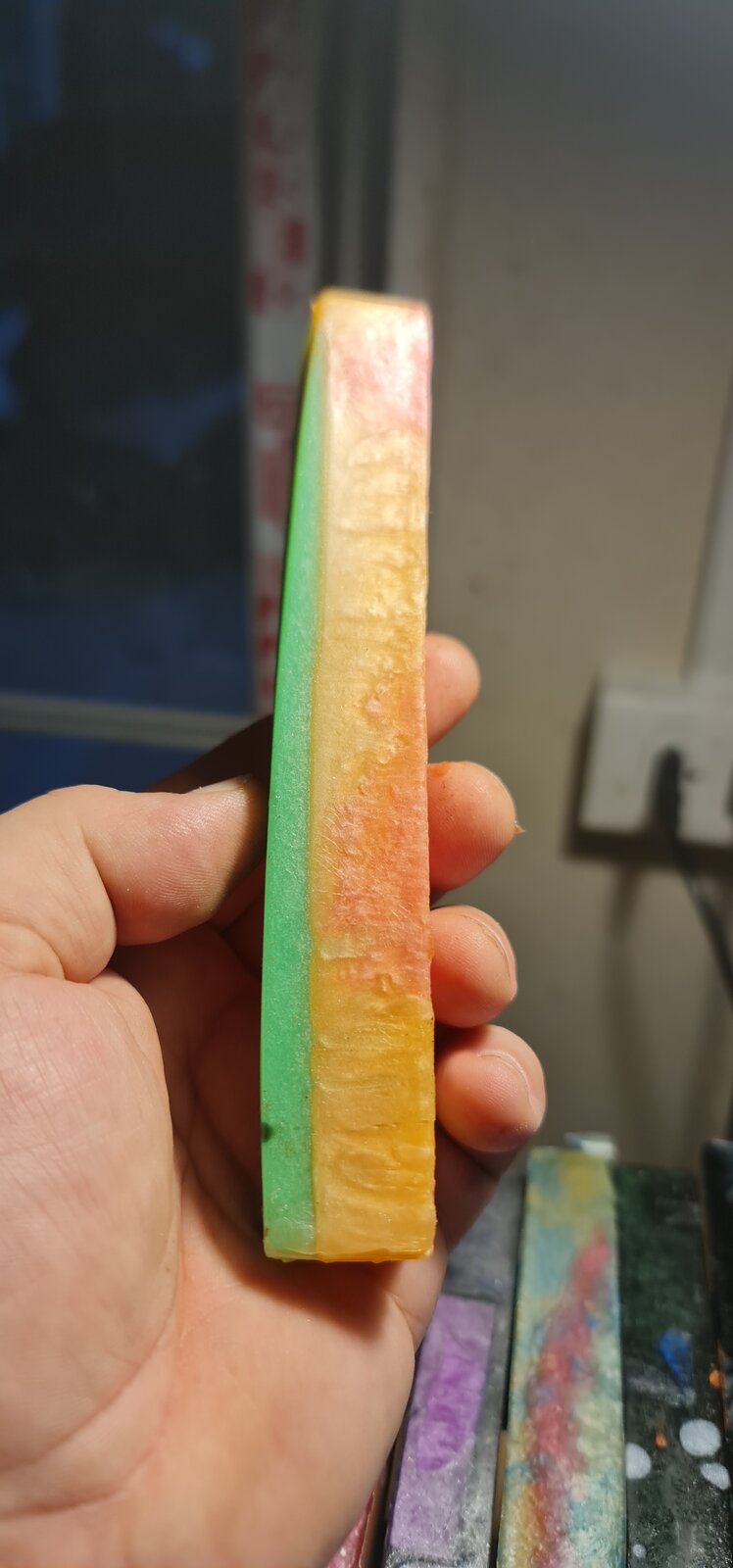

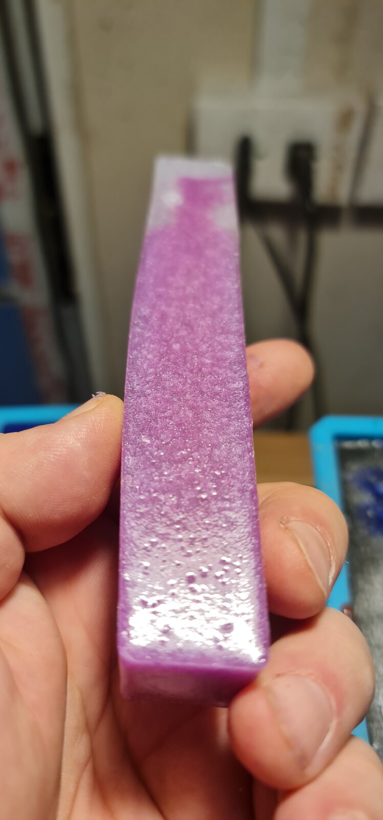

I have been using these for a while now; they work... not very well. They cost around $2USD on Aliexpress. I have attached the photo directly from the listing you should be able to image search aliexpress and find them. They have never really given me perfectly straight castings (OR ICE!) there is always some bandsaw finishing involved to get them squared up for pen jaw chuck on the lathe for drilling.
The vertical candle mold is my preferred mold now; but these little icetrays worked for a while now. I have never used any mold release spray on them, never cleaned them; been casting in them for a few years now.

In my experience these kind of blank molds do not yield a blank that is not some sort of wonky shaped…even in true blank molds. They are somewhat floppy and the sides bulge when filled with resin. Also, hard to get down into the pot without inadvertently squeezing the sides, spilling resin etc. Not a fan overall.
Yep, a lot of those cheap molds are very thin and the weight of the resin distorts their shape. Over the years I've tried molds for candles, cooking, soap and some of those China sales sites with low success. I've also used some plastic food storage containers, pencil boxes, and butter dishes that work but nothing has conserved the resin, held up for repeated use or given me the correct size like a mold built specifically for pen blanks.

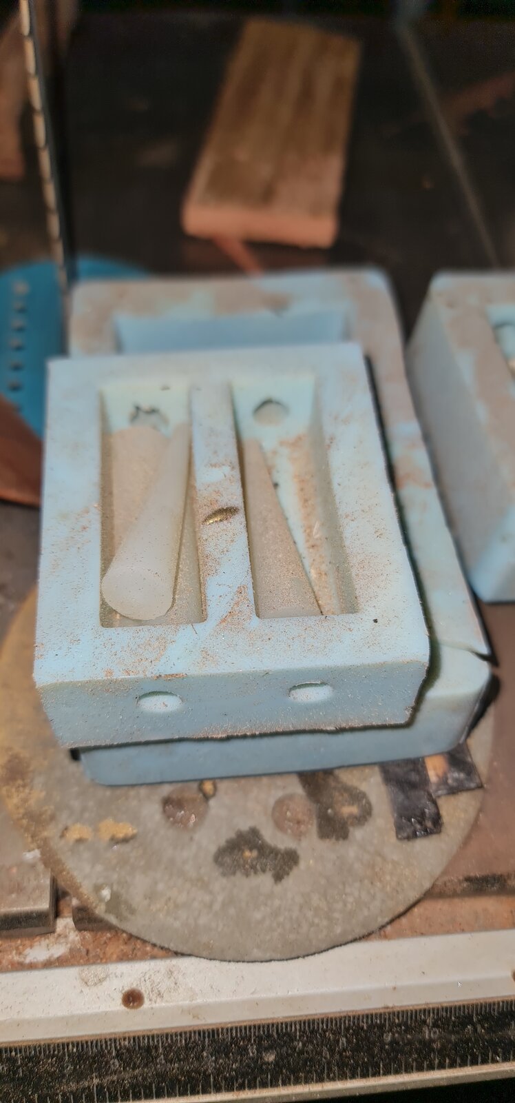

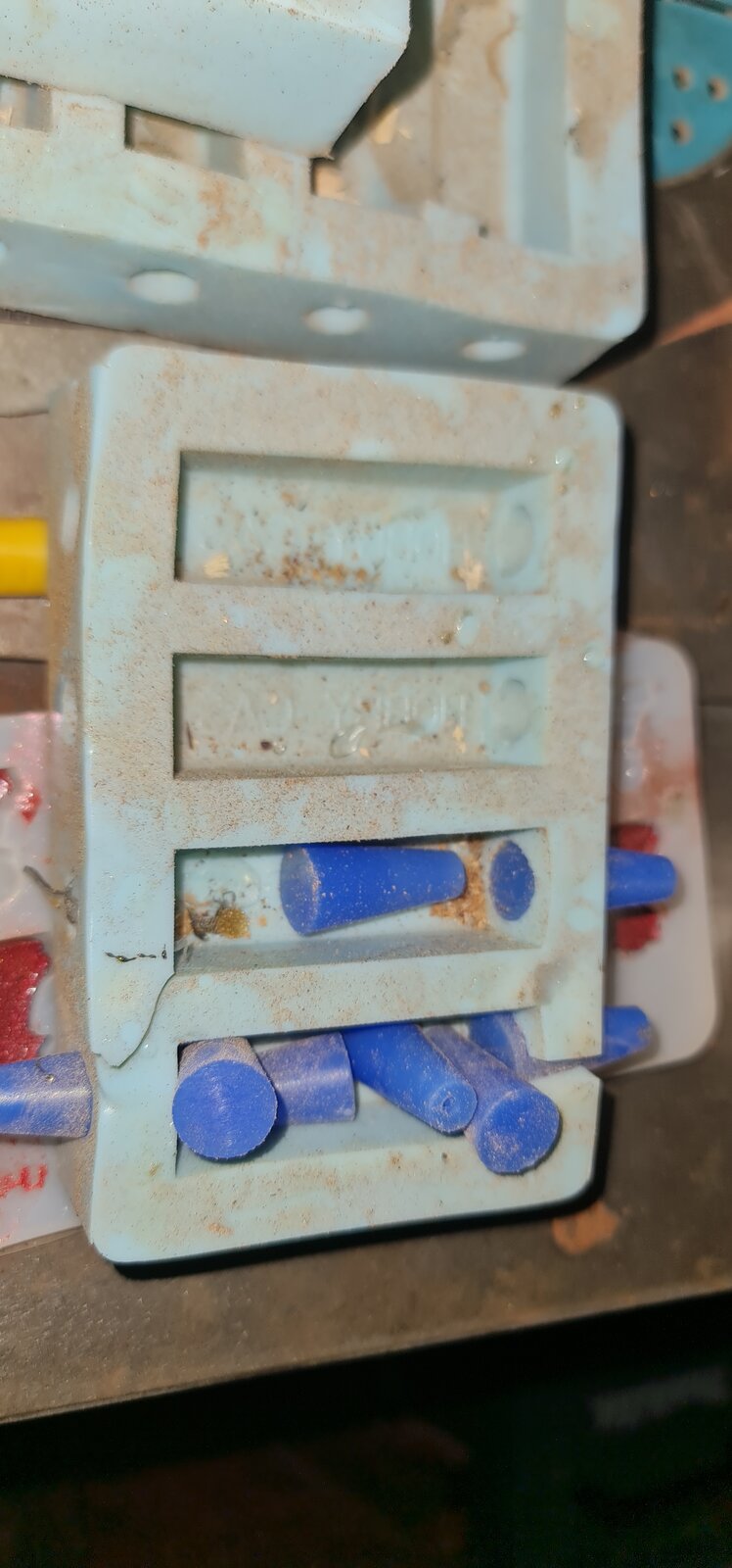

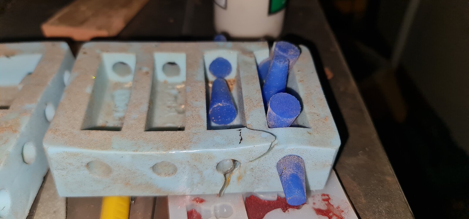

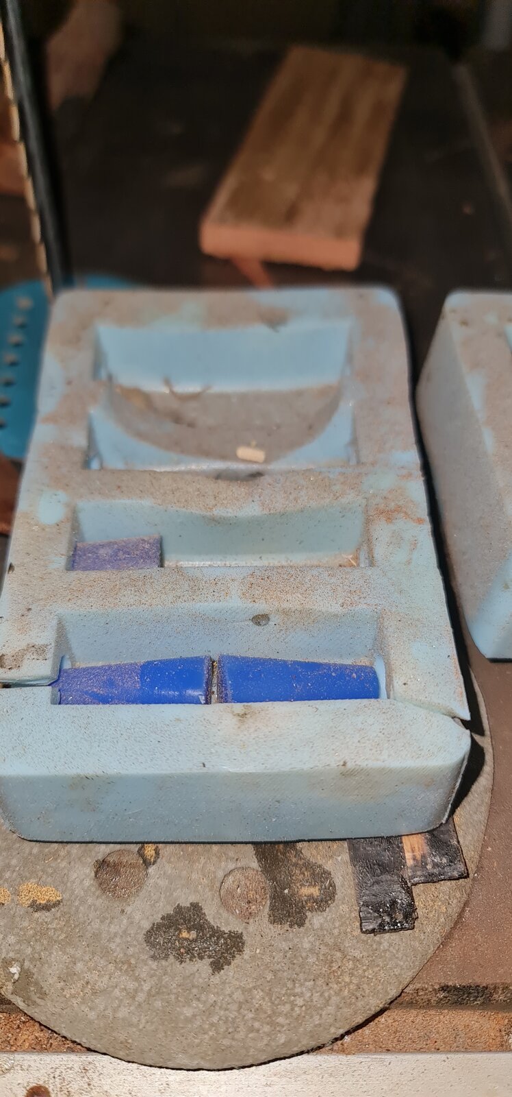

I have bought the molds from America: they were terrible; they were dry rotted on arrival and ripped while trying to load them. They were extremely expensive as well. They all came highly recommended. They ripped apart I put them on the shelf over a year ago.

Yes, Those look to be the early version of molds sold in the pen making community. I had a few that tore also. I had to use some silicone caulk in the tear to "glue them" back together. Silicon has evolved since then. There are much better products being made from pen turner companies with more dense and sturdy silicone.

I'm aware that they are from a mold maker in the community, and that really sucks because there are better silicones out there to use, with more flexibility, stronger tear strengths, and temperature resistance. I've had people tell me they avoid buying high price silicone molds because they are too expensive but it's because the quality material to make them cost more and they hold up. I've made many molds over the years for myself with various materials. I've learned that silicone is not all the same. To use that word is like using the word resin. Some just use better silicone suited for the job while others either don't understand the differences or try to save a buck. Sorry to hear you had the issues you did.

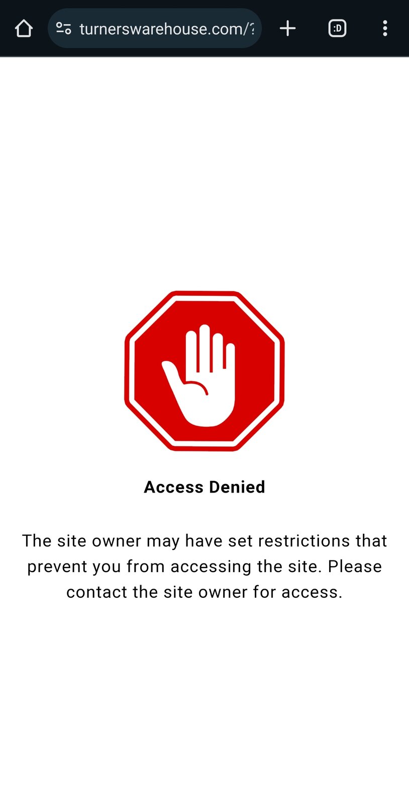

It is impossible for anyone to make a 6-hole vertical mold for $5.50USD. No one can make these ice tray molds for $1.20USD. The ice tray molds require some finishing work on the bandsaw. I am blocked from seeing the website now; but last I saw the vertical molds were >$120USD from turner warehouse.
